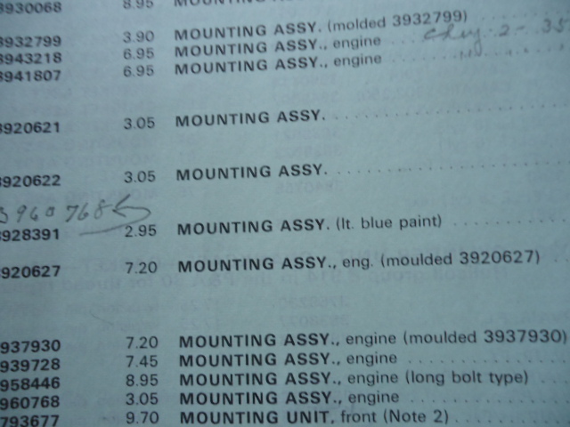

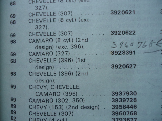

If it helps,I've got an original 1960-1969 seven inch thick Master Parts counter catalog,dated July 1st,1969,so that means it shows the most current #'s up to that latest date.
Here's what it shows for both of those mounts:

Now...that makes perfect sense....thanks for the information!
