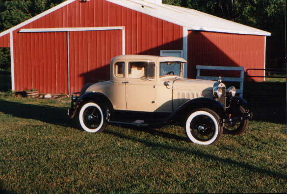

I had that two houses ago.
It was wonderful.
Front barn was a 30'x50' former horse barn, with stalls and such.
The back barn was the finished off "race shop" (20'x40').
