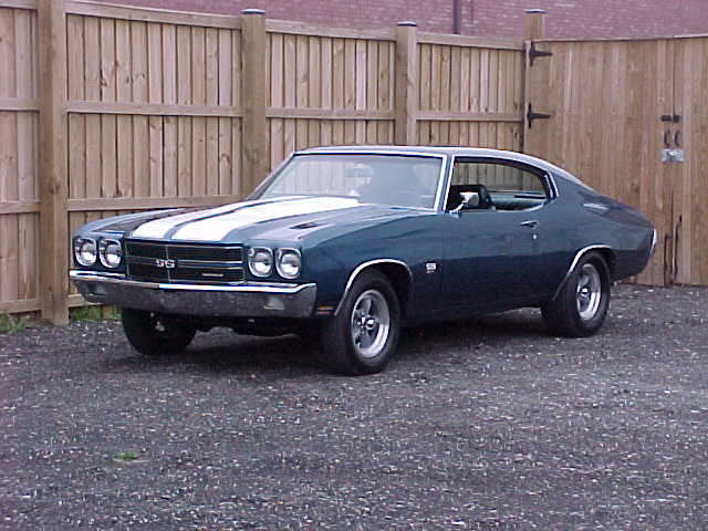

Here's my old Chevelle .I had 15x8.5 with 28x10.5 Mickey Thompson sportman pros but it rubbed.I reordered some 15x7 and the fit under the wheelwells.

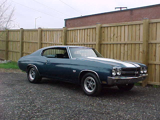

Here's another pic with the 15x7.
