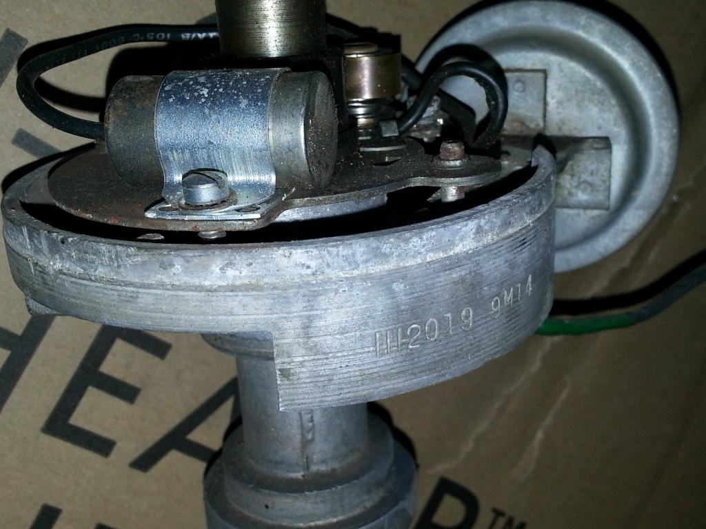

Here's another data point on this. Exact same date and the same fonts as the first one. I'm thinking it legit.

Not to hijack, and I’m no expert either, but that 1111498 looks like the “9” started life as a “3”.

The real 9 should have a distinct radius on top and bottom where the round meets the tail.
Uh, no... And the 9s are one of the reasons I don't like the OPs. Might be the angle of the pic though.

Dave, is this for your car? I'm no expert on stamping S so I will let the experts decide. The date seems early for an 04B car. My 04D Van Nuys car has an 0C18 distributor.

It may be a bit early for an 04B. Not sure what the cutoff would be. There was a guy with a 69 04B that had an original dizzy that he said was a December date. Since production didn't get rolling on the 70's until January there may be a bit of latitude there. My original starter is a January build.
An 0C18 would be ideal.

It is my opinion that the 019 has been restamped.

Apology for answering hijack, but...From a long time observer of “499” distributors, I have noticed this type “9” that you speak about. If you look, say on eBay, at “499” authentic dizzys, the 9 looks the same as this “498”

This distributor has the same characteristics for the NUMBER 2... short tail and seems like an abbreviated edge on the curve in the 2 as well.

Well right or wrong its mine now. I won the auction at 560. One other bidder. No time for buyers remorse. I actually thought it would go higher.
It was the last part on my list. Thanks for everyone who participated with comments.
