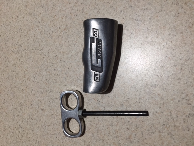

This is all I have left of mine... sent it back years ago for a rebuild and they threw it out and replaced it with a Hurst. That trigger didn’t fit my fingers very well, painful on the street.

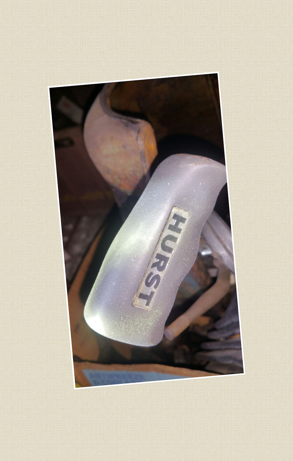

I thought there was an early and late design of the Hurst Shifter. The earlier one had a chrome, flatter reverse stick. May have even had a different name.
This is a terrible pic, but neat, sparkle decal tee handle was original to this shifter I was told. Don't see many of them.
