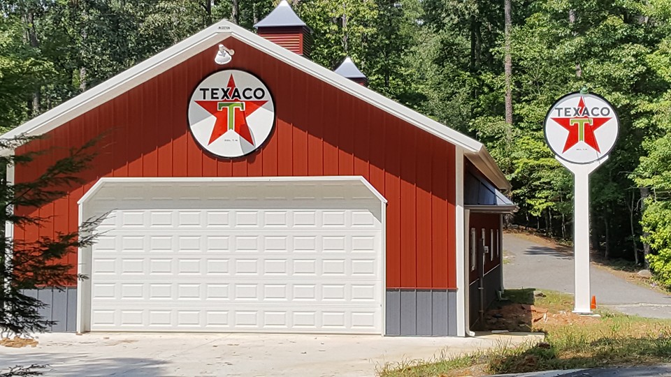

I used Morton. Very high quality. They used screws. I was very happy with the work and materiel. I found them about 10% higher than other builders i quoted but went with Morton because of the reputation and warranty. I just had the shell built. 8 foot centers. I did the interior, electrical, insulation myself.

Beautiful building.

What size is that and how many cars can you get in it?
