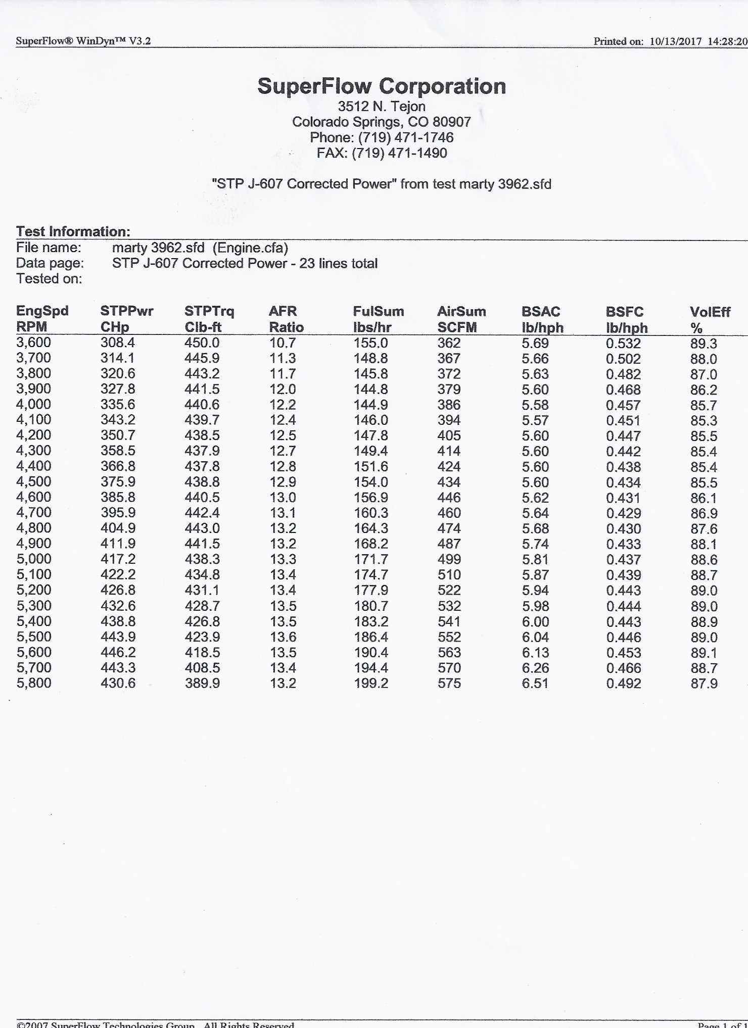

Yikes! Thanks for all of the input. We were able to coax a few more HP after re-jetting. Then we put the shop carb on and it woke up! 446 hp at 5700.

Impressive numbers from the "baby rat'...especially some of the torque figures. So, this begs the question...'if the L78 makes those numbers...what does it's big brother, the L72 really make? I would assume well north of 450hp...

That is a very impressive torque curve from a stock L78 IMO.

Sounds about right.
I installed a 3910 on my 496 for the initial dyno tests and the engine picked up somewhere around 20 when I swapped to a 3418 (`67 L88 855 vacuum secondary). During the last series of tests, the engine picked up another 30+ when I replaced the L88 carb with a 4781 850 double pumper, and another 20 when I switched to a 1000 HP (I built & calibrated myself). That's over 60 HP just in the carbs.
The factory carbs are good, but they do leave room for improvement. Comparing them to a newer "race" type carb really is an apples to oranges comparison.
