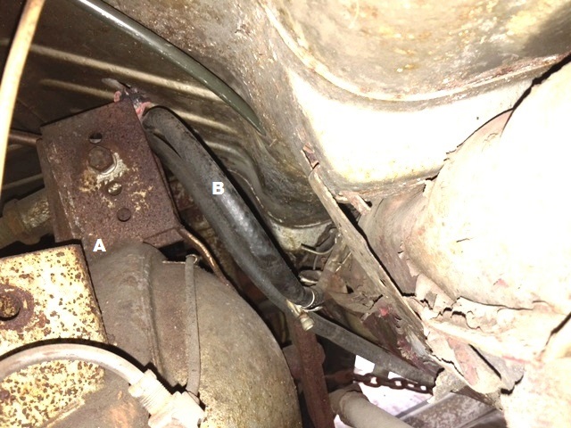

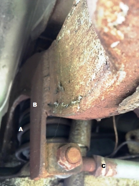

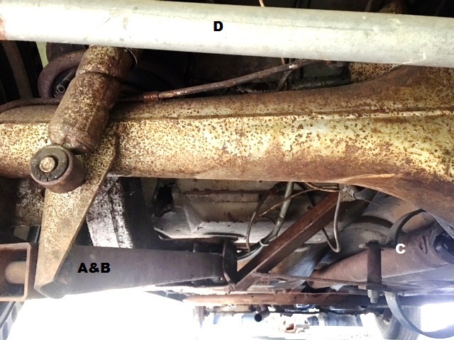

picture1) Ball joint extensions. Pic2) A-relocated fuel line, now, 1/2 in. B-drain cock front edge of tank, C-driveshaft loop,D-Watts link on rear of 3rd member pumpkin. Pic3) A&B-boxed trailing arms w/ steel bushings. C-watts link LH arm. Pic4) A-Airlift bag, B-Watts link mount on sectioned frame. Pic5) A-looking inline with axle tube, top of pumpkin, pinion angle turnbuckle B-hoses to trunk mounted Bendix fuel pumps. Below clamp is Watts link pivot on pumpkin and partial view of rod.

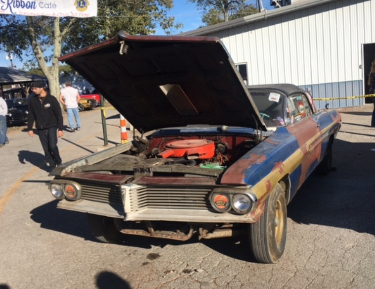

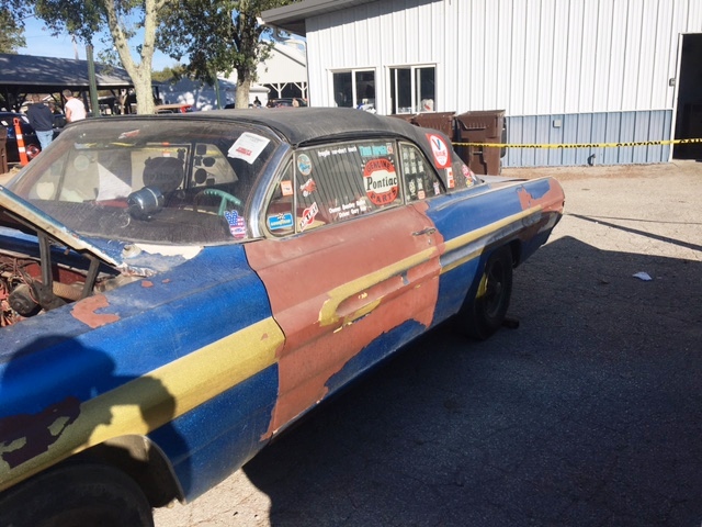

Car debuted at its 1st show, the Pumpkin Run (Owensville, Ohio) Sept 29,30,Oct 1.
