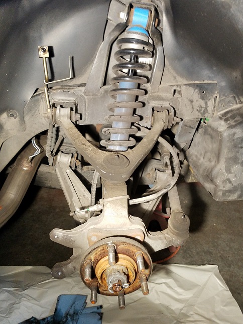

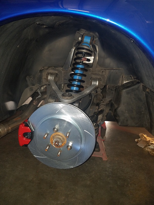

In continuing my quest for the perfect Viper....well...not really, but since it's Hurricaning out there, I might as well update a few threads!

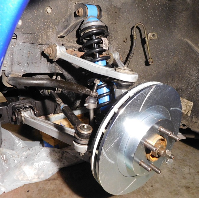

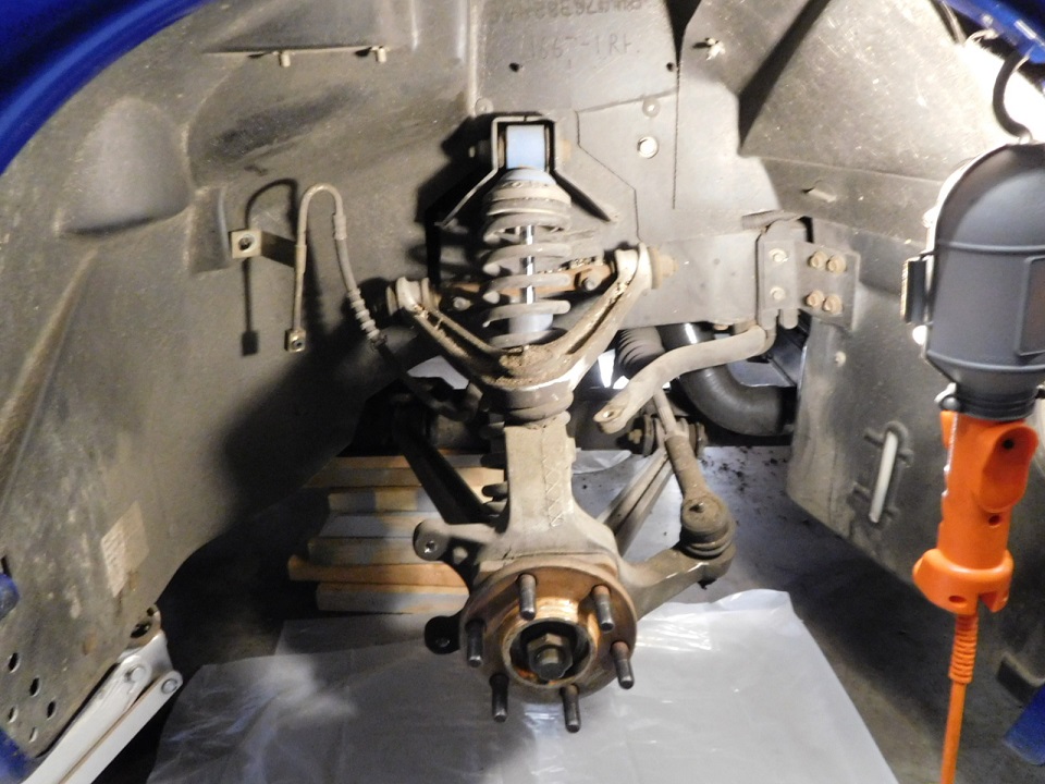

Up on jack stands it goes for a brake redo and a cleaning up of the front and rear suspension is in order as well. Of course, factory markings present as well as parts tags will remain. The last worn out parts to replace are the sway bar end links front and back too. Brakes on the Gen II Vipers are...well....not exactly up to today's standards on the Gen Vs or even the later Gen IIIs. After exploring a bunch of options and realizing this thing will never see a track day (OK, maybe one day for fun), I decided that slotted rotors with Hawk pads would be just fine. Of course, what's a B&W GTS need to really look good!? Simple....shiney red calipers which always make the car go faster!
Look at how puny those back calipers are! Like leftover Neon calipers. I'm going to make a cover eventually to go over that (Tom at Tom's Big Brakes used to, but they no longer exist) just for asthetic purposes so I can have a Viper logo on the rear ones too. Just a brake bleed away from being back on the road! Well, that and a week of no rain!

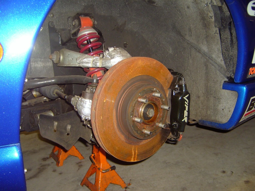

The brakes worked really well when we raced ours, back in the day. Sebring was our home track and it was quite fun going from 145 mph on the short straight into the 20 mph hair pin turn (which has since been removed and made into a much more gentler transition without a runoff escape route that pointed you directly into a large billboard or a chain link fence. :-)
From my racing experience with the Gen 1 suspension in my 93 I found that it was well balanced in the braking department. I think the best 60 to 0 braking distance we measured was 105 feet, running on the first design BFG R-1 racing tires. No fading, though it would boil the brake fluid frequently on long runs and I had to go with a really expensive high temp fluid and added Porsche brake duct flaps attached to the lower control arms to direct the air toward the calipers.
You may find that if you enlarge the rear brakes you may also have to go to bigger front brakes as well as the braking balance may be upset.
Here's a shot of the Porsche brake flaps hose clamped to the lower control arms. (please ignore the rusty rotors from sitting). We also had to wrap the ball joints and tie rod ends in heat barrier material as the brake rotor heat would boil the grease right out of the ball joints...right toward the brake rotors. Now THAT made for an exciting time. You can also see on the bottom of the caliper where I added some orange RTV in a glob as a cushion to prevent that transfer tube from getting dented during wheel changes. The car also had a set of custom coil-over shocks that Koni made for us with adjustable spring seats for altering the ride height.

Brakes are done and what an improvement! The car runs cool due to the radiator recore and addtional fans....not to mention it's not 1,000 Degrees outside!!!
