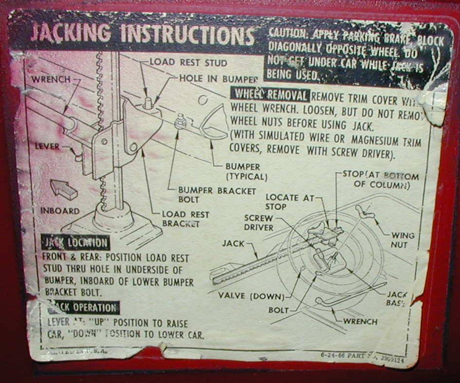

Kurt,
Do you have a picture of the instructions with that info? Thanks. Phil |

<div class="ubbcode-block"><div class="ubbcode-header">Originally Posted By: Woj</div><div class="ubbcode-body">Kurt,
Do you have a picture of the instructions with that info? </div></div>
Kurt S - CRG |
