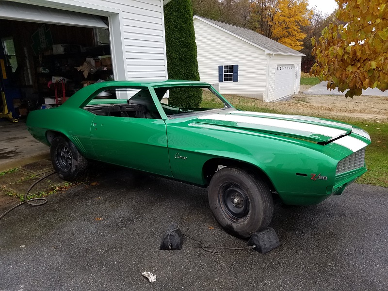

Here is a picture of mine, the older brother 03D build. No spoiler and flat hood
