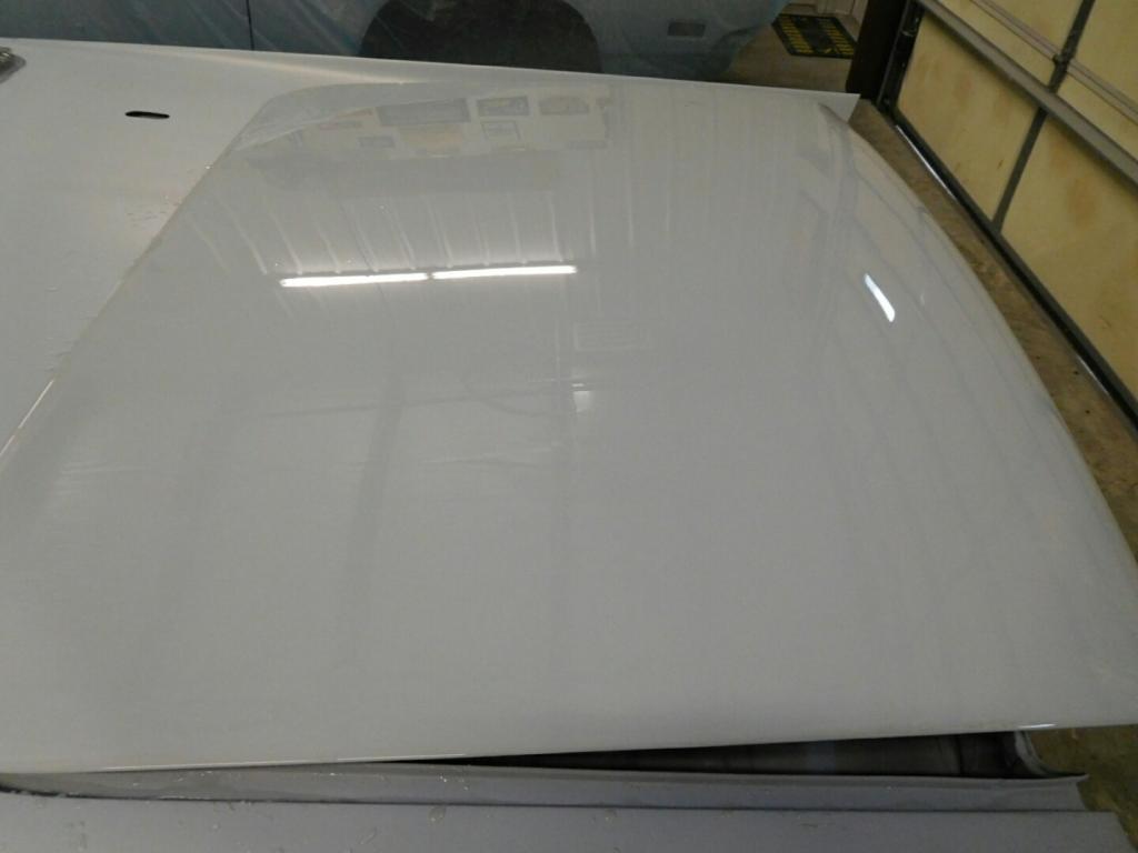

So in spent the morning serenading with 400. Found a few small places i need to touch up, but other than that I think I'm about ready for paint later this week! Here's some after I unwrapped it and pulled it out into the sun, er, clouds, for a closer look

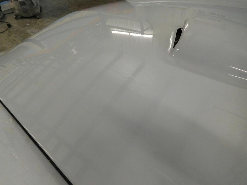

And during the wetsanding. After each panel I layed on the water to see the reflection from the girders on the ceiling in my shop. I figured they would tell me if I was way off on blocking out a panel. Here's a few of the trunk, hood, and a door which took a lot of blocking to get flat. I think I'm ready! I'm glad you all enjoy my posts. I'm famous in my own way! &quot;Who's that guy on the forum...&quot; &quot;You mean the guy that does the good work?&quot; &quot;No, the goofball with the crazy posts...&quot;. &quot;Oh, that guy, some dude who likes Dodges or something [img]<<GRAEMLIN_URL>>/rolleyes.gif[/img]

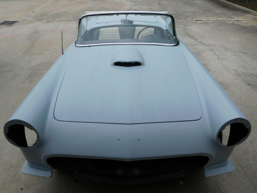

Is this the look the owner is going for?

That's the look, Mark. Funny you post that pic since that's what I showed him. But he really likes the Tropical Turquoise color,so that's what is going to be unless something changes between today and tomorrow when I buy the paint. More soon!

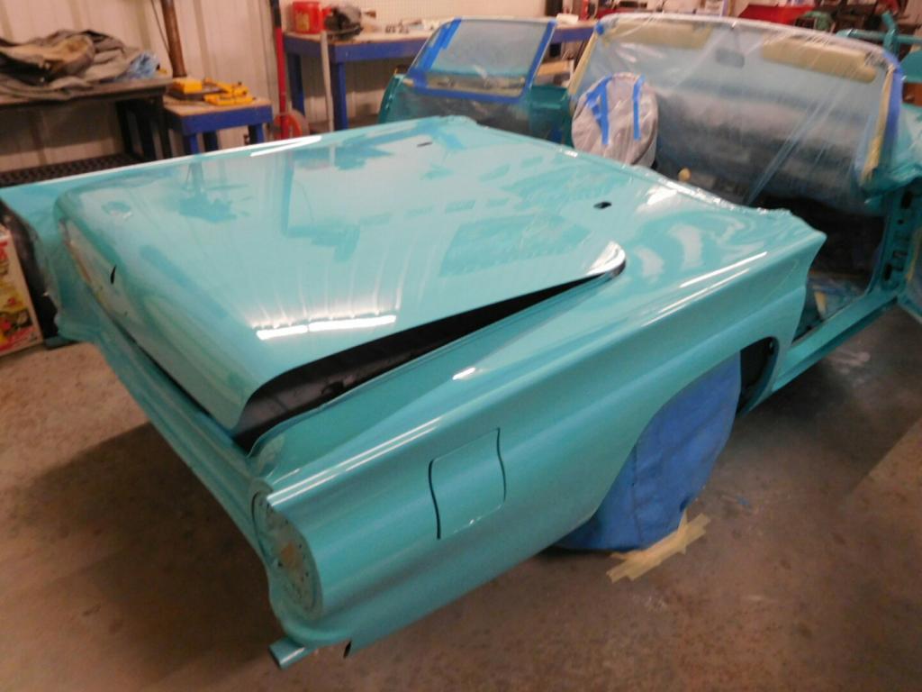

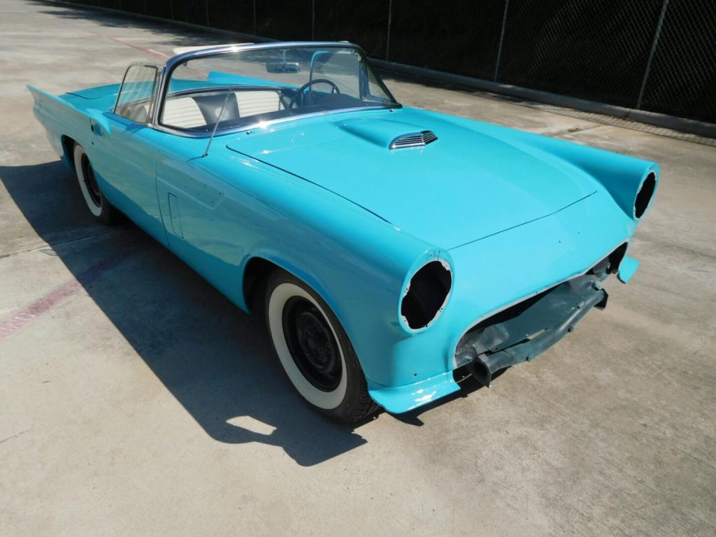

So, Wednesday was the day! Temperature was right, humidity was down, Venus was moving towards Aquarius....everything lined up for a night of unbridled paintification!
Cheers
  #19
Old 09-02-2016, 10:37 PM
A12pilot's Avatar
A12pilot A12pilot is offline
Yenko Advertising Member
Join Date: Nov 2014
Location: DFW
Posts: 2,813
Thanked 5,349 Times in 1,240 Posts
Default Re: Birds and Bees: Operation Phoenix - 1957 T-Bird

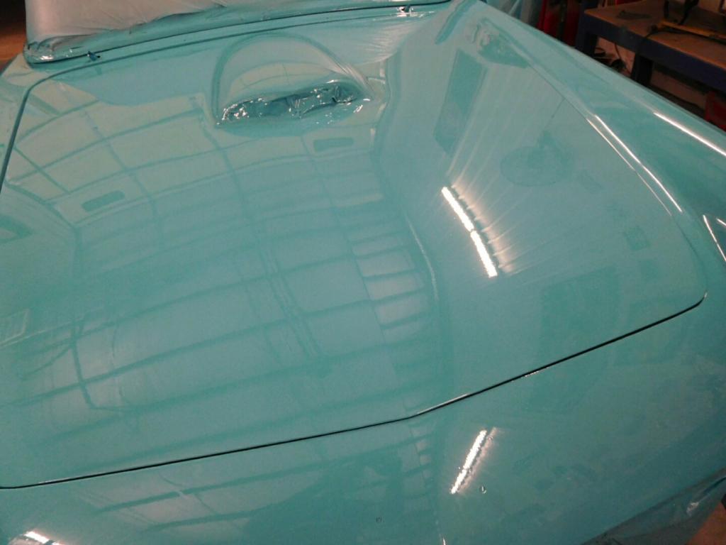

Pulled it out into the sun. Only a few days to sand out. Overall, I'm happy with it!
Let the wet sanding begin!!

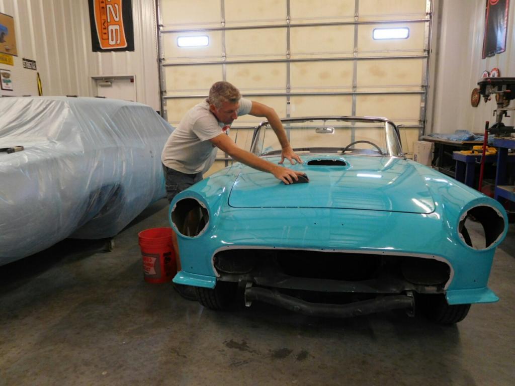

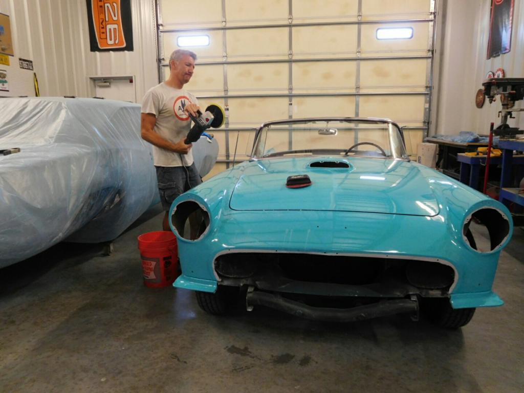

So here we are..... Starting with 1000 and increasing up to 4000.
This was getting me nowhere, so I thought....hmmm.... What if I increased the sanding area? That would cut the sanding down!
So out came the polisher and i taped on six disks which created a 1sq ft. Surface area of sanding material! What could go wrong?
..... And here's the car after the second repaint. [img]<<GRAEMLIN_URL>>/frown.gif[/img] [img]<<GRAEMLIN_URL>>/hmmm.gif[/img] [img]<<GRAEMLIN_URL>>/crazy.gif[/img]
Polishing up next!
