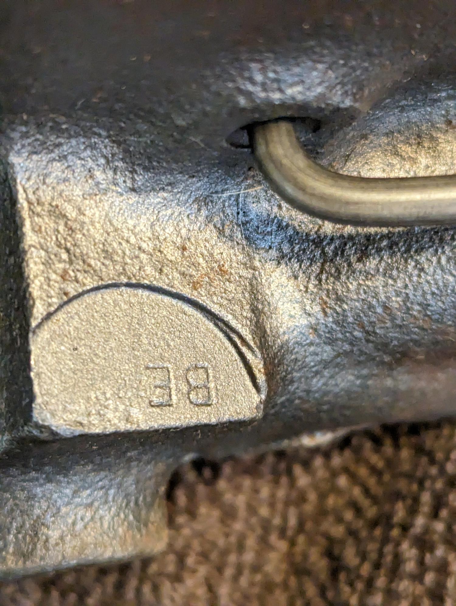

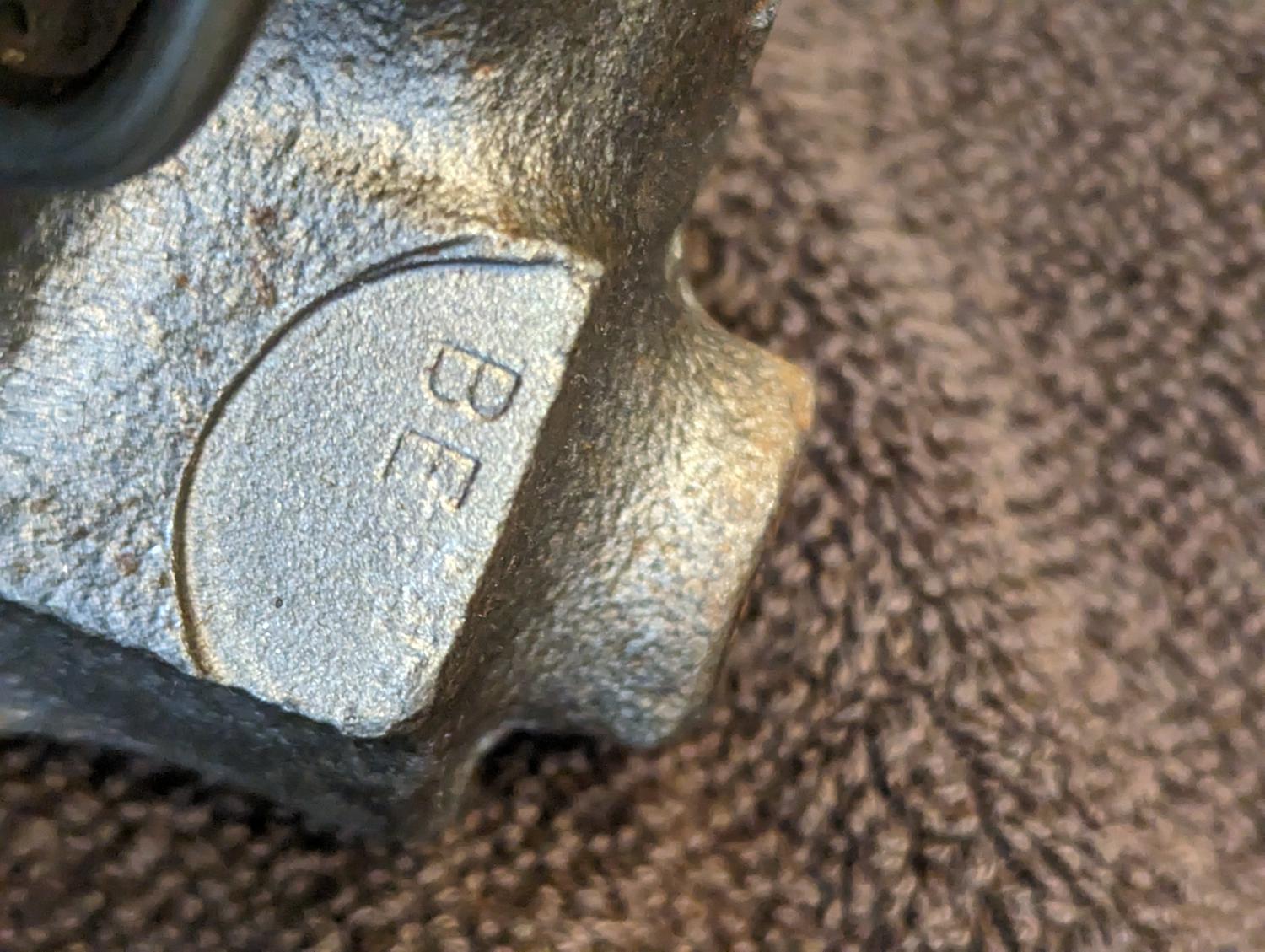

Seeking info on 409 MC stamped "CF"

Looks like Chris W answered my question in post #2......I have a "409" BE master cylinder and bought it in 2004 wanting a 70' Camaro "409" EB
