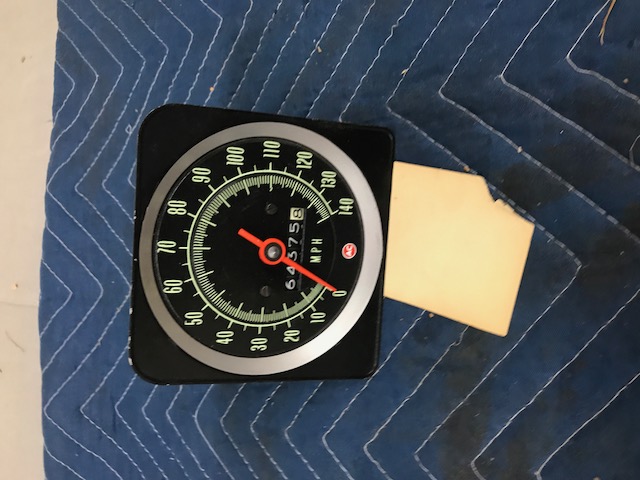

The picture Brent posted of the 140 certainly looks like an early decal version to me. Look at the right side, the numbers from 90 to 140 are almost to the aluminum edge, not at all like the originals or later repros.

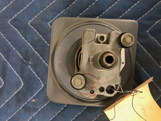

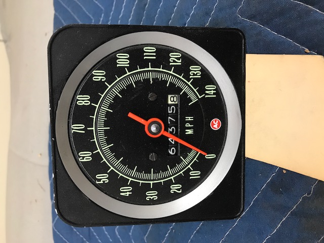

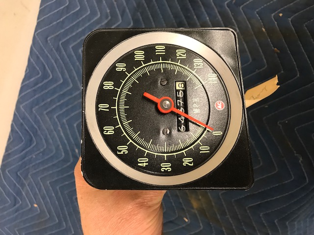

Default Real 140 Speedo

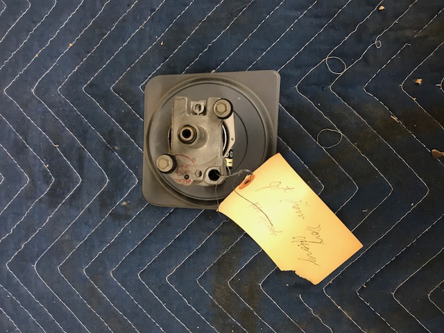

Just picked this up from an noted collectors estate. It is labeled "real 140". The numbers seem to line up properly, namely the 10 and 130 with the odometer cutout. Also MPH seems to be in correct position. Not sure if finish is correct or if someone clear coated it to protect it. Also rear is dull grey, but has red inspection stamps that seem to read "Pass".
Thoughts?
This collector had the rarest of the rare and this was well protected so my hunch is that it is real, a prototype, or something rare.

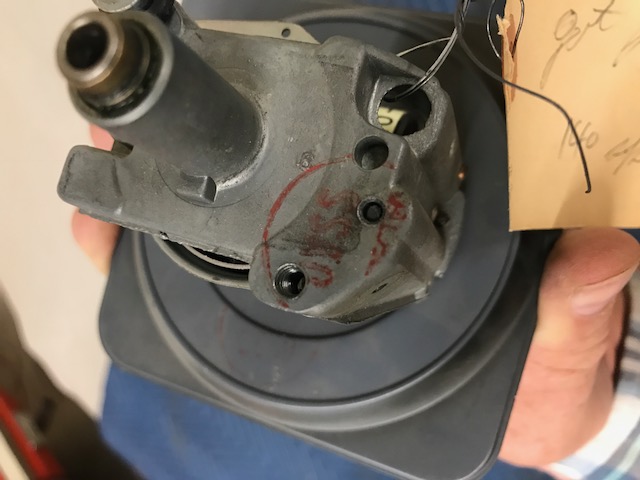

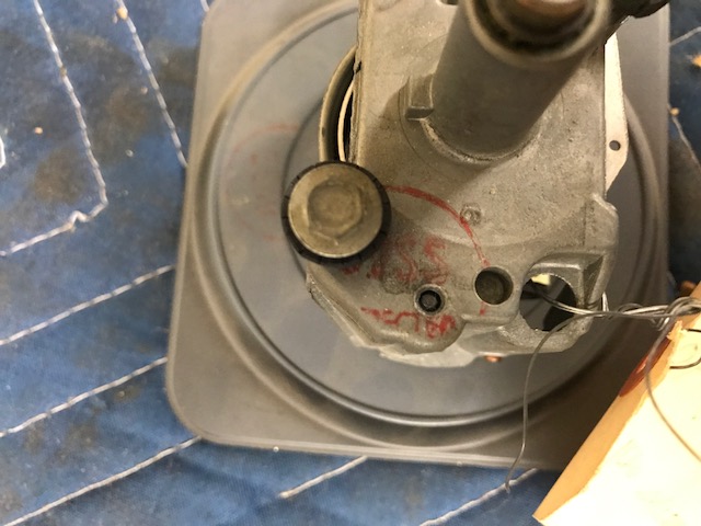

Old 09-28-2017, 05:45 AM
musclecar fan musclecar fan is offline
Join Date: May 2005
Location: CA
Posts: 198
Default Pics attached
Here are pictures of the speedometer I'm referring to.

The backside is the best way to tell, the originals will have the printed numbers/lines visible in the aluminum.
