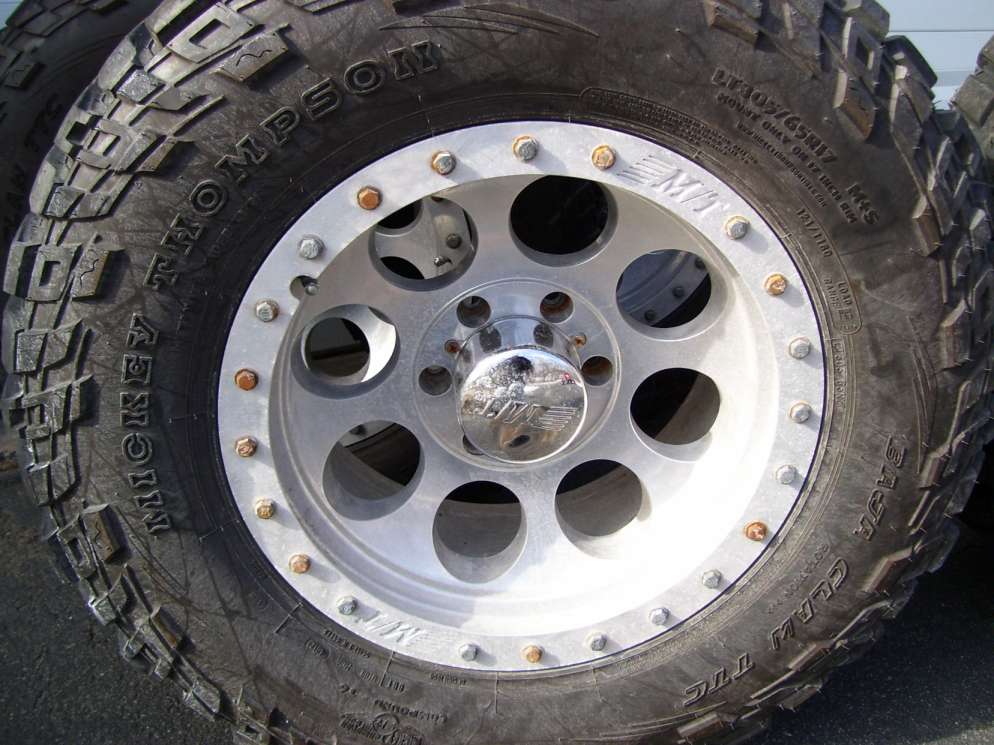

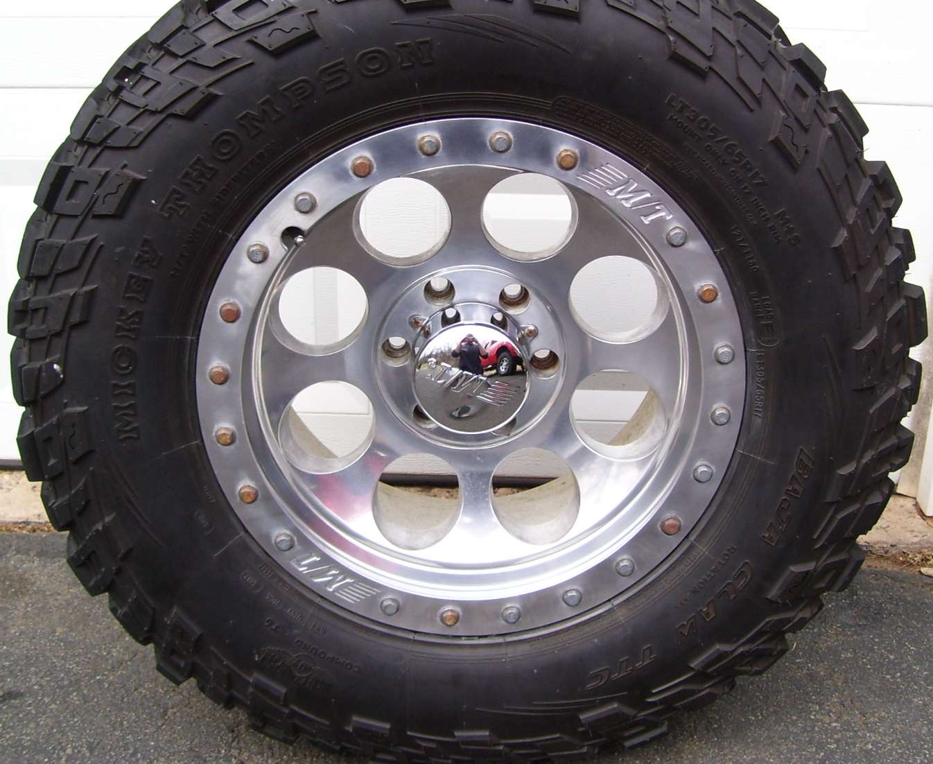

Over the winter I picked up a used truck that had some weathered polished aluminum wheels. The one nice day we had, I cleaned up one of the wheels by using Soft Scrub to clean it to start with, and then I dug around the garage and found some 3M Marine Restorer & Wax which is for heavily oxidized finishes. There was some pitting I couldn't do anything about, but it cleaned up pretty nice. I sold the wheels/tires because they were the wrong offset but wanted people to see the potential. I did all the rubbing/buffing by hand on a 40 degree day so better conditions would end up with better results. Here are some pictures before and after.
sorry about the size.

I think we had discussed this earlier Marlin. I did pretty much the same as you on the 7" Americans I have on my Nova.
I started with Wet/Dry 400 grit and went through the finer, finer, finer grits. Even used some white scotchbite pads (very fine) for some tough areas. The final stages were 0000 Steel Wool with polishing compound and then Mothers Mag Polish on some old sweatshirts. They're not perfect, but I drive the car so I wasn't after perfection. They clean up easy and take very little attention a couple of times a year.
