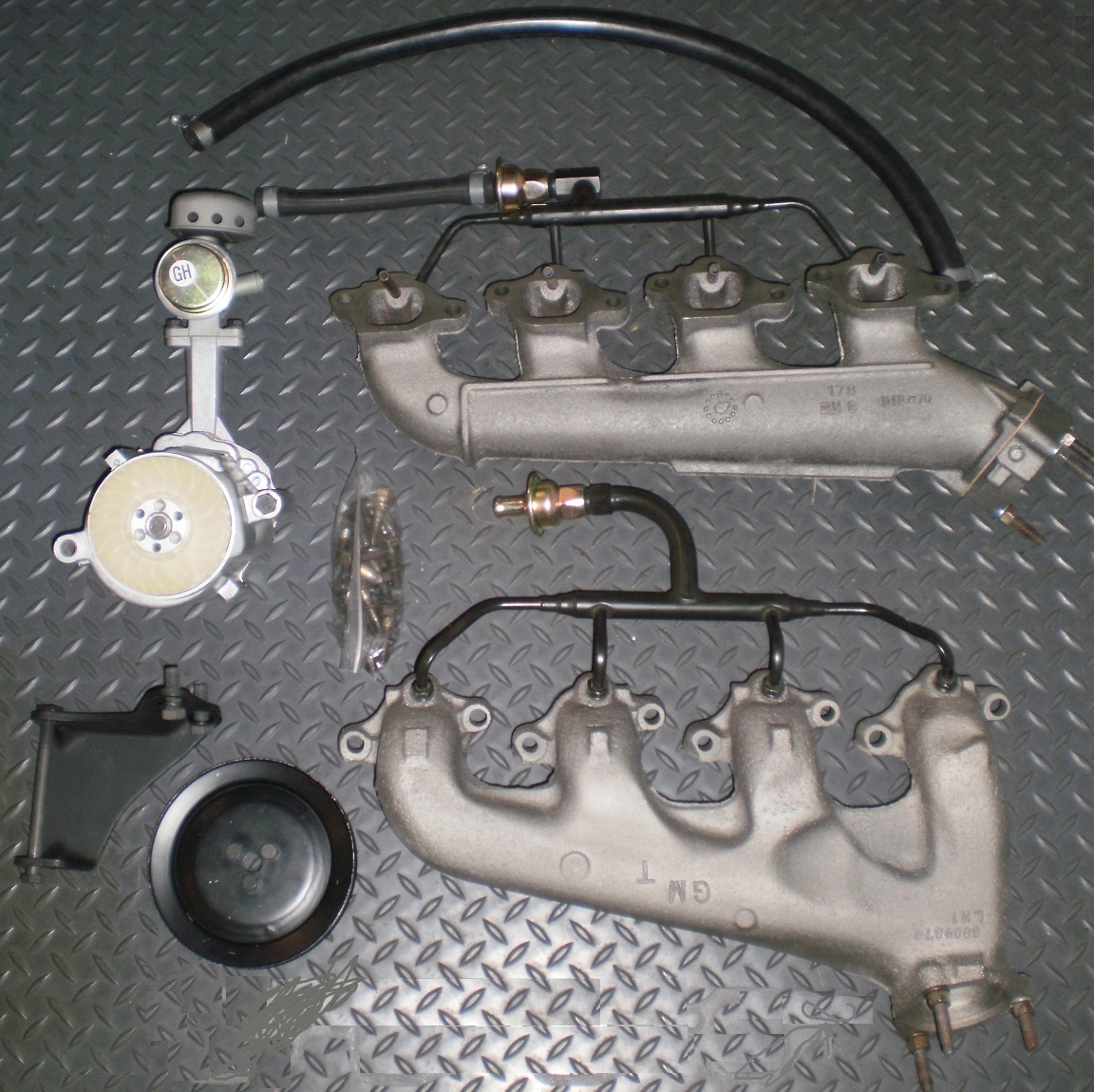

Here's another photo I dug up with the smog system on before installation for my 70 SS 454 LS6. Good luck with what ever you choose Dicky [img]<<GRAEMLIN_URL>>/biggthumpup.gif[/img]

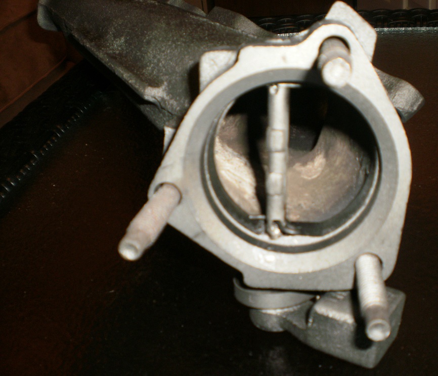

Also if you have the original heat riser on your passenger side you can copy the un seen trick I did to mine.
I grinded off the flap and drilled a tiny hole to insert a cotter pin in the stud so it does not slide off the spacer. The heat riser still works but I have a free flow right away when I start the car. You don't have to do it but I did.
