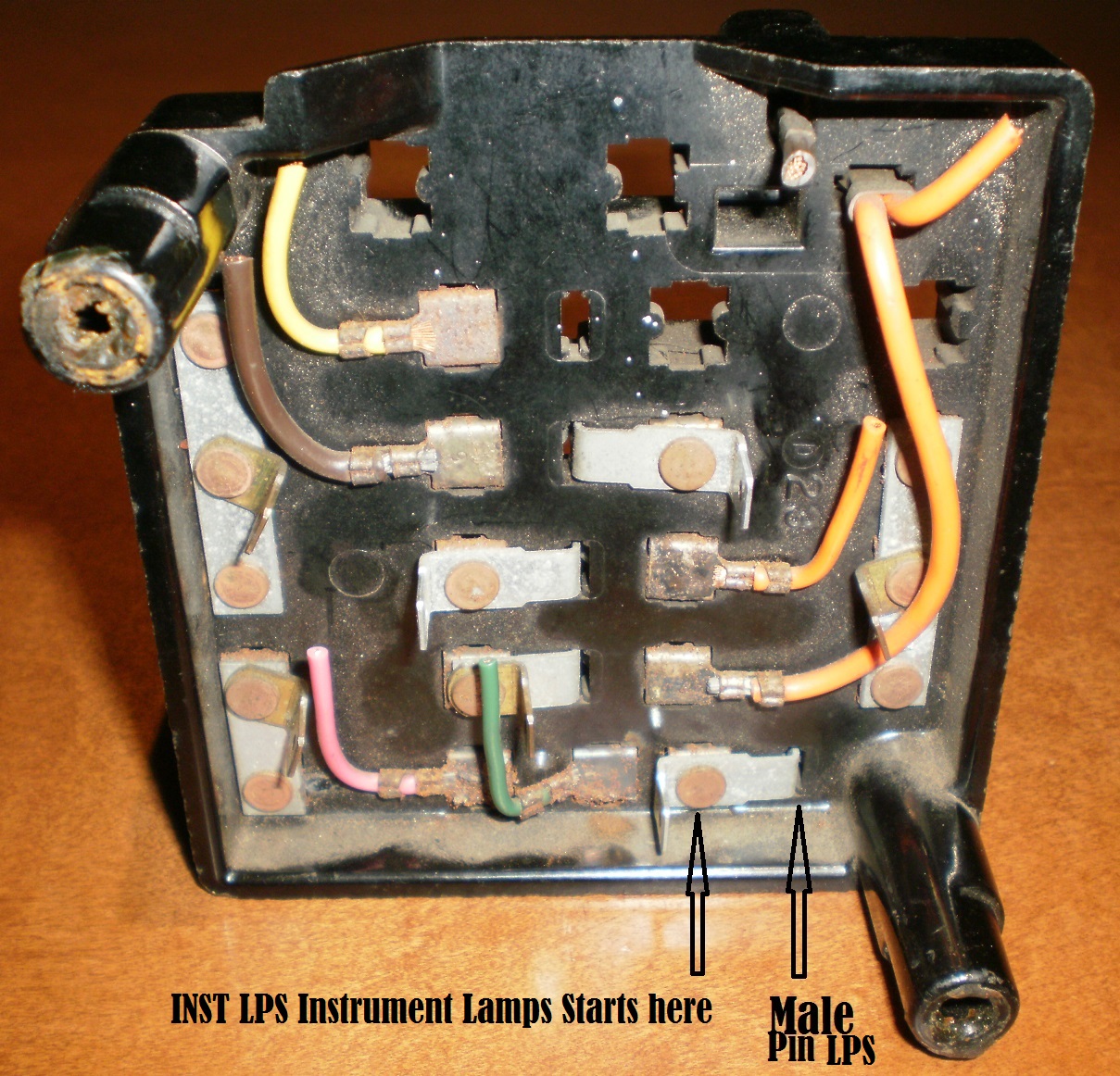

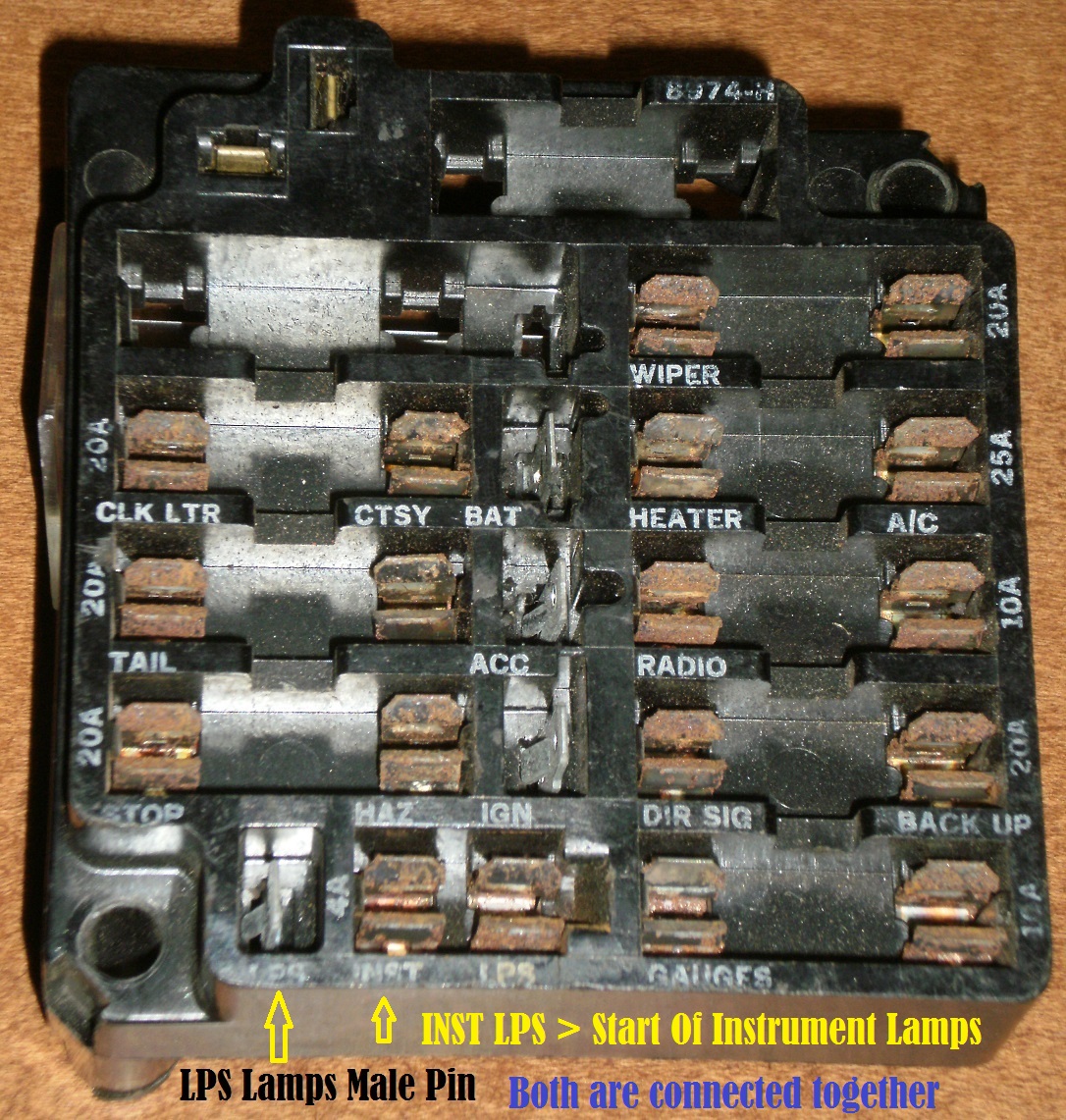

I dug this out today which is an Original Fuse box to show you your Fuse box location for the Washer Fluid Positive wire connection, you will need a female connector at the end of the wire to hook up to the male pin at the fuse box (Like XXX Rated Sex LOL) [img]<<GRAEMLIN_URL>>/naughty.gif[/img]
Marked &quot;LPS&quot; is your hook up pin were you can see it works in line with the &quot;INST LPS&quot; Instrument panel lamps which will be ideal to run at the same time your lights are on. [img]<<GRAEMLIN_URL>>/biggthumpup.gif[/img] Photo shows the front and back of the fuse box.

You rock, thank you again. Now I will be embarrassed if I cant get it hooked up correctly with all of these details. I have no excuses... LOL!!

Anthony just emailed me and said his Monitor system works perfectly the way I laid it out for him and he is very happy.
When he turns on his light switch the monitor system also turns on. [img]<<GRAEMLIN_URL>>/biggthumpup.gif[/img]
