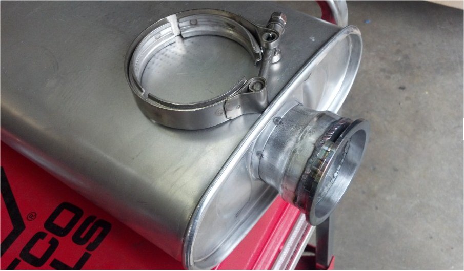

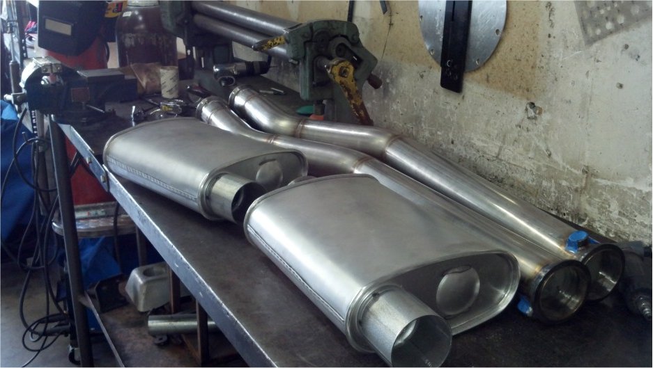

Now that I'm typing this, I realize how much I missed that feeling at the track. Here is what I plan on doing, and I think it would be a great option for this original situation where a muffler change is in order. I've used these V-band clamps on turbo cars in the past. They are an excellent way to manage exhaust pipe, allowing for simple removal and re-installation without any leaks. So I plan installing these on at least the front side of my mufflers so I can easily drop out the H-pipe system. |
