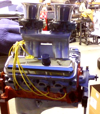

The way they did the one on the movie car would be great. But does anyone have anymore pictures showing the entire linkage at the valve cover area? Pivot points and how they are hooked up, etc.?
Here is a picture of the engine.

Tracy: Your motor looks killer.
I was poor enough in the early 70's that if I were installing a tunnel ram, I am certain I would just use a cable to the rear carb an connect the two carbs via a fixed rod. Store bought linkage?? Don't think so.
However, the weiand set up looks pretty simple and easy to use.

Don't get me wrong....two 4150 style carbs mounted sideways is the look I love, but I can't turn these 600's to the side without modifying the intake and carbs. And I really don't want to do that.
I would like to see the hydraulic linkage.
It's funny what Dave posted about the Weiand linkage. A friend of mine, who had a t.r. intake back in the late 70's, stopped by the shop to borrow a tool. He was looking at my engine and telling me about his linkage. He described the Weiand linkage down to the last detail..lol He also told me a lot of bucks down guys would use a piece of all thread and a couple of the quick release studs to connect the carbs together. And as Lynn described, make some type of bracket to hook a cable or mechanical linkage to the rear.
