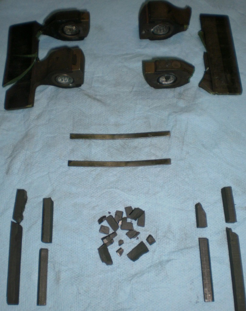

Tonight i gutted out the smog pump.
Followed the directions in the link and all went well.
There were 2 wings with 2 gears on each wing.
Two veins on each side that looks like magnet sticks and one shim on each side.
See photo of what came out.

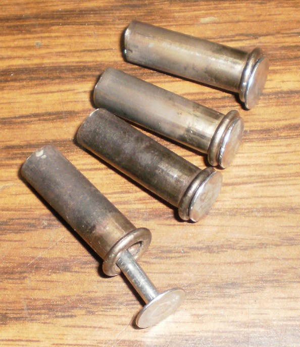

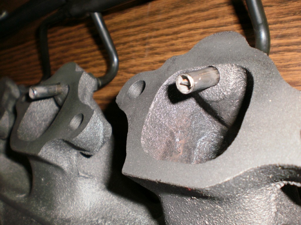

To plug the manifold holes i will be using the factory extension tubes and cut them shorter and placing a stainless steel roofing nail on the top to plug the hole.
My buddy did it this way for his 69 Z28 so i copied him.
Tomorrow i will finish it all up and ad some high heat silicone to the top of the nail for a great seal [img]<<GRAEMLIN_URL>>/biggthumpup.gif[/img]

I cut the factory smog tubes an inch which was the same size as the stainless steel roofing nail and added just a little high heat silicone on the top of the tube for a great seal between the top of the tube and under the nail head.
The pressure of the bolts that were screwed on have them in there real snug with no play at all.
I had no ball bearing kicking around so i used a metal shelf peg to plug the vacuum line which fit just perfectly with a little help of some lubricant.
Smog pump is now Gutted out, Exhaust Manifold Smog Holes are plugged and Vacuum line is closed. [img]<<GRAEMLIN_URL>>/biggthumpup.gif[/img]
