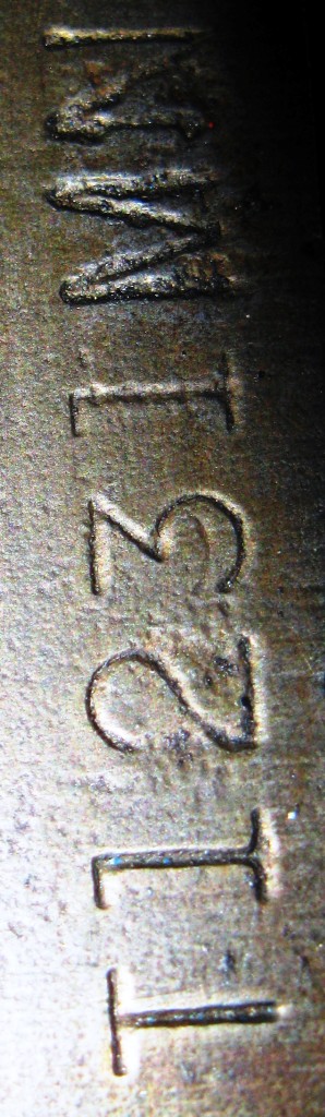

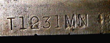

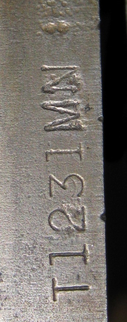

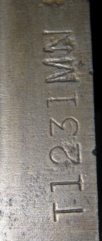

I hope I done this right there should be 4 pics of the pad

holy Hubble telescope..how about a normal pic hovering 12" above the stamp showing the block from the bore out....

I don't know if it's an optical illusion in those pics, but it sure looks to me like all the characters are RAISED above the deck surface....and that sure ain't kosher.

Yes, an optical illusion.
Its so funny because we always see the completely in-focus car photos in ads but the &quot;money shot&quot; of the engine numbers are always blurry. This one is amazing. What camera did you use?

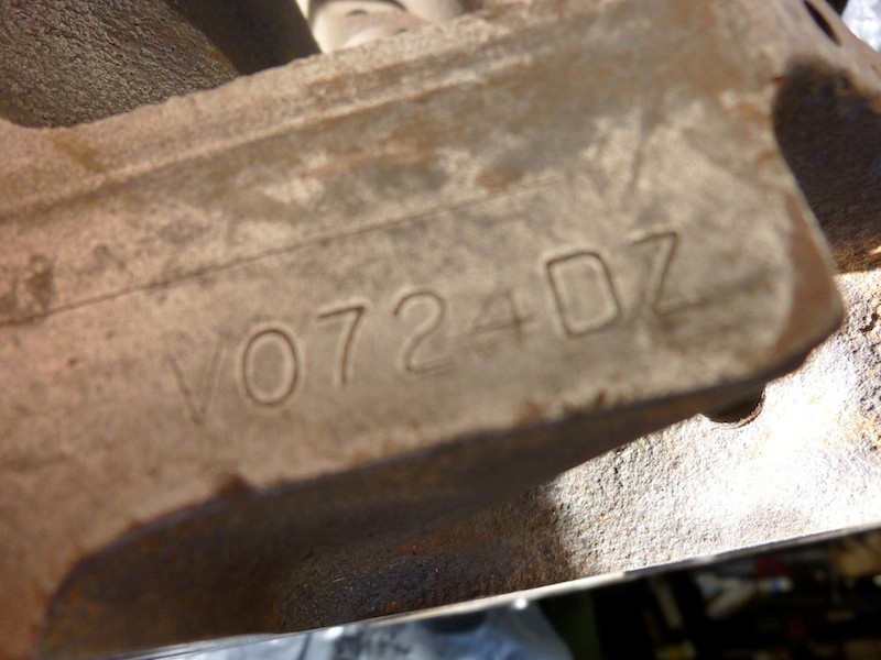

Try this:

Kevin. It would help if you could get a good shot from about 12 inches away. Try and get part of the block that also includes where the head gasket would be. Something like the one attached to this post.
Also, take a straight edge and lay it across the deck. Look to see if there is a bit of a gap at the part of the block where the stamp is. Some guys will use a belt sander to clean off the old stamp, stamp in new numbers and then &quot;age&quot; it by dabbing on some muriatic acid.
There are some guys on here that may be able to tell if it is a restamp. I haven't looked at enough big block stamps to know for sure.
