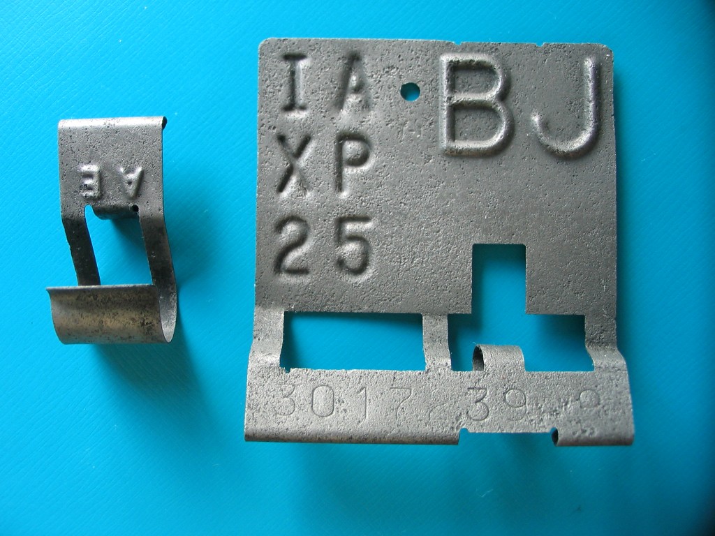

SN is a #3015099,used on 1970 MCarlo 400/265HP LF-6 w/Auto.Trans.
1969 L-78 Chevelle w/auto. got a 3 core BR coded radiator,part #3019205.This same radiator was also used in any 1970 & 1971 Chevelle,Monte Carlo or Elcamino w/LS-3,LS-5,LS-6 engines,or optional heavy duty equipped radiator,or Air Conditioned equipped too.
The 1970 L-78 Chevelle w/TH400 got a one year only BJ coded 3 core radiator,part #3017239.
Because of the extremely low production of these,it's one of the hardest radiators & tag to find.
Other then my original,I've only seen one other.The vast majority are M/T.
The reproduction market is NOT manufacturing these tags correctly,to the original design.

The Tag listed the tanks used to make that particular radiator..i.e. IA & XP tanks were used to make a BR radiator.
BR is also shown in box #45 of the bsheet.
Donnie
Yes,a 1969 BR used IA & XP tanks.It was the measurement of the various cores that were different amongst specific radiators.
BR used .16 Convolutions,meaning size of the cooling fins.
BJ used .18 Convolutions,meaning size of the cooling fins.

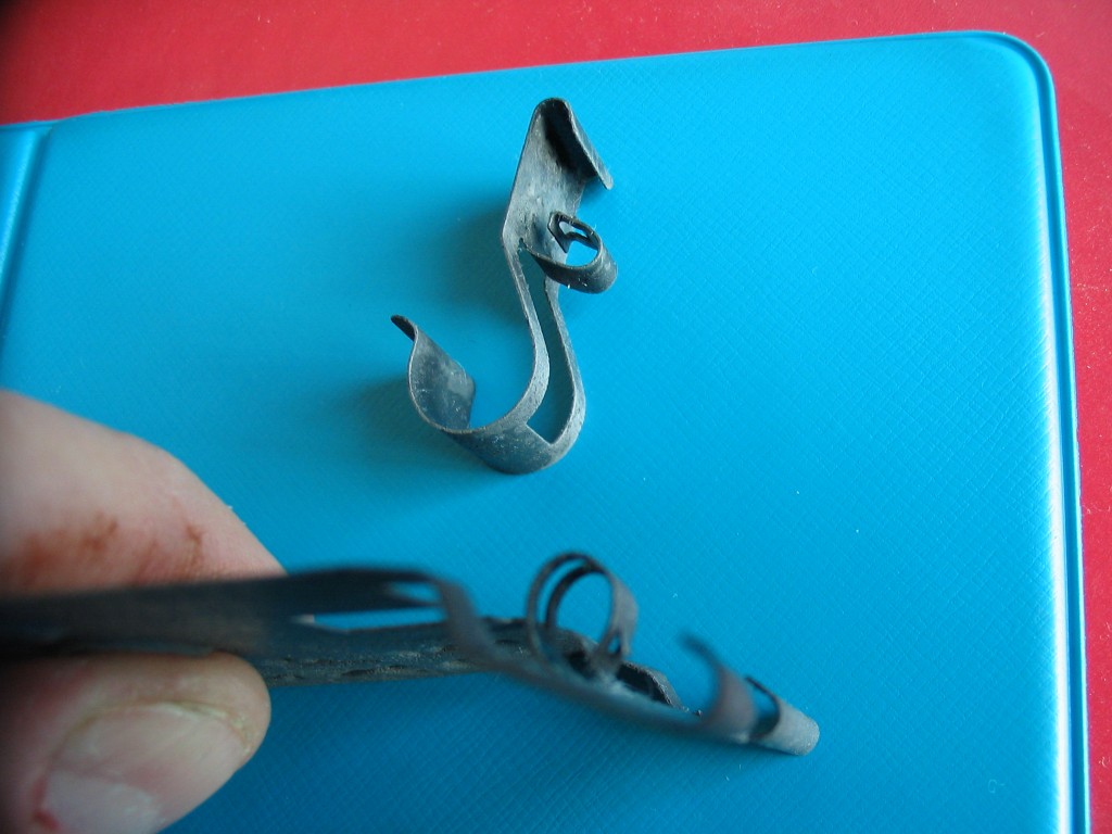

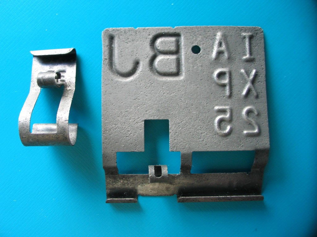

Below is the original off my '70 L-78,along with the original drain tube clip.
Notice the difference between this one & todays repops.
Also,among other noticeable differences,notice the repops do not have the 7 digit part # stamped into the bottom of them,like the originals,nor the last number indicating the month.

Hey Rick.
What were the break downs of the codes of the small hose bracket like the one you have pictured showing AE,
Mine has an H stamped there.
Any Meaning to these letters?
