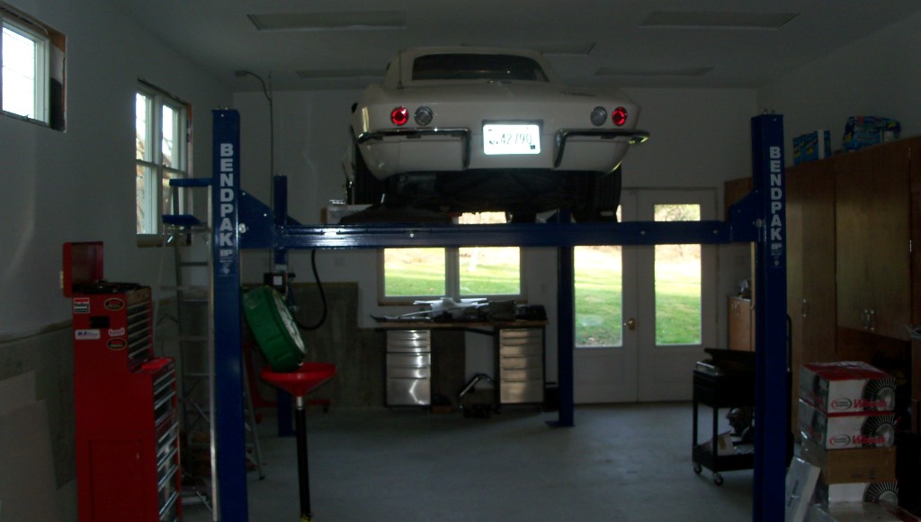

Spent a year doing my homework,and talking to people that used and installed them maybe the info can help you . Bend pak IMO is the way to go. I personaly wouldnt get under a 1500.00- 2000.00 lift every day if you gave it to me. Best lift is a extra wide w the rails set apart[even a corvette fits on it and you have 9 inches extra under the car width [48 inches wide between rails]. 9000lb 9hd xw plus its 6'11 height under runaways matters, at least for me. If you dont need the extended height you can save a foot in length Notice how wide the uprights are compared to the car[dont have to fold in mirrors even on pickups]. Only down side is its a foot longer and wider than the smaller lifts. Couldnt be happier with it. They are only 3,150 on ebay and elsewhere [get the aluminum ramps option !]

How tall are the ceilings Chuck??

Ceiling height is 12'4 . they dont look it except the fact the double door in the pic is an 8 ft unit Had the flourescent lights recessed into the ceiling to save 4 inches of height[that actually made 4 sheetrockers run away] ..keep in mind every inch was taken into account to the point I measured every car ive had and may ever have in the future. One thing I didnt want to listen too is that with the extended lift at highest setting so I could almost walk under it ,even I wasnt going to be able to reach alot of parts on the vehicles. I have to say they were right about that. I would guess that 11 ft ceilings would be more than adequate in most cases [I believe the website claims around 10 ft or so minimum ,or in belairs case, 8 ft.
