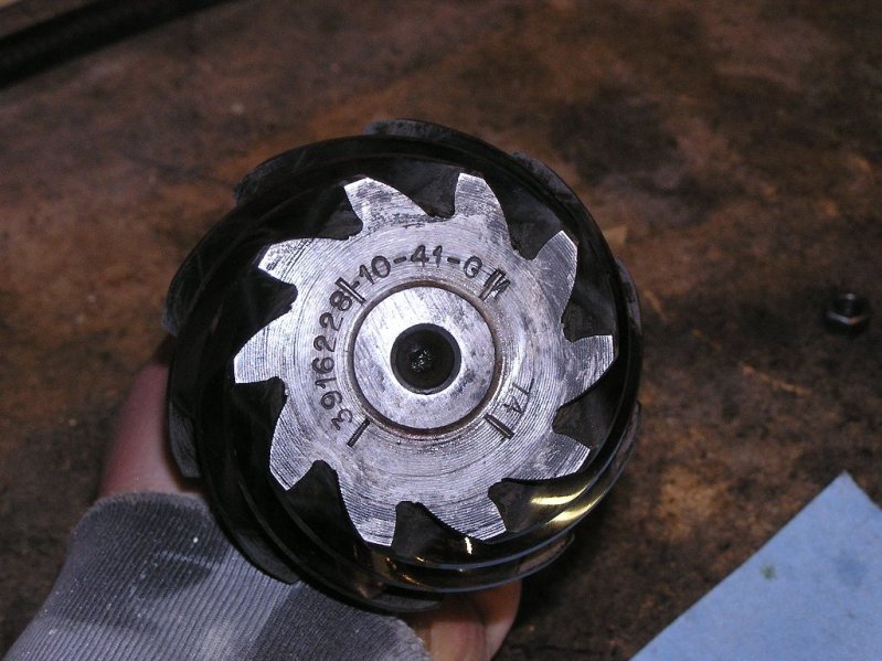

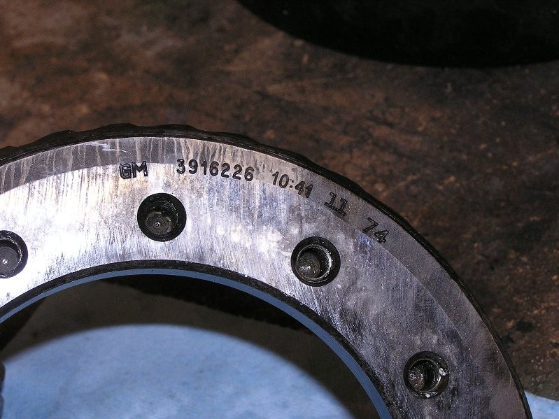

Here is a set of COPO 4.10s from 1974. that match your 4.56s.
I will post pictures of the different markings that I have found this weekend.
