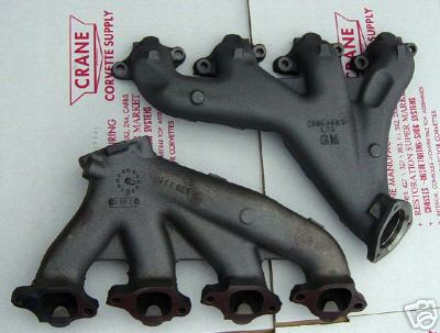

My friend thinks the L78 in the 1966 Chevelle was identical to the '65 L78 in the big cars - I'm talkin' physically, not on paper. I have a suspicion that there was something different, like a carb or exhaust manifolds, that may have been different. Anyone?

The neat thing about the 1965 Full-Size 395-425 HP cars is that they shared the same "swoopy" exhaust manifolds with the Big Block Corvettes. 1966 Full-Size 427-425 HP cars also shared the good exhaust manifolds with Corvettes. These better exhaust manifolds didn't fit the Chevelle chassis so they used the more restrictive "log" type exhaust manifolds.

I wouldn't bet those Corvette manifolds won't fit on a Chevelle. We put a pair on Terry Penningtons 69 Camaro F.A.S.T. car just as a trial to see if they would fit and they cleared the sub frame (they were close on the steering but didn't hit) with no problem. You would have to eliminate the heat riser and get a little creative with the exhaust pipe bends, but it could have been made to work. I'm not saying the factory would have done it the way we were going at it, but there is still a possibility. Terry has a 67 Chevelle 4 speed car in his shop right now that's going to get a 375/396, and I'm gonna try a pair of Corvette manifolds on it just as soon as the engine goes back between the fenders.....
