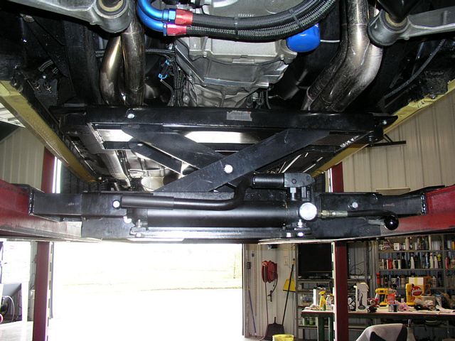

Get a 4 post with the sliding jack. You can change tires etc easily. When these things came out it really advanced 4 posts [/ QUOTE ] Charley,is that jack hydralic or a hand jack? |
#12
It is hydraulic that you hand pump. Basically it is a porta power pump hooked to a scissor jack. They also sell ones that are air over hydraulic that you hook a air hose to that uses a butterfly valve. They work great. The lifting arms slide in and out for width and they have extensions that space the pads up.

It is hydraulic that you hand pump. Basically it is a porta power pump hooked to a scissor jack. They also sell ones that are air over hydraulic that you hook a air hose to that uses a butterfly valve. They work great. The lifting arms slide in and out for width and they have extensions that space the pads up. [/ QUOTE ] I purchased the backyard buddy with the jack that hooks to the hydralics of the lift and it was 1700 bucks! I would have purchased the hand pump one if they had it. I do not know if they sell the handpump one anymore |
