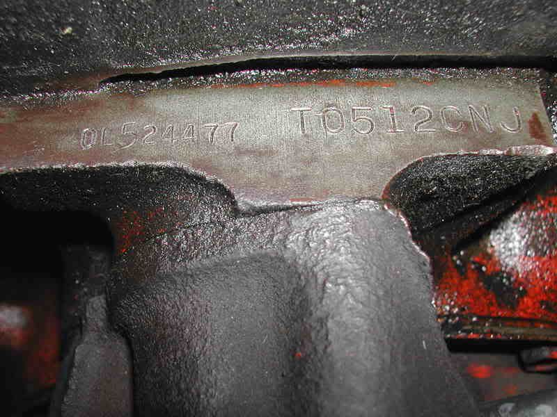

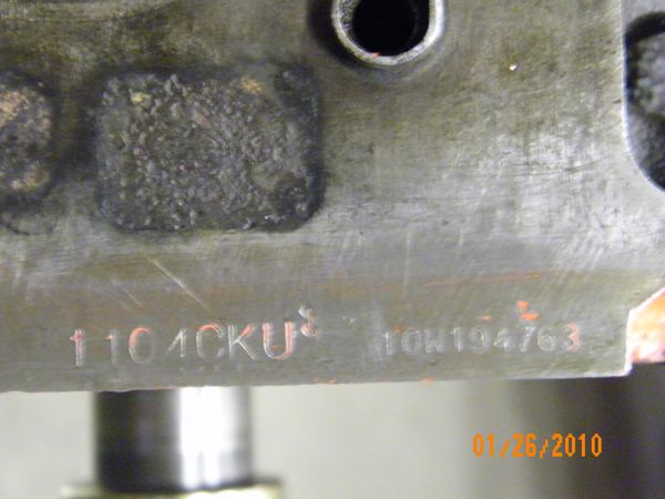

I think the pad has been filed/sanded down and re-stamped, no broach lines at the end. This is what a good pad looks like:

Neat looking car. Obvious restamped pad, not so neat looking.m

I think the vin # on this picture looke weird. What happened to the 5, why is it a different size?

You need to look at the VIN stamp on the trans and compare. I have seen variations of the stamps to some degree over the years.

I agree. If the guy was going to re-stamp, why would he/they make the 5 like that?
