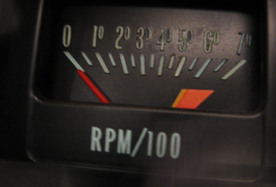

Well you will know in a few weeks if it was a good buy or not. What is the redline on the tach? Was there any paperwork to show how the car was ordered?
#14
Mark's question about the tach is a good one...the photos in the ad don't show enough detail on the tach. The forest green paint looks very nice....exterior trim matches the trim tag.

6K tach mathces the one in this example (this site has the right image incidentally but the wrong redline figure). Bottom L78 tach is actually a 6K redline but they do look is deceiving)
Single fuel line. Rear axle same week as trim tag (was told this is not uncommon on fisher tags from Willow Run) CBS 04 15 G 2 Carrier number 3968341 So I agree, looks L34 from bell housing back. Hard to convince myself someone would order it for high end and not stoplights. www.chevynova.org/NovaTachs.html
