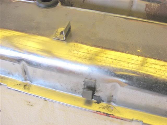

OK, here we go.
Set one:
Driver Cover- One clip at outside of cover, return spring tab on wire tower
Passenger- No wire clips
  #12
Old 09-10-2009, 12:33 AM
Join Date: Sep 2001
Location: Santa Cruz, CA
Posts: 6,585
Thanks: 404
Thanked 727 Times in 376 Posts
Default Re: Identifying Big Block Valve Covers
Set 2:
Driver- One clip at out side, tower does not have return spring tab but has a hole.
Passenger- One clip on outside, 2 clips on inside
  #13
Old 09-10-2009, 12:36 AM
Join Date: Sep 2001
Posts: 6,585
Thanks: 404
Set 3:
Driver- Small "silver dollar" booster relief, 2 clips on inside.
Passenger- No clips
  #14
Old 09-10-2009, 12:41 AM
Join Date: Sep 2001
Posts: 6,585
Thanks: 404
Set 4:
Driver- No Clips, wire tower has hole for return spring.
Passenger- One clip outside, 2 clips inside
  #15
Old 09-10-2009, 12:46 AM
Join Date: Sep 2001
Posts: 6,585
Thanks: 404
Set 5:
Driver- One Clip Outside
Pass- One clip outside, 2 clips inside
  #16
Old 09-10-2009, 12:49 AM
Join Date: Sep 2001
Posts: 6,585
Thanks: 404
Finally, the left overs. There are 2 passenger covers. One has been robbed of the towers and clips. There is also one driver's cover that has no drippers. May be repro but feels heavy- low perf?

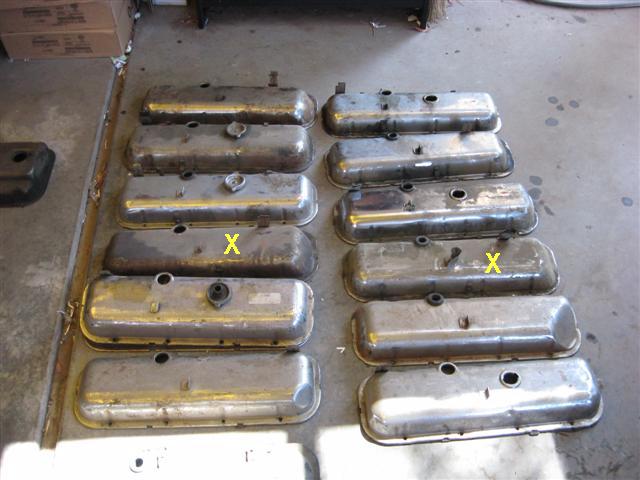

Don and Martin,
Did the pictures help at all? Does it look like I have the covers paired correctly?
Thanks,
Jason
  #18
Old 09-16-2009, 01:39 AM
Don_Lightfoot's Avatar
Don_Lightfoot Don_Lightfoot is offline
Location: Kingston, Ontario
Posts: 1,193
Thanked 3 Times in 2 Posts
Well Jason, seems you've got a real hodge-podge of maybe everything. I've marked a couple on the attachment of your original picture which seem to have the shape of a 69 Chevelle. However, I don't know which ones in the other photos are these two. Most of your descriptions provide multiple clips, but there was just the one clip on the 69 Chevelle cover (driver side outside).
Specialized Chevrolet Decals
  #19
Old 09-16-2009, 02:30 AM
Join Date: Sep 2001
Posts: 6,585
Thanks: 404
OK, I know the one on the right is set one since it is the only set with duct tape around the towers. I will try to figure out which the other is. Thanks for the help.
Jason
  #20
Old 09-22-2009, 08:34 PM
JAD JAD is offline
Join Date: Apr 2006
Location: Dallas Tx.
Posts: 248
Do 69 big block Camaros and Novas take the same valve covers or are they different????Thanks
