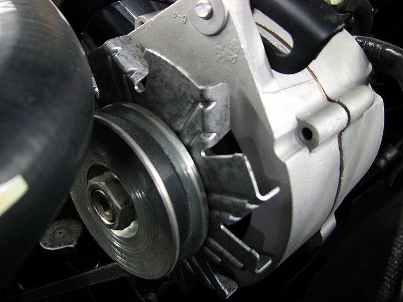

Fan blades were actually galvanized. However, No platers I know can do this. Clear zinc as mentioned is a good alternative.

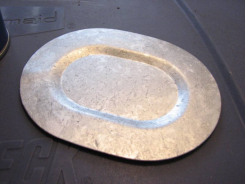

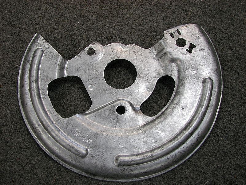

Zinc in my opinion it too shinny and not like originals. I use a technique to get mine to look like galvanized metal just like drain plugs, trunk drop downs and backing plates.

Looks great Rick!
