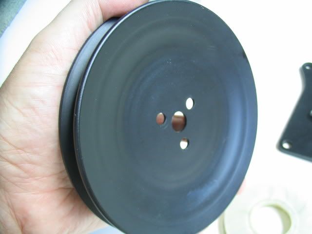

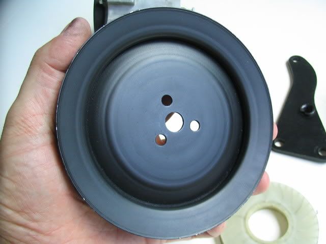

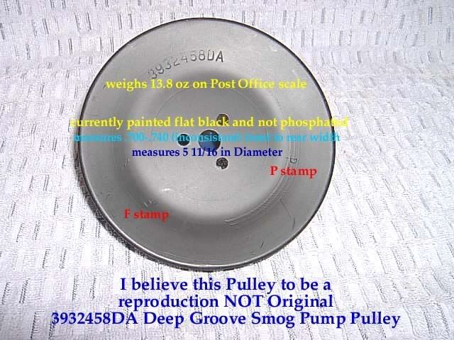

I believe this to be a repop, I compared this to a couple of original ones, definitely off, what do you think?
