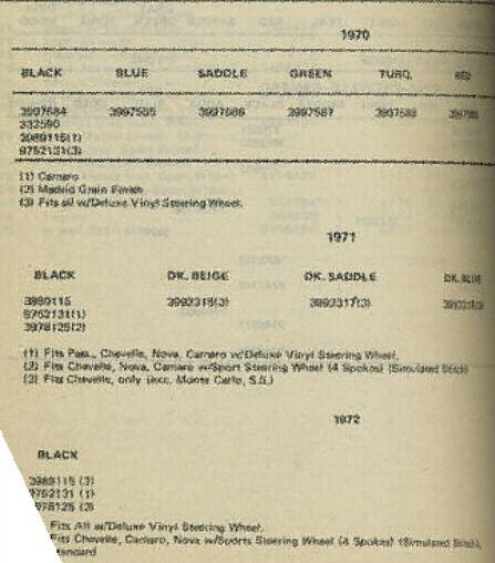

Here's a thumbnail scan from my parts book, sorry it's crooked. Shows part #9752131, but this is a 1975 book.
Now we need a Buick parts book to compare.

Thanks Rick. So from that we can also add 1972 to the list! The picture doesn't show 1973-1975. Does that P/N apply to these years as well?
Finding someone with a Buick book is going to be next to impossible!!

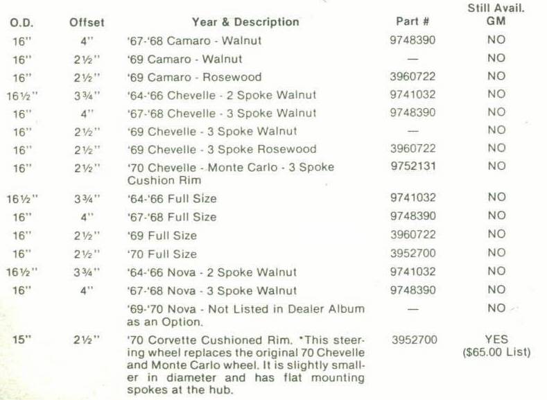

We seem to have that one nailed down, but I'm still wondering about the 9752131 wheel. Ken lists that one in his article as 1970 Chevelle/Monte Carlo 16" (see attached). Since we know the "Thumb Grove" wheel was 16" in diameter, I'm wondering if the 9752131 is the "Thumb Grove" wheel??? <u>EDIT:</u> Nope. It can't be the "Thumb Grove" wheel since the P&amp;A 26 doesn't list it for Buick in the Vehicle usage section. Back to square one on the 9752131 wheel!
