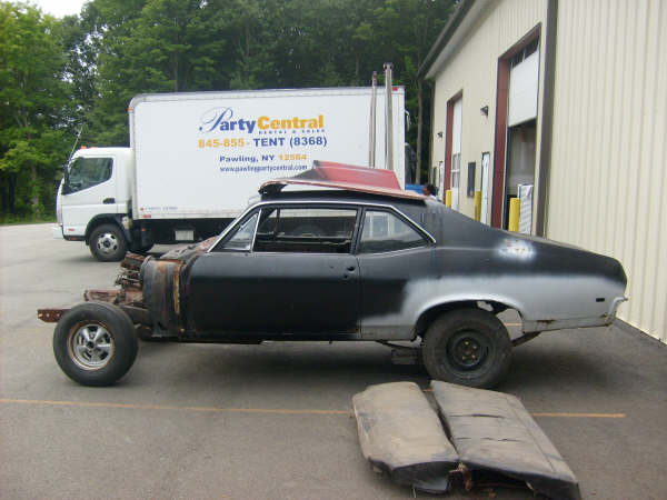

Ok so you guy's are almost talking me into going to look at this car. The car has no documintation, it has the BB heater box and the original 12 bolt BN coded. The car is a 9A built car. Missing the complete front end and original motor and transmision. It has clutch pedals but I think it was an originally an automatic. It still has the hole for the shifter in the column! On the floor inside the car I saw a BB 4-speed crossmember. What automatic would come with the BB nova's only the turbo 400? It will need a trunk pan and a small patch panel in each front floor pan. From the pictures the quarters and doors look good. What do you guy's think it is worth. I know it is hard to tell without pictures?
