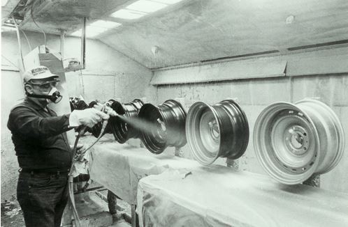

This is a better picture of a typical spray booth. These are truck rallies getting their argent silver color coat at Chevrolet Flint Assembly, circa 1979.
You can see the water flowing down the wall in the background, which collects the overspray and carries it away. The resulting sludge is dried out and disposed of in a manner consistent with the disposal of industrial hazardous waste.

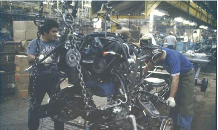

One other tidbit from the Olds photo: if you look carefully you can see the brake master cylinder slaved in roughly its final location; by this point in the process the brake system has been completely assembled, evacuated of all air and filled with fluid (and any required repairs performed), tested and bought off as good.
I always enjoyed looking at the assembly process and noting how different the order was from what you or I would do in our own garage.
Flint Assembly motor set operation shown below.
