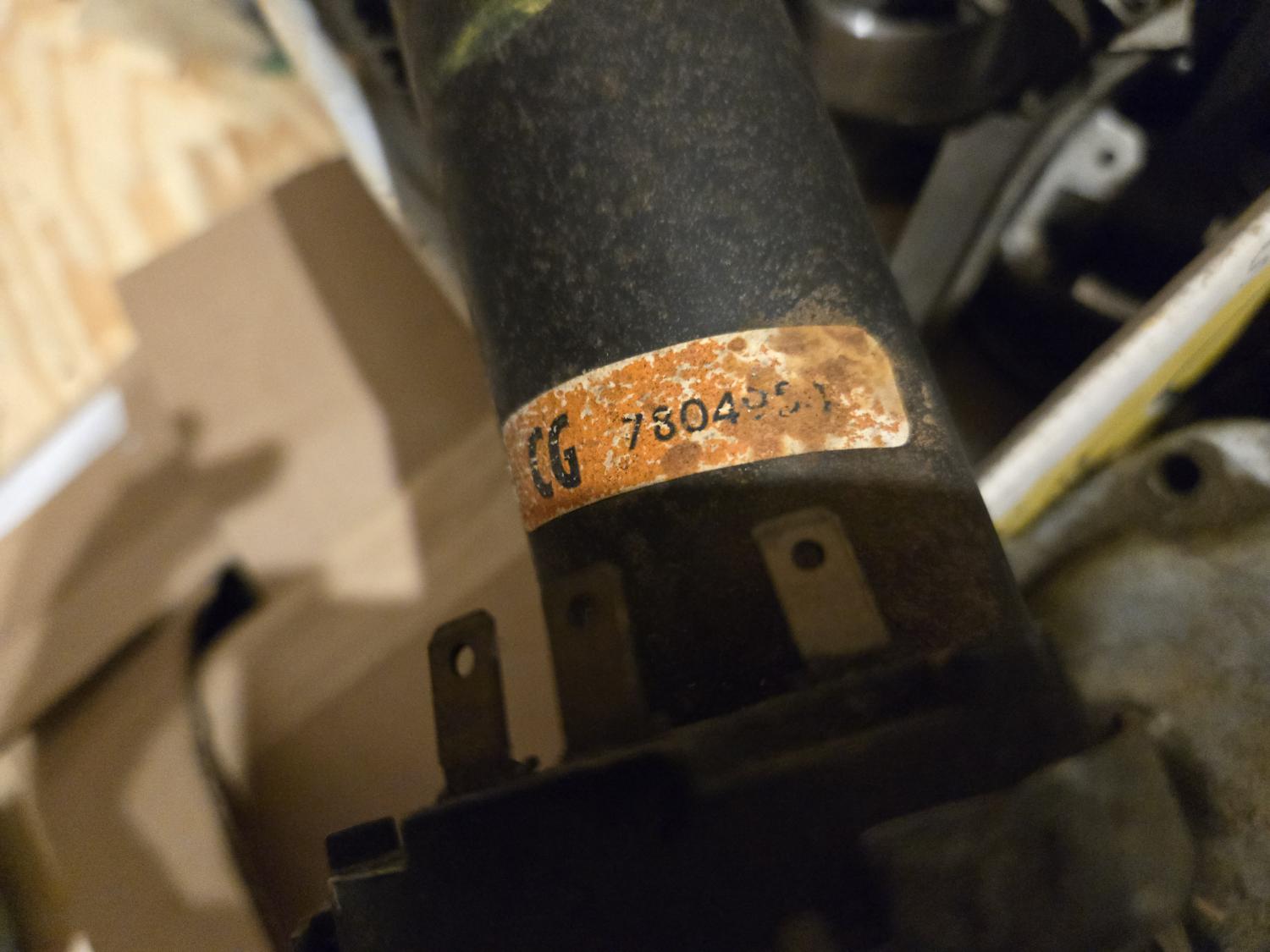

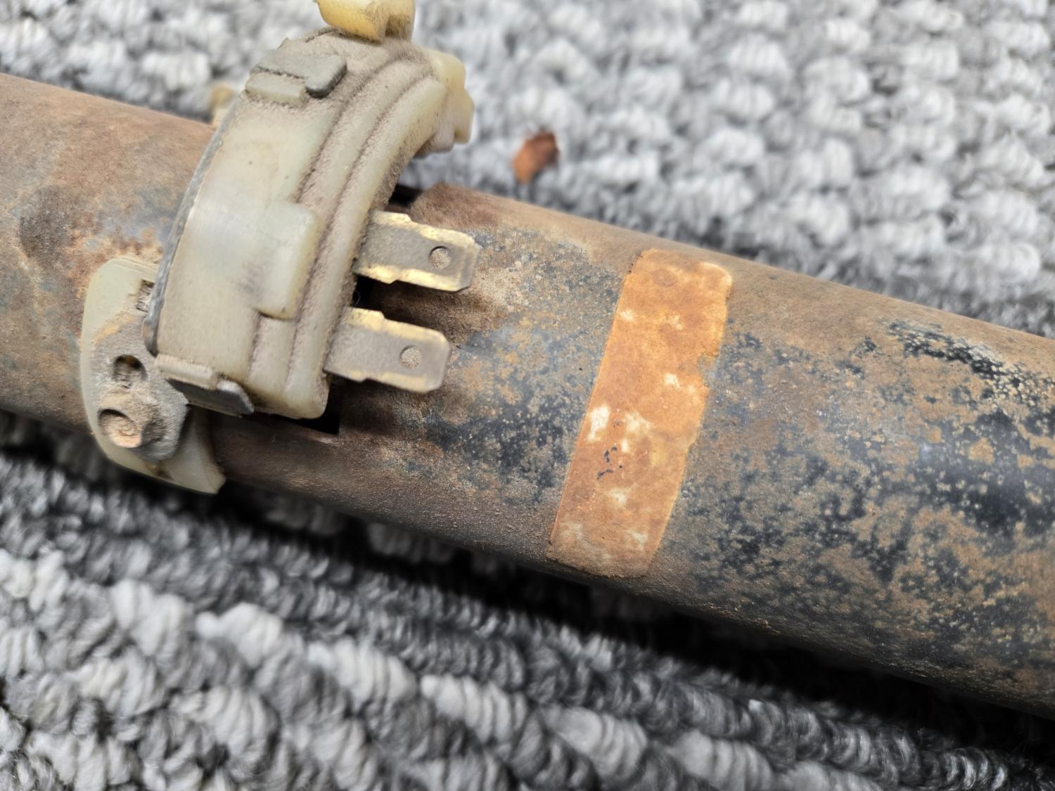

Finished decals for the springs and steering column. I used the spring chart and weights for a 69 to take my best guess at an l89 300 deluxe car.
Steering column was fun. I used a combination of known part numbers and a steering column or two that dad had laying around with the decal still present. One thing i love for detail here is getting the font and type size correct to match originals. There honestly are very few if any reproduction decals of any type that are even close. Soon i plan to do an exact copy of the emission decal that goes on the core support radiator top plate.
Picture order: Springs and Column printed, Original Column(Auto I believe), Orig column to the car, and Redone finished

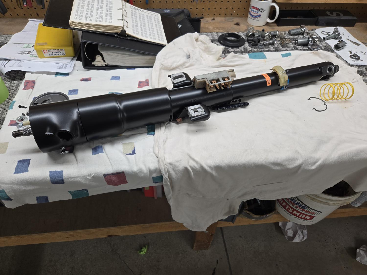

Default Steering Column Complete
Mostly finished with the column. Had to put in a new lower bearing at the bearing cup is in the plating box so finaly assembly will have to wait. I also need to get in an nos igntion switch i order and rekey it.
I struggle with these, as i had the top section on and off about 5 times before it finally went into place.

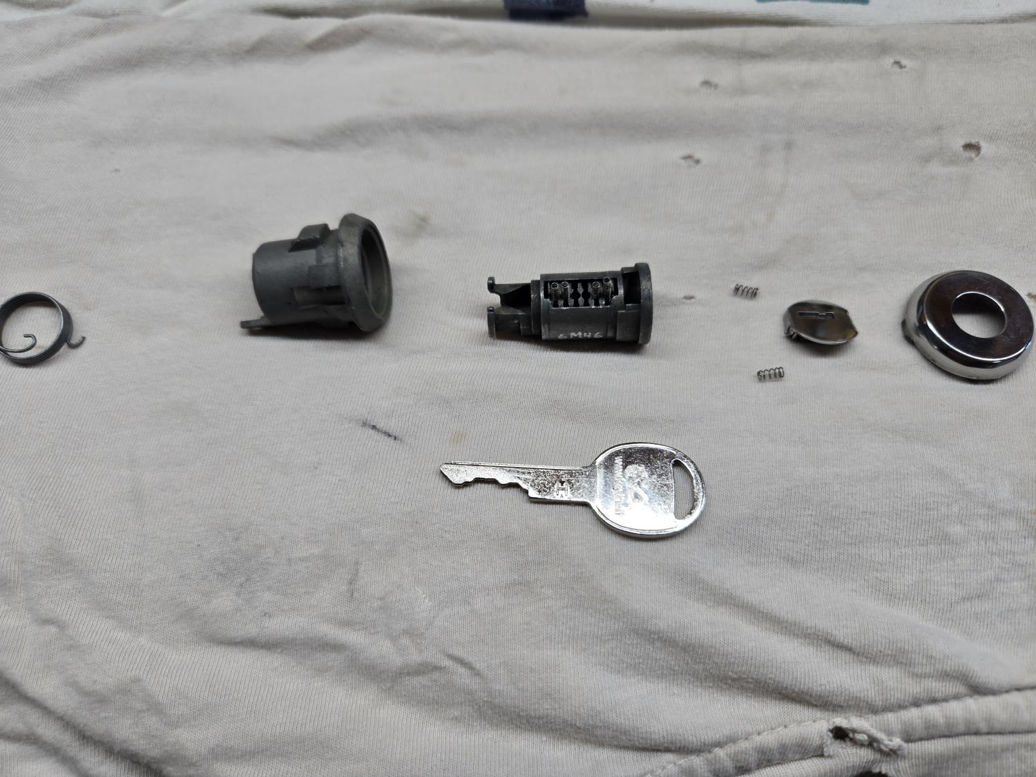

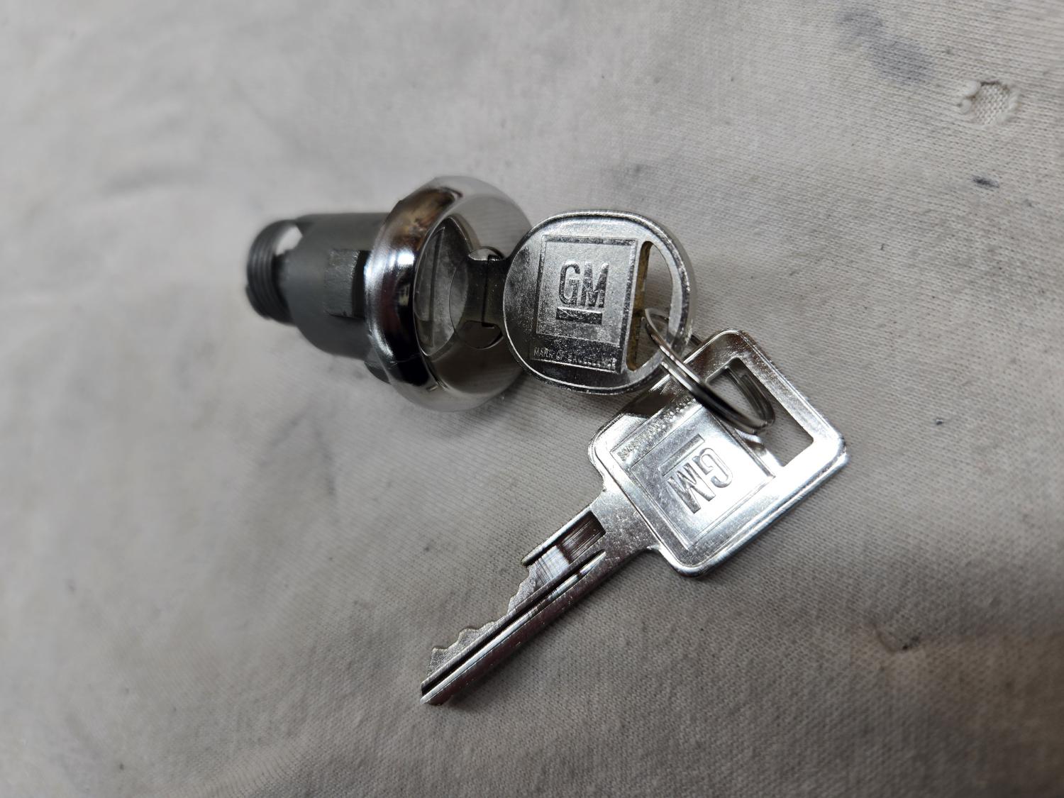

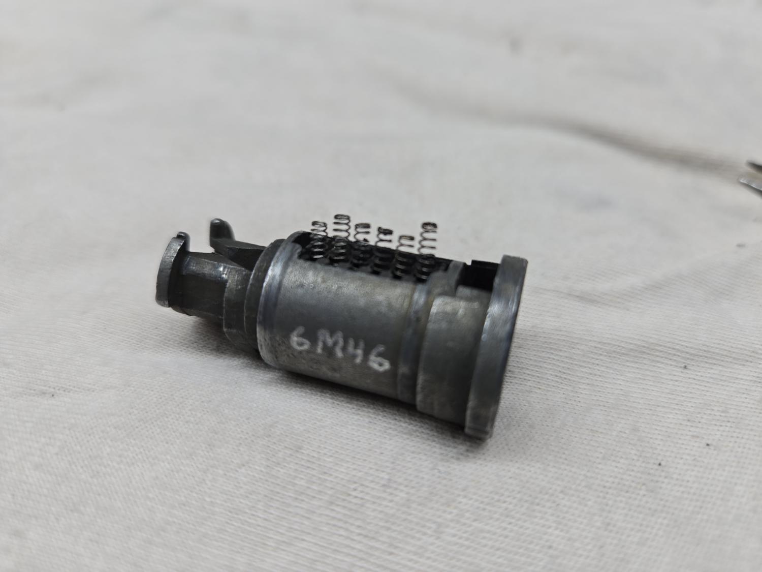

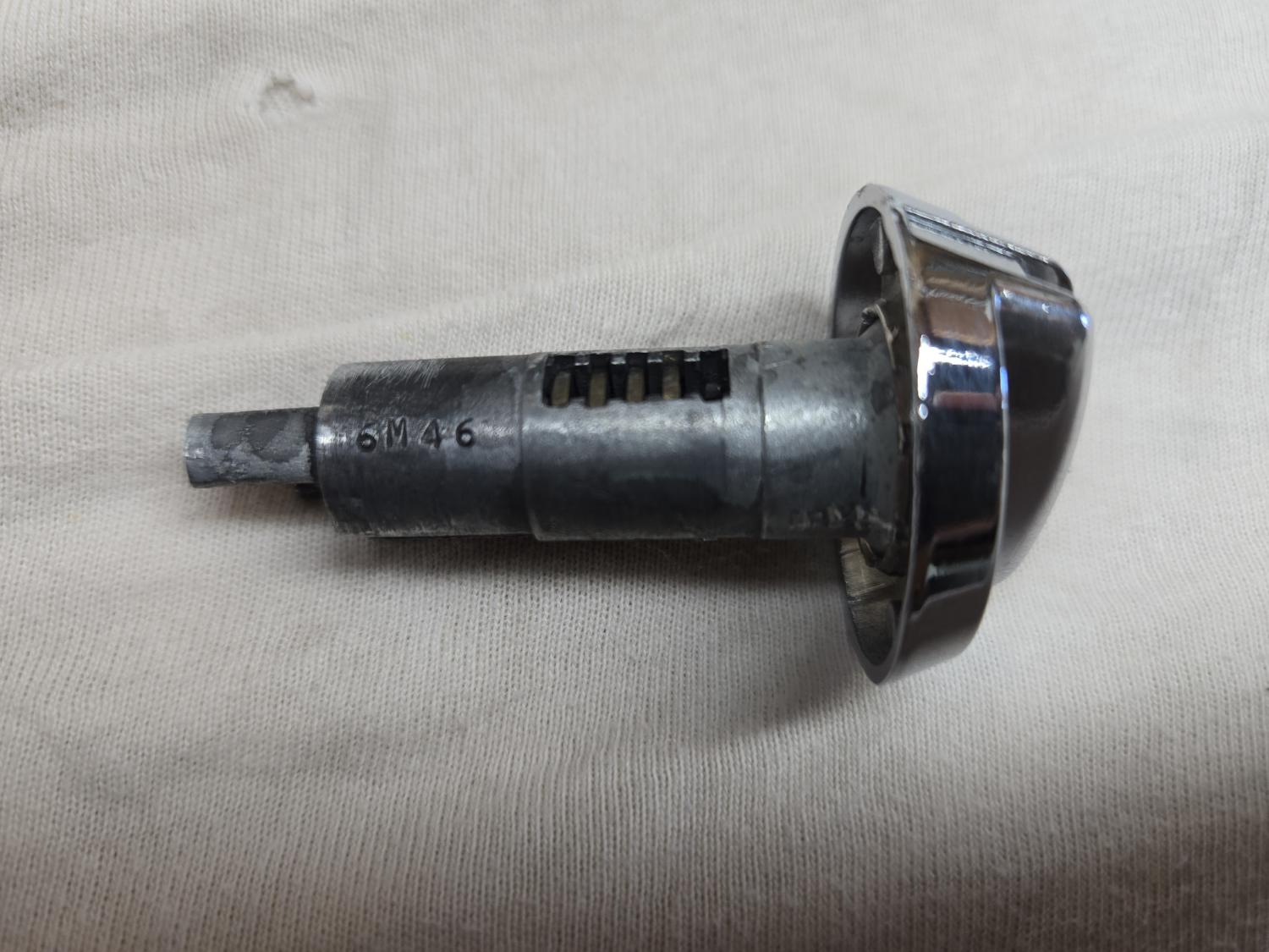

Default New Skill, Key Cutting and GM Key Codes
After my dad moved we lost our chevy dealership person back in Dubuque Ia that cut and and rekeyed lock cylinders for us.
This meant dad and I got to research how its done. Not terribly complicated, but you need something like a Curtis key cutter, the right cams and carriages, the key blanks and most importantly the key code book to take all your old lock cylinder codes and have keys made for them. On this car I had all the original glove box and door cylinders. I had to rekey the trunk to the original glove box and rekey the ignition switch to the doors.
All pretty straightforward as long as you can read the 4 digit GM code on the side of the cylinders. This was alot of fun to read up on and do.
Pic1 Curtis Cutter
Pic2 Key succesfully cut(trunk and glove box for a 69)
Pic3 doors tumblers restored, polished, and keys cut
Pic4 Glove box tumbler, showing the code
pic 5, 6, 7 Rekeying the trunk lock, includes pulling the entire assembly apart and pieces of the tumberl to get to the individual tumblers. Redo the 6 tumblers to match the key, springs, spring retainer, and reinstall with new key face pieces, and done

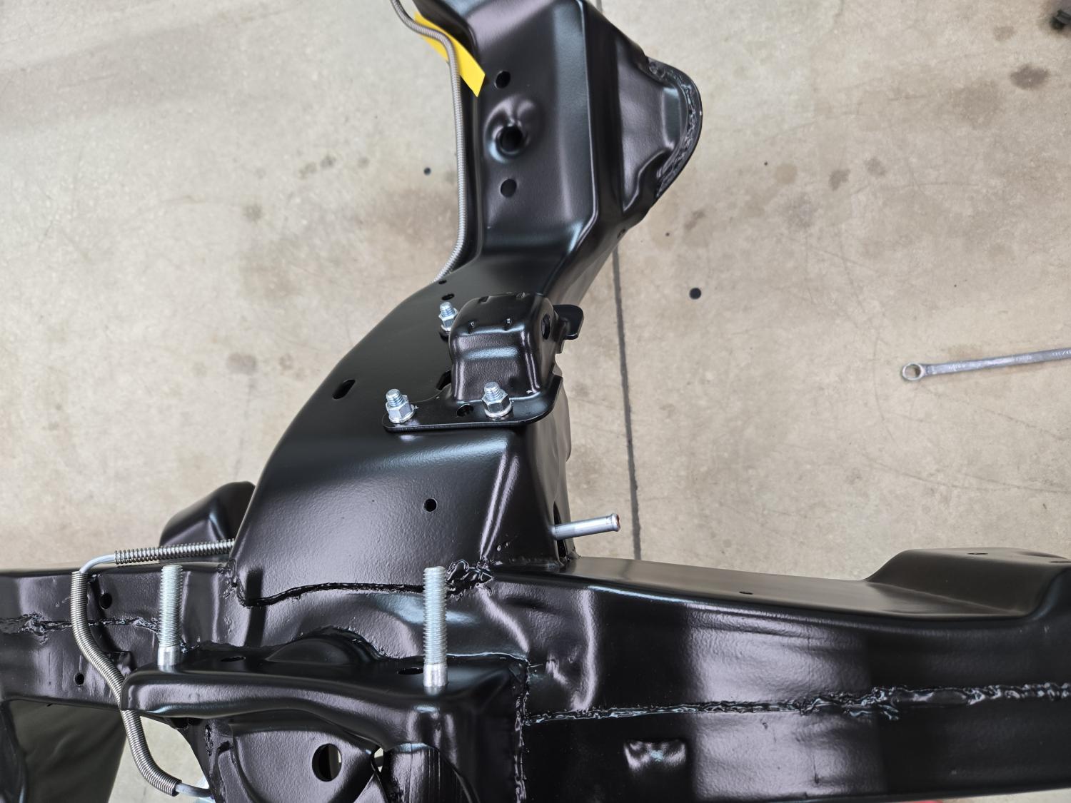

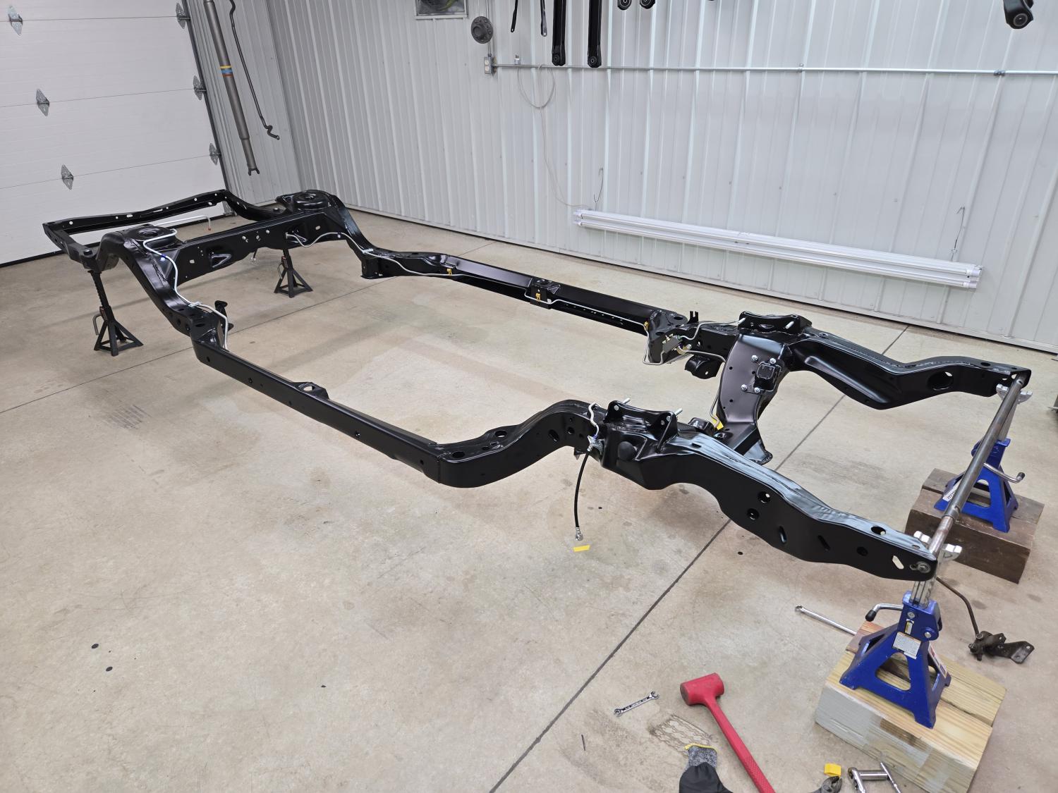

Default Front Suspension
As i assembled the front suspension my fear is it will be coming part post restoration for ride height adjustment. Looks super clean and no scuffs or scratches. Happy i got to use over the 2 piece rotors.
