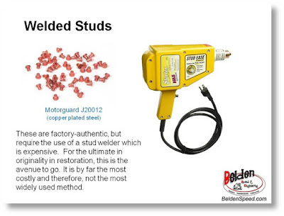

These are what I used. I didn't have NOS quarter panels installed so I could drill holes in them for screws. Some folks will use the screws and seal them with urethane. Didn't like the idea of possible water intrusion around the screws.
