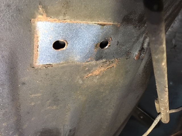

when you removed the rear frame fuel line clamps what style where they did they have the tab that pulled into the frame

Just got around to pulling the rear clips off the rear frame rails today. Clips are again blue and they did leave blue paint on the bare frame where the clips were removed from. Both clips have the rear tabs but they were both folded in and were not engaged into the holes of the rear rails. Was this the norm on the rear clips? I always thought the tabs would have been engaged but these were not. Pics of the two fuel line clips just removed.

Testors transparent blue is a real good match for those fuel line clamps.

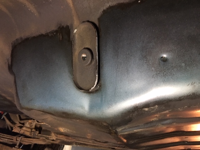

Continuing with cleaning the floors...one section at a time. Slow and tedious work but is going to look so much better once its all done. Definitely worth the effort.

Your floors are looking great Graeme! Cleaning them is slow, tedious, but very rewarding work. I'm curious on your comment about blue paint transfer from the fuel line clip. Clean the frame rail around the clip, I suspect you will find the same bluish hue from a combination of gray primer and LB overspray. That's what I found in that area on my car. Here's a couple of pics from mine that show the floors after cleaning. One pic is where the driveshaft loop was installed when the car was new. All of my clips had the tang engaged in the frame hole, none were folded over.

Those clips were off the rear inside frame rail and doubt any lemans blue paint would have gotten up there above the diff on the inside of the rails? I thought the blue paint traces on the frame was simply the blue from the clips maybe having transferred surfaces from any moisture that the car might have seen from early road use. In any case...it's all good.

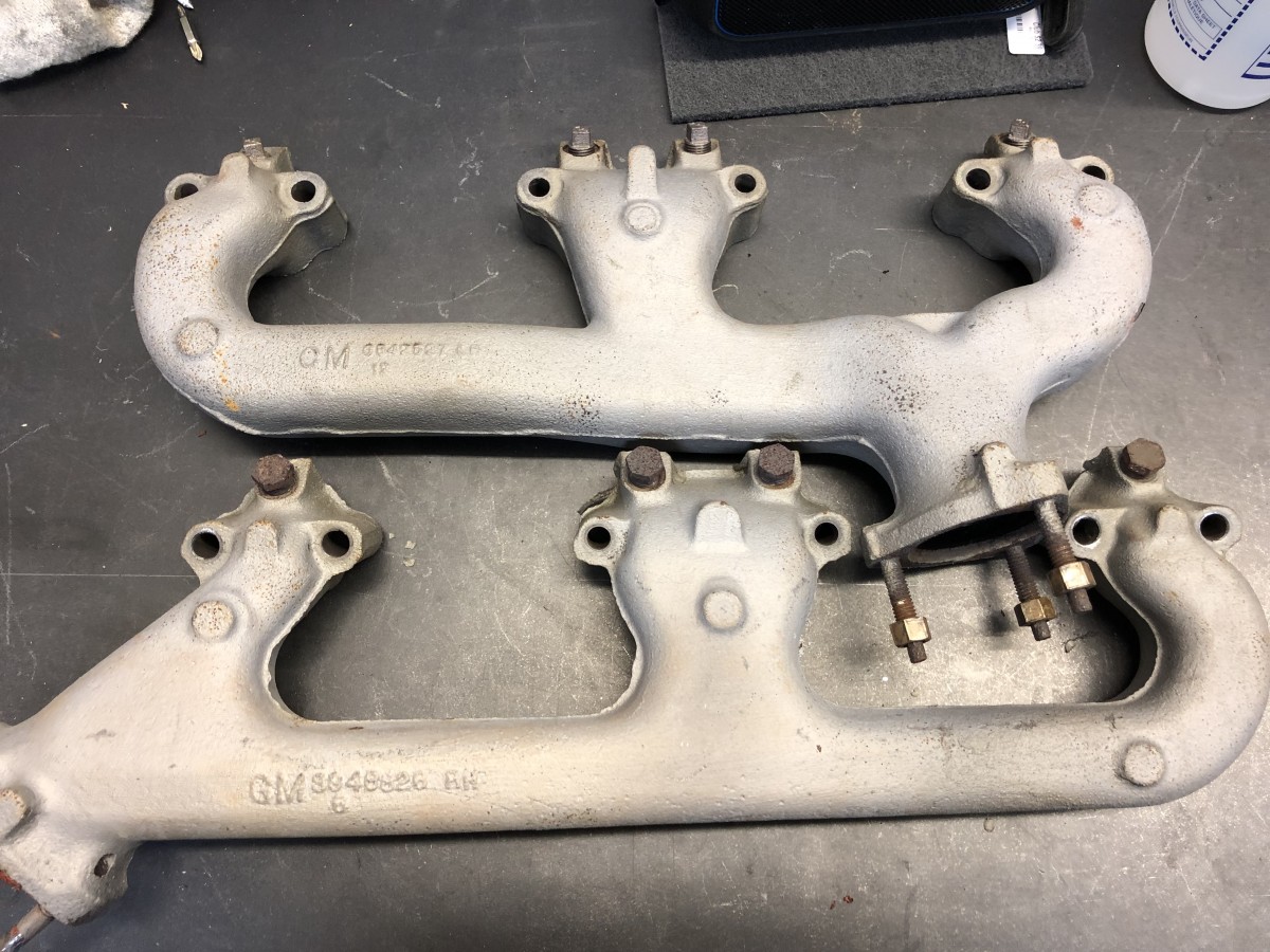

Just unhooked the shifter and pulled the manifolds for some refinishing. Now I'll pull the ignition and motor mount bolts and then it's all coming out. Depending on how accessible everything becomes, I may take it a step further later in the week and pull the front clip. I really want to do a thorough clean up on this car and don't like taking short cuts.
