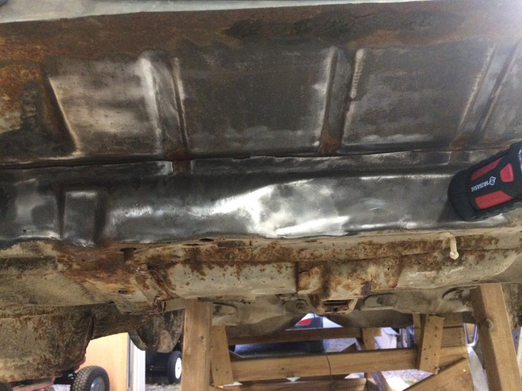

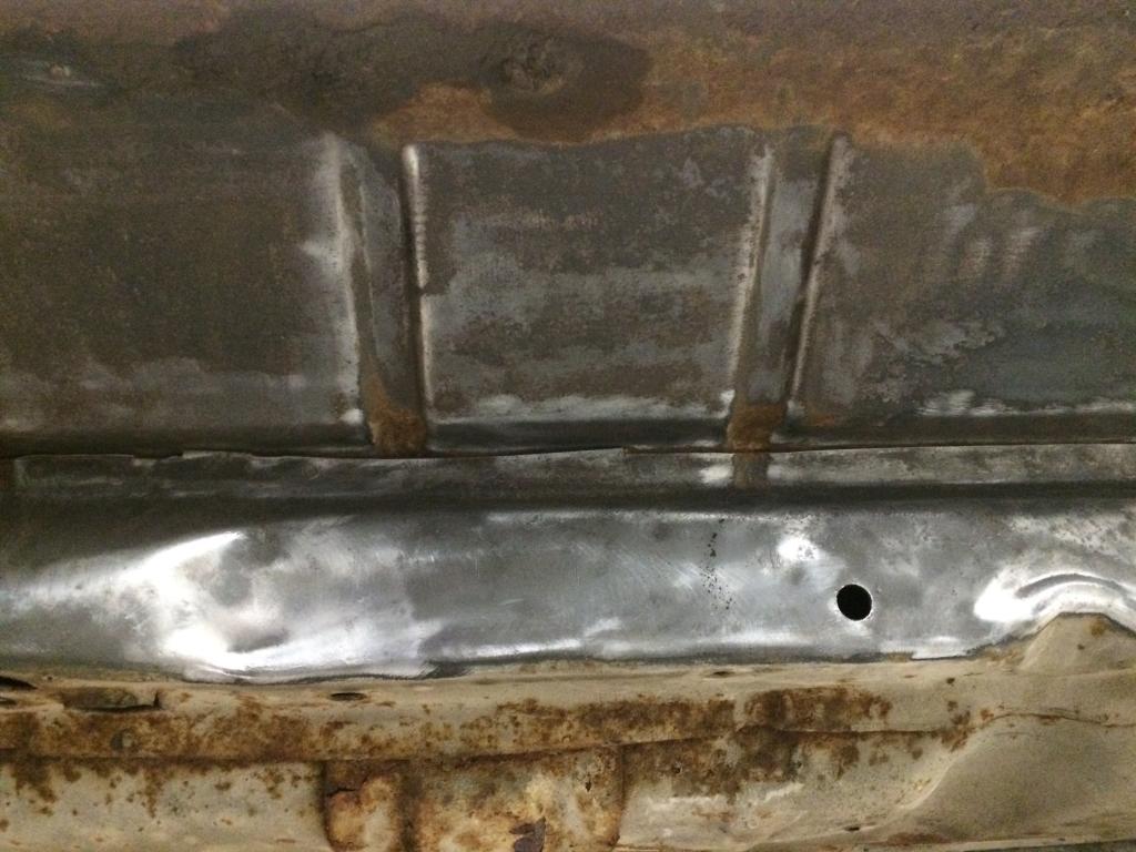

<div class="ubbcode-block"><div class="ubbcode-header">Originally Posted By: Rixls6</div><div class="ubbcode-body">Metal looks pretty good after the clean up. </div></div>
So far so good:-)
I flipped over the condition of the floor pans:-)
Ryan
