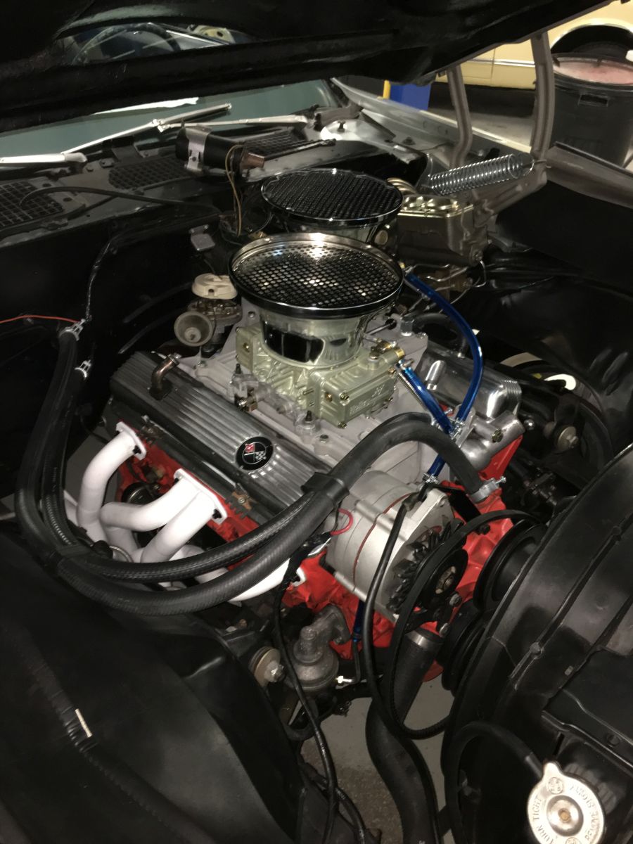

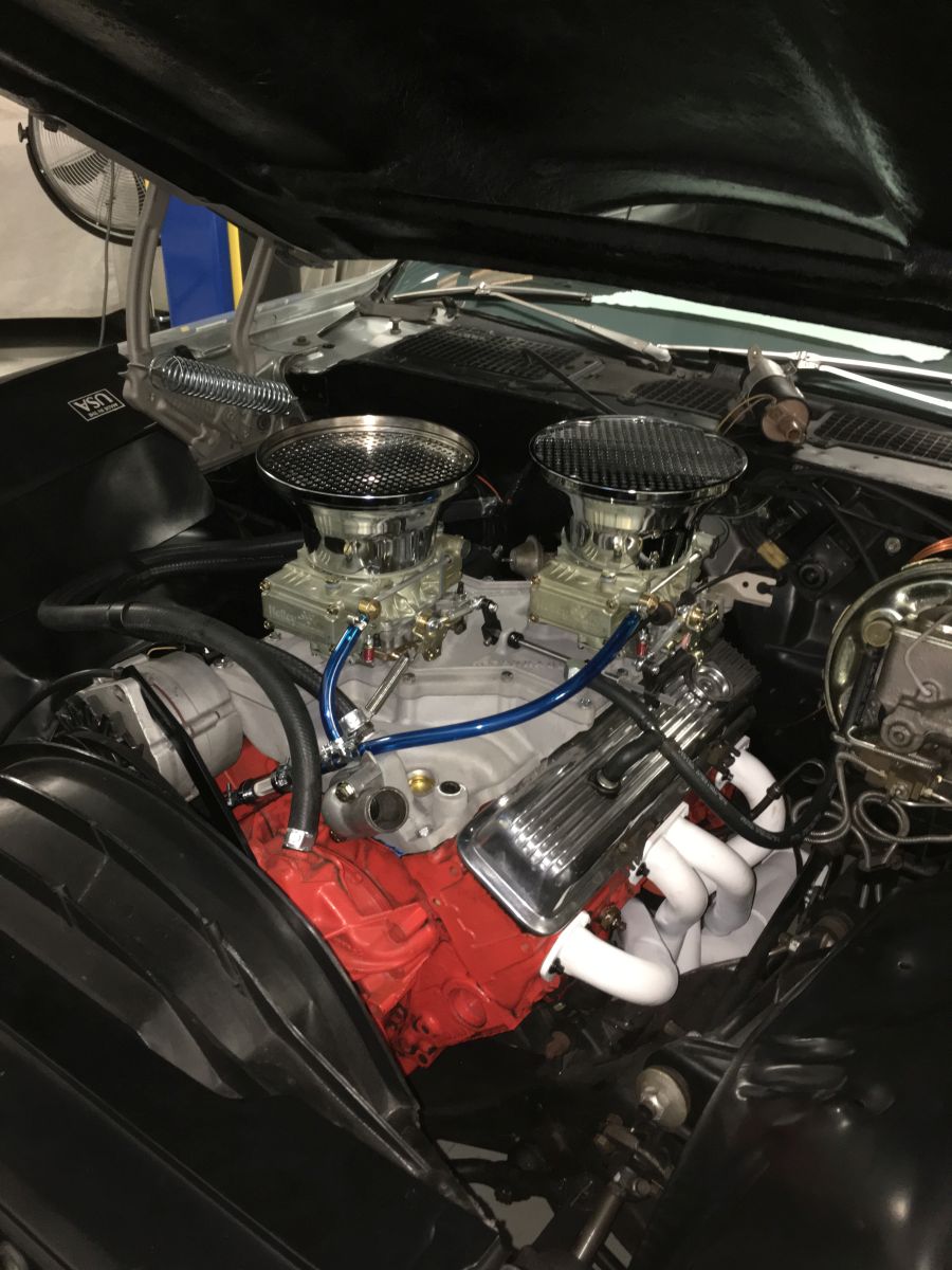

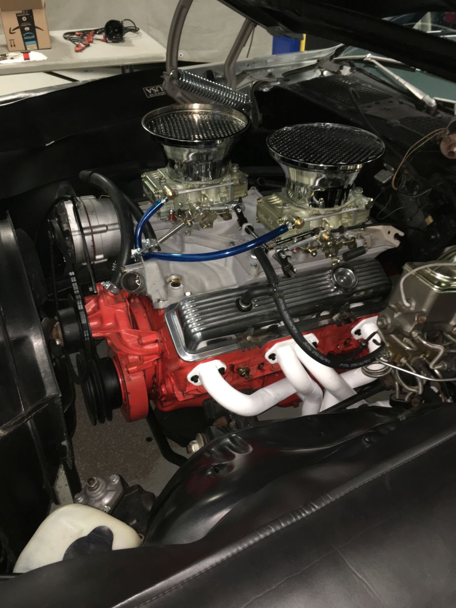

A little more progress, PCV lines run, headers bolted on, fuel lines run, cross ram bolted down, starter and alternator wire and back on.

Does all that happy fit under the L88 hood?

Ryan, it does, I was surprised that it did. The hood closes and latches no problem. With a big smile,

Looking sharp. Can the P Brakes share the manifold vacuum with the driver's side VC without compromise to braking? Or does the PCV valve at the VC address that? I don't know - just asking.

Sam, I believe they can, I looked back on a bunch of pictures of crossrams and they were teed or coupled in some way. I guess time will tell for sure

There probably isn't going to be much vacuum from that engine anyway. I'm sure that the cam is large. The brake booster may not work well even without the T.
