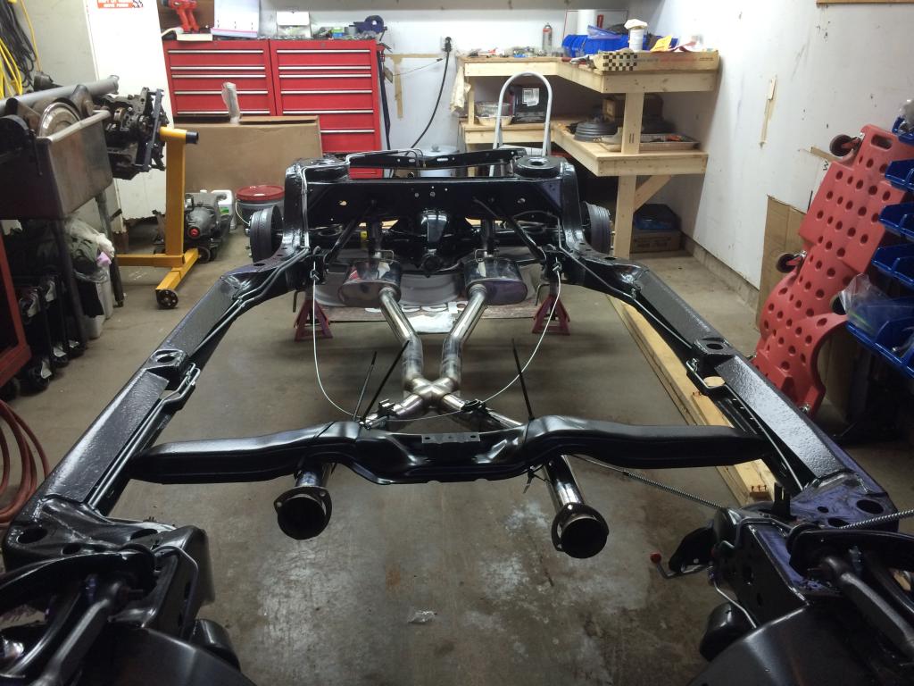

Great chassis shot Ryan also LOVE the X-pipe!
Are you sending update pics to Al too or does he check in on this thread here?
