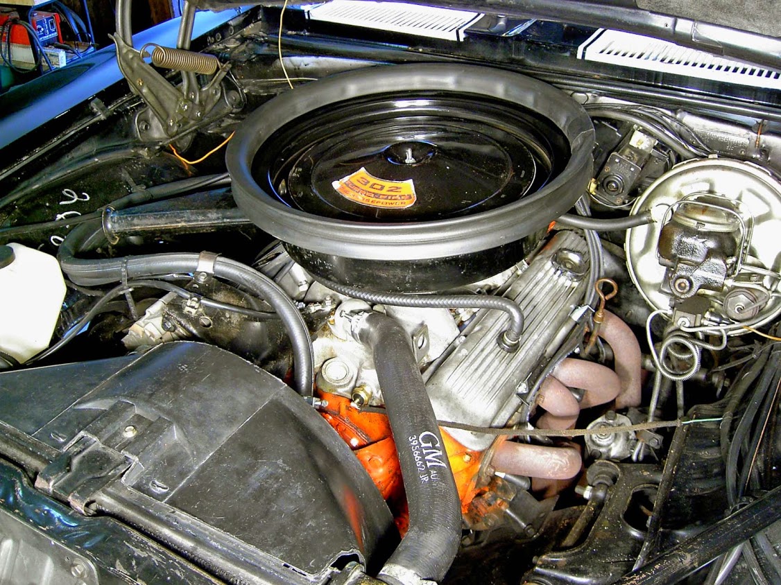

Thats the cover that was on it... it was dated 12 - ?? the last numbers were not stamped deep enough to make out... I assumed it was correct because of the 12 date.
I have not seen that cover on any other73s? looks like a 1969 cover.

Was the timing tab attached to the original cover or was it separate and bolted on?

The timing cover timing tab is spot welded on.

MY brother will have to live with the points deduction. I have put hundreds of uncompensated hours into research for his car and have tried over and over to get him to chase correct parts, he would rather put hundreds of hours into chasing BAMBI.

I doubt it will be a points deduction.

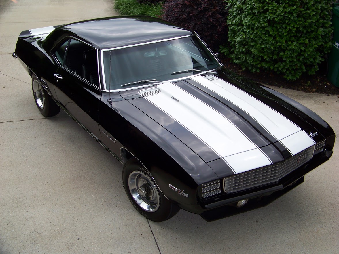

The Black RS/Z survivor which we drove the hell out of... took it to the Camaro Nats in 2007 or 2008 and had it judged in Vintage Certification... I never really cared for 69's until an original paint Black RS Z with cowl and endura came along...
