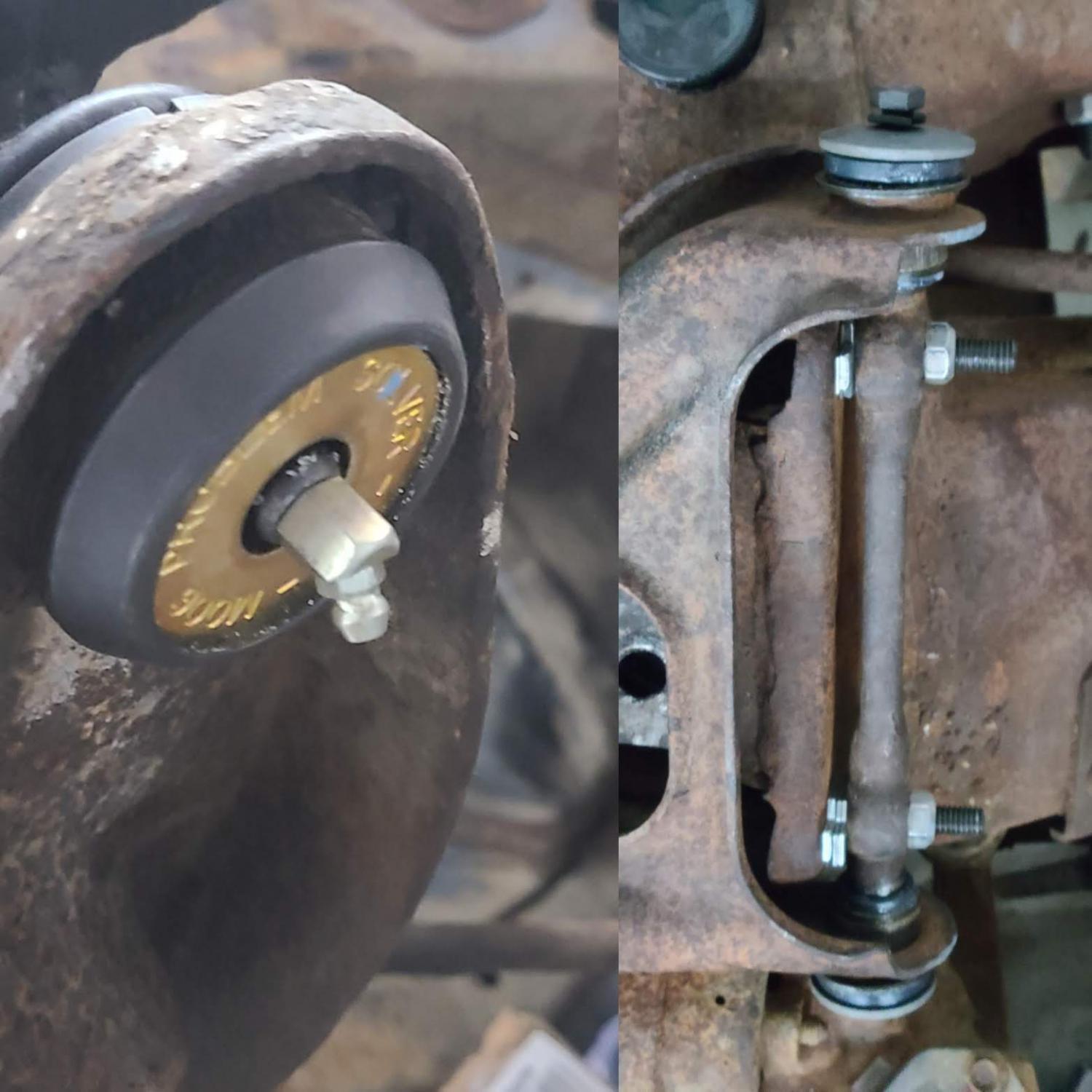

New control arm bushings, moog ball joints, moog coil spring, and amk hardware. I also installed factory disc brake spindles. This car will be driven often. I'll take better photos of the process when I do the other side.
As mentioned before, my immediate goal is to get the car safely on the road as soon as possible while preserving it's "as found" character. Parts for a correct restoration are being collected in the meantime and all take off parts including original hardware are being bagged and tagged for restoration.
I will admit I cheated in that I have some factory Kent Moore tools and a electric hydraulic shop press which made the job much easier. Having a factory service / overhaul manual makes it even easier.

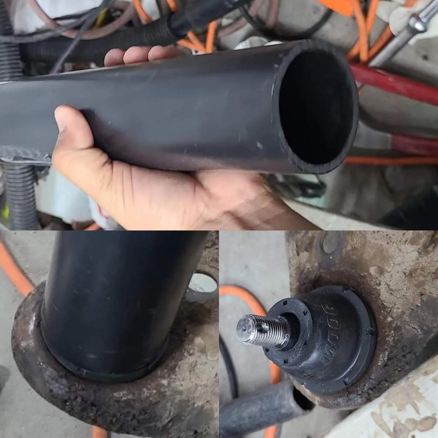

Trick to install lower ball joint boot: I bought a 2" abs plastic pipe. And simply used a rubber mallet went on easy peazy.
If using the hook style coil spring compressor the trick to getting the hooks out is to remove through bottom shock mount hole. Let one side out, and the other side will be stuck between coils. Simply use a big pry bar, open up the spacing between said coils just enough to free up the other hook and push out the bottom.
I removed the factory riveted ball joint from the upper control arm by first drilling a small crater in the center of each end of the rivet followed by hitting each one with an air chisel. Once each head of the rivet was removed I swapped the chisel for a tapered punch and knocked them all out.

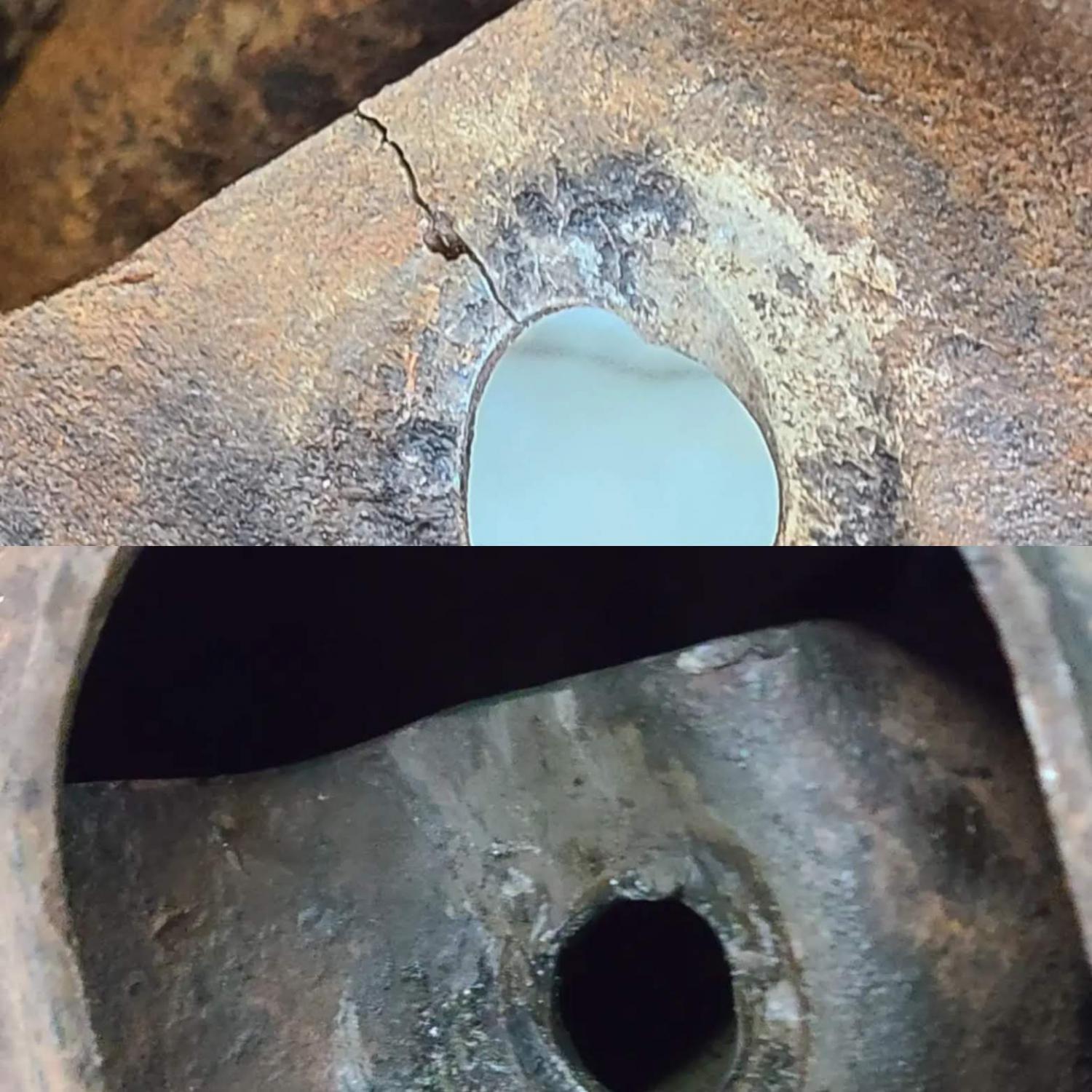

There was a small crack on the frame where the upper shock mount is but I simply drilled it and hit it with the mig and ground it down. It passed the strength test after using the coil spring compressor. No flex and no cracking.
The original ball joints were toast and the shock cushions were toast which is why I believe the frame cracked in that spot.

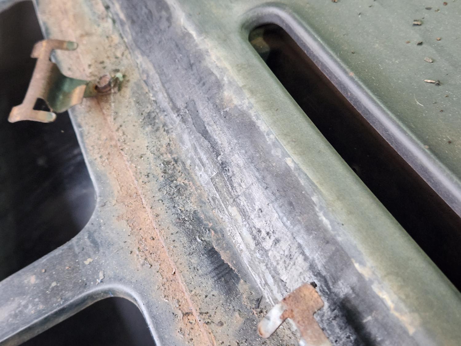

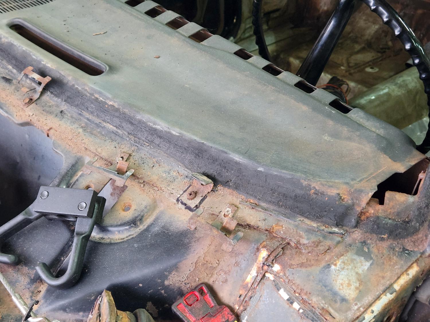

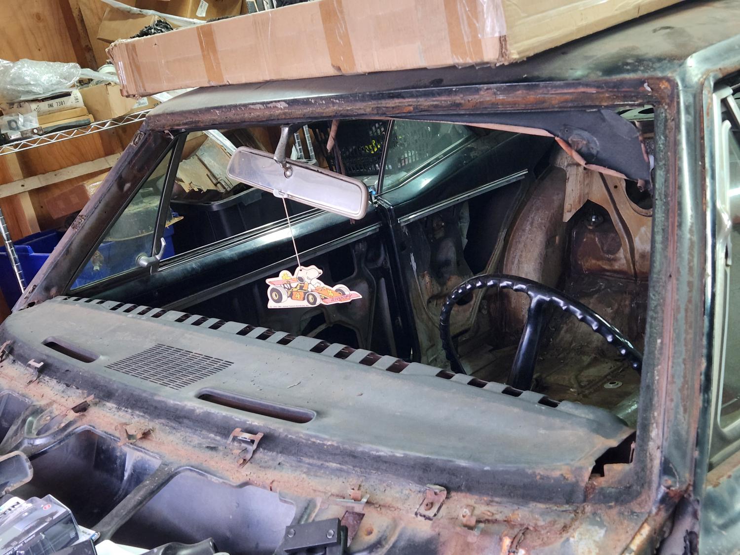

Life has been busy but I managed to remove the cracked windshield. I'm pleasantly surprised at the level of rust.
Next goal is to tackle the headliner.

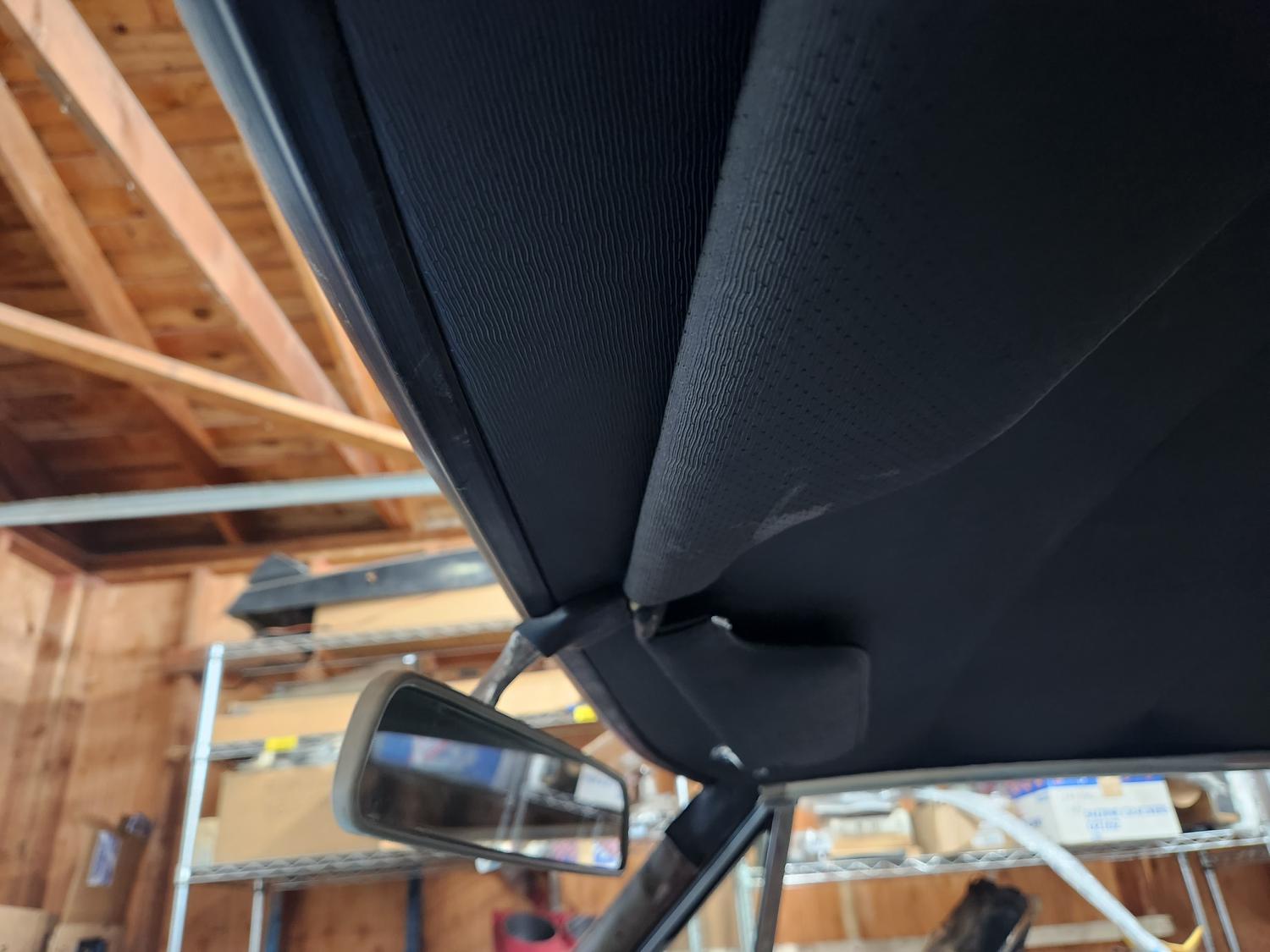

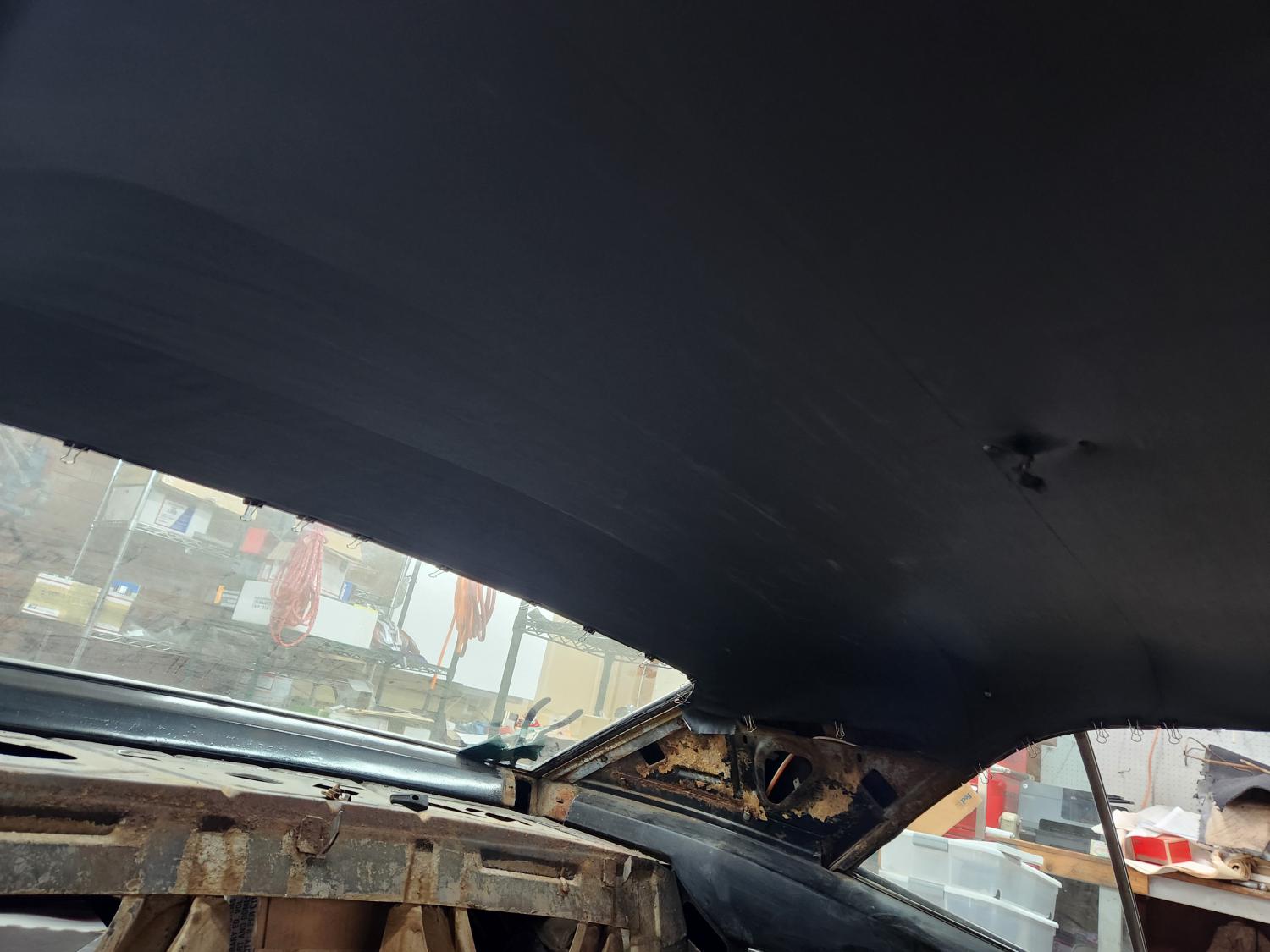

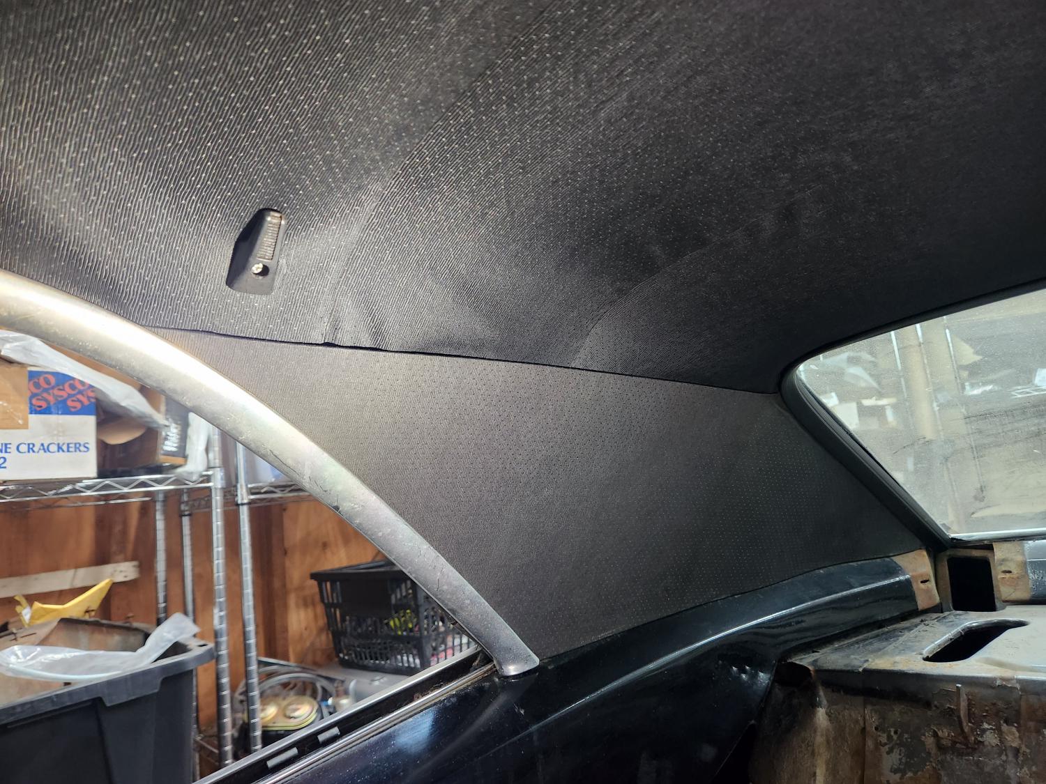

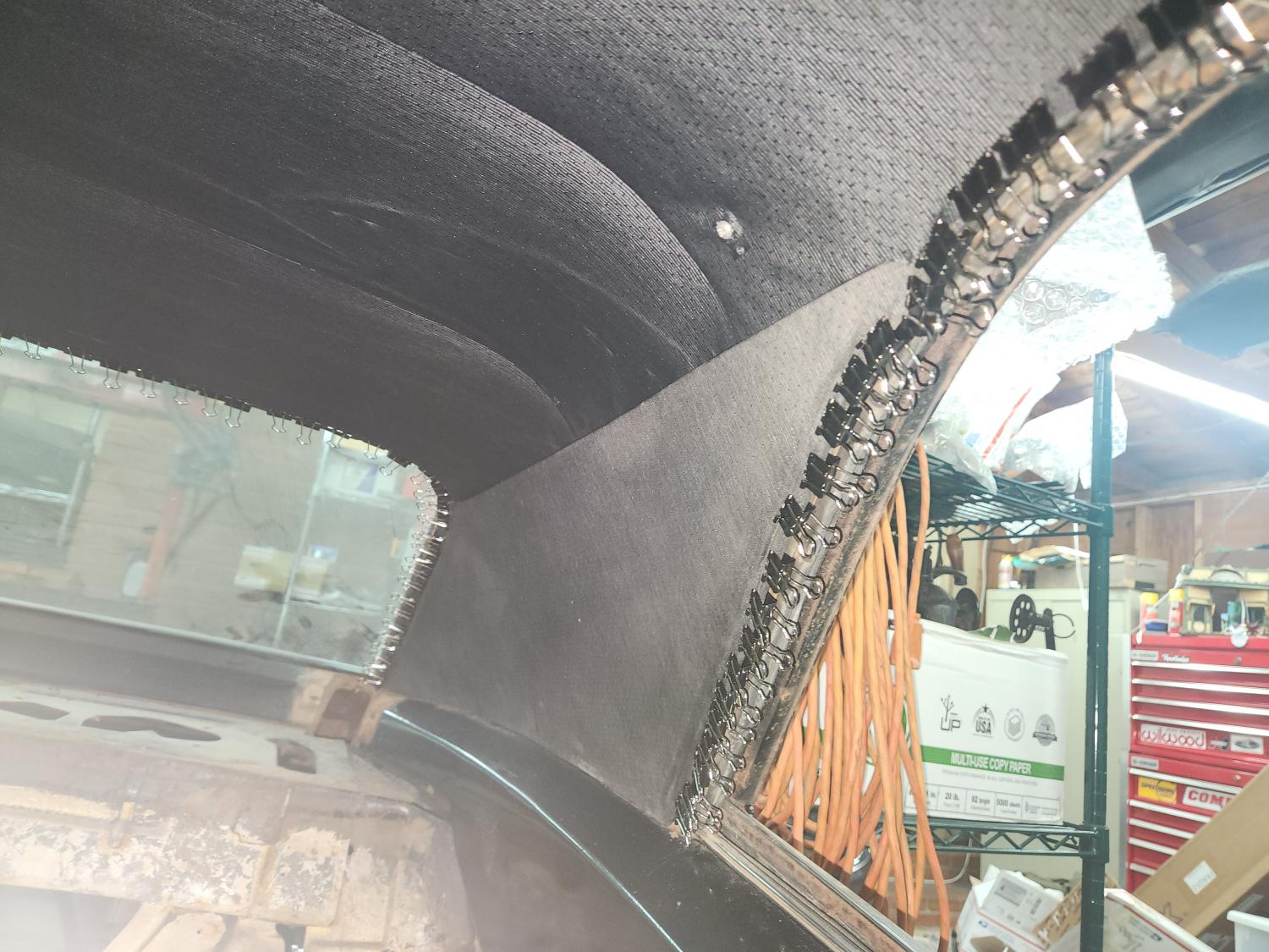

I've managed to get the used headliner fitted and it will be glued in within the next couple days. I'm content with the fitment as it is my first time installing a headliner.
Some of the tips that helped me most was:
Pre-installing all screws before installing the headliner
Fitting the front center and rear center of the headliner first
Pulling the sides of the headliner AT the bows, not between

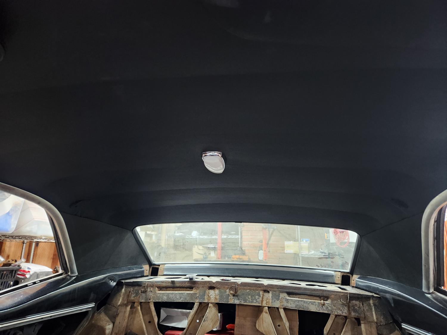

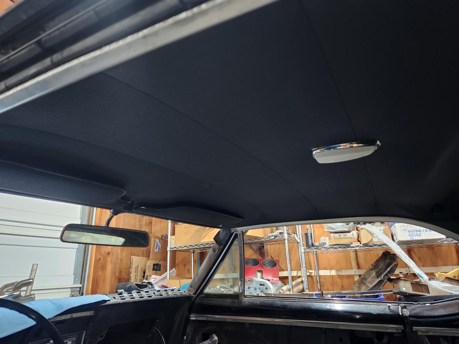

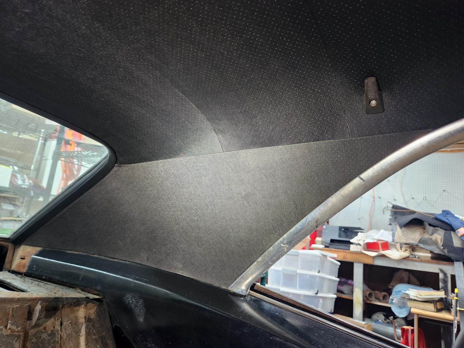

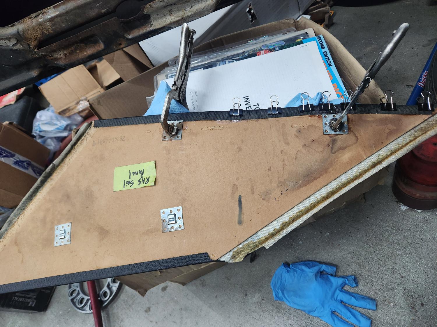

Headliner installation complete! I don't think I did too bad considering it was my first time. I made a repair to one of the original GM sail panels but it worked.
To install the rear glass trim I used a small rubber mallet and placed a small paper towel between the rear glass and mallet, sliding the mallet against the glass carefully bumping the trim into place.
