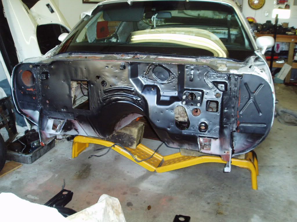

I finished the prep on the firewall last week and painted it over the weekend. I used the mask and spray bomb technique with Rustoleum Satin Black, which as you can see is pretty darn close to the original black on the outer cowl areas. I masked off the original paint on the outer cowl areas and just painted the center panel, keeping it within the original lower overspray line.

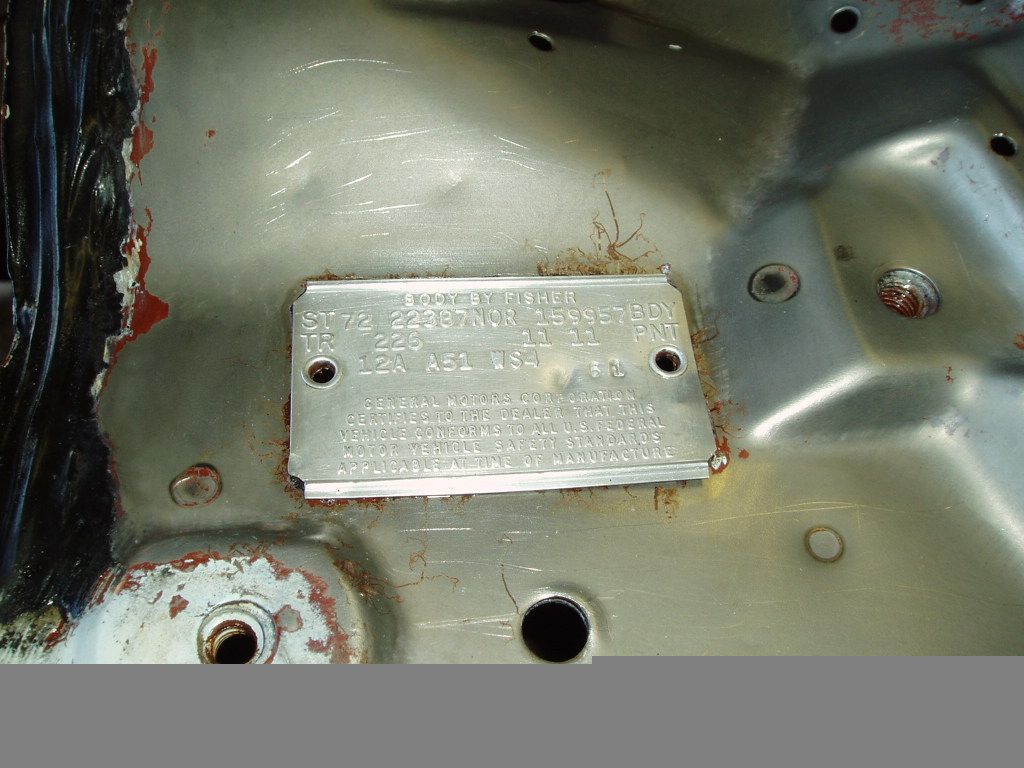

Default Re: Spray Day

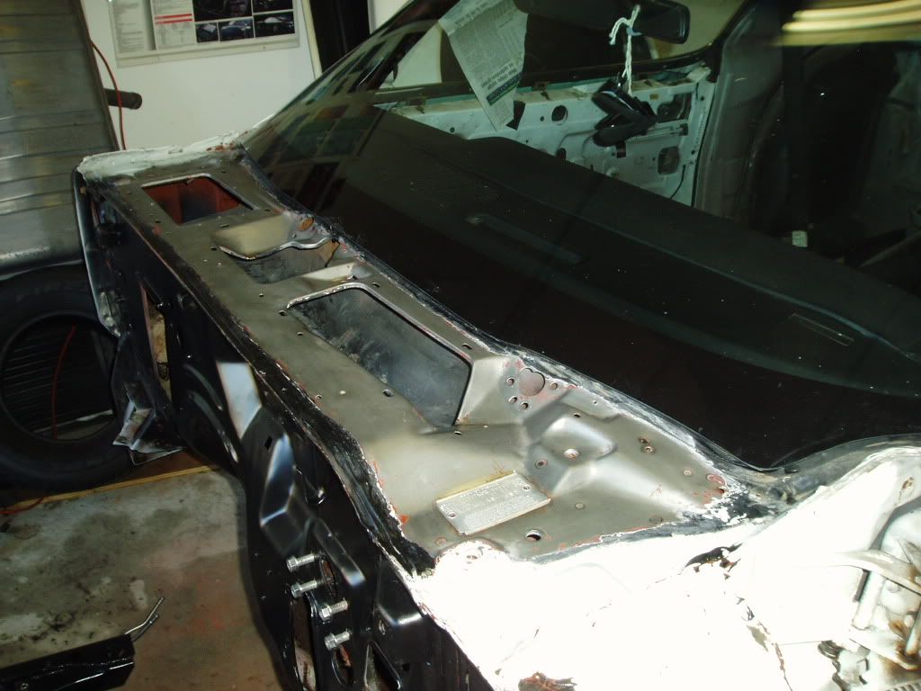

Today I stripped the upper cowl area. It had several layers of fisheyed glossy black paint on it, so it had to go. I masked off the original caulking and used chemical stripper very sparingly. I then washed it all down with water followed by mineral spirits. The metal is surpisingly nice underneath. Once I get the cowl done I will finally be getting close to reattaching the subframe and drivetrain to the body.

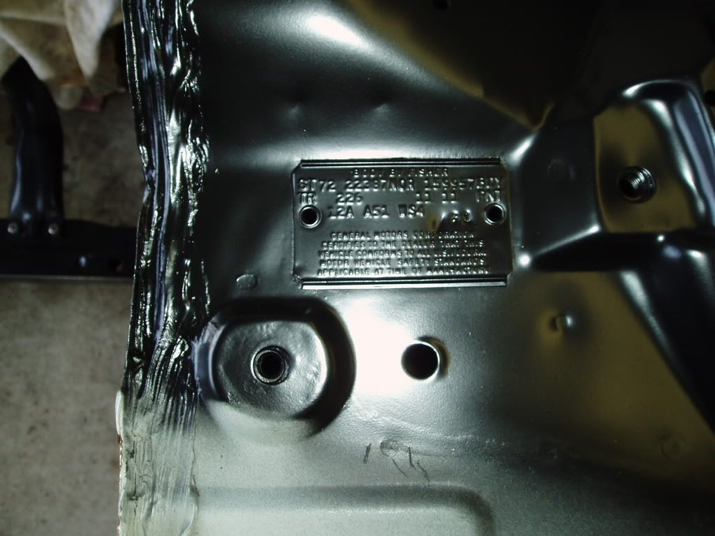

Here's the cowl tag area. Original rivets are intact. There was a small plug of caulking in both rivet holes. I removed it so it wouldn't retain any of the chemical stripper. I used an old toothbrush once the stripper did its work: no wire bristle brushes here, didn't want to damage the soft metal tag.

I have the firewall and cowl top completely painted now. I followed the original overspray lines on the cowl edge:
