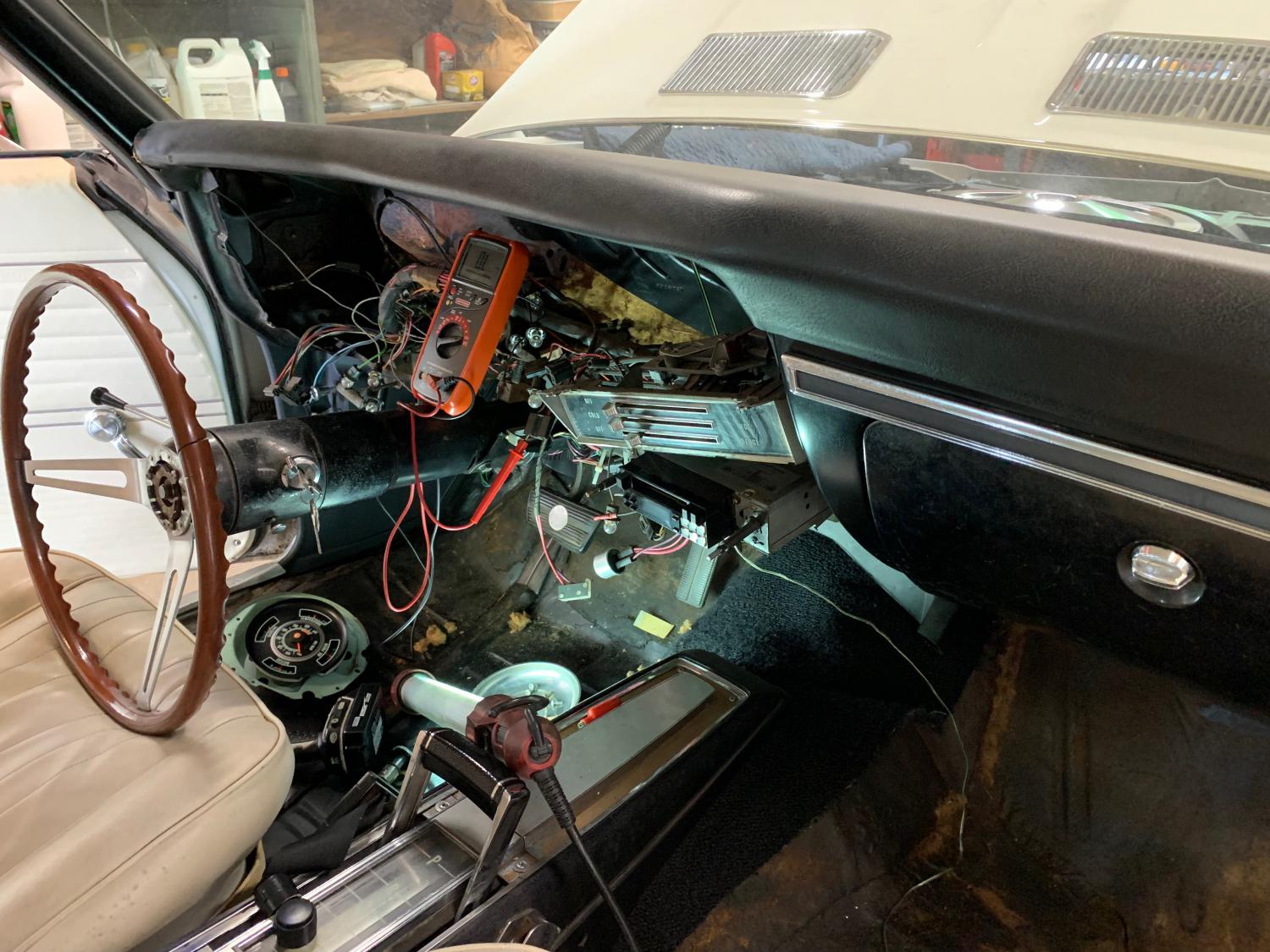

Good News ... the retired mechanic who lives down the street called me yesterday and said bring the car on down. I stayed and helped him and he is already finding several things I would have never found --- like the new front parking light assemblies had the wiring installed in them backwards .... making the bright side of the 1157 bulb burn when the parking lights were turned on, and the flasher side of the bulb burn dim or normal when the turn signal was used, so you could even see the bulb was flashing -- hope that makes sense.

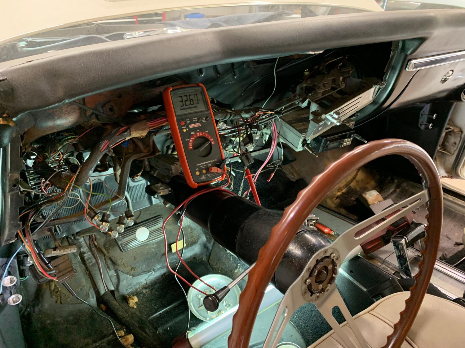

How it started and how it's going .....

Hopefully after this all the gauges and everything else will work ... as I am having a new gauge cluster put in as most of the old gauges didn't work

Yep, you got yourself a spaghetti mess going there...
