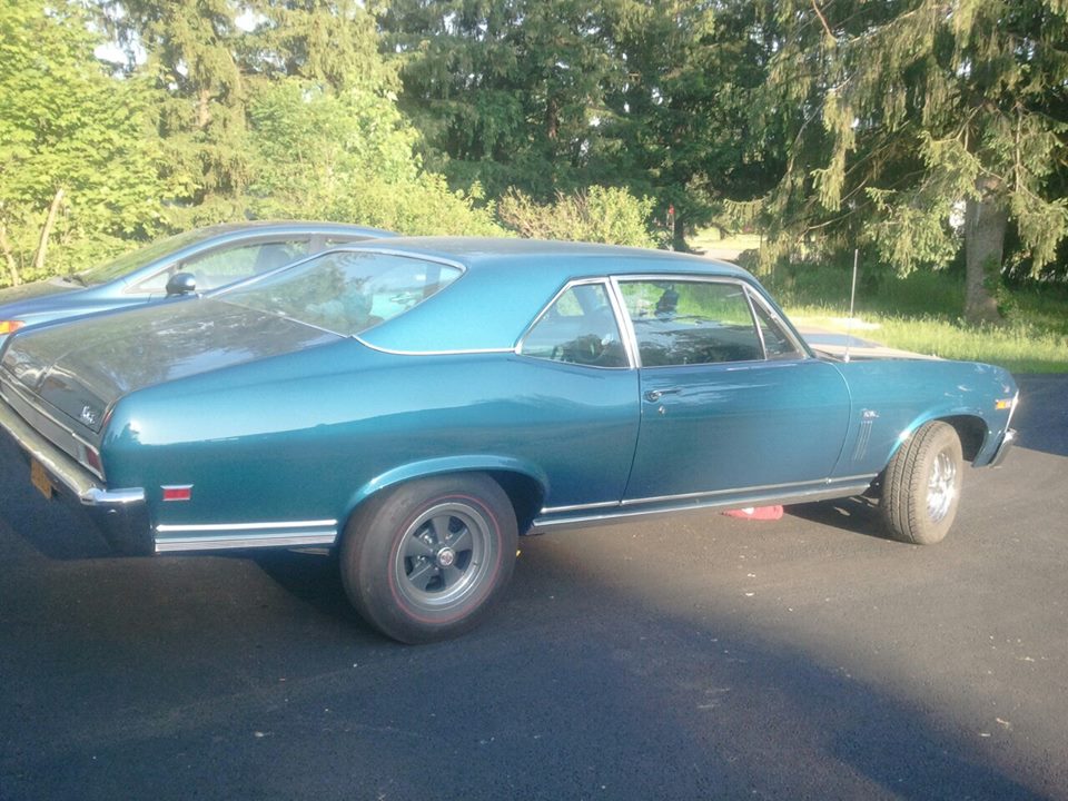

[img:center][/img]
This side hasn't had much media attention. All glass is in and the vent window frames are on along with the painted top moldings and corners.
