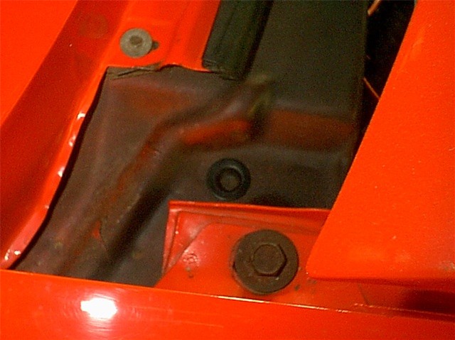

Here's a pic of my cowl through the cowl panel.

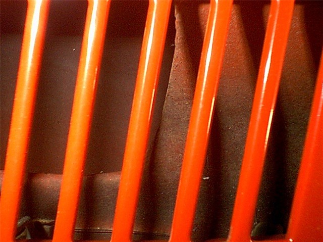

Here's another. m

For us Novice Nova fans,which is it?
Should the top of the Cowl Panel be painted body color,or black,or both,meaning was it a time period/body style issue?

That's overspray, either black or orange whichever was painted first (still under debate), but no cars have their cowl painted body color. (Camaro's yes, oversprayed over the leading edge of the firewall - not a tapeline).
Mark's 5k mile orange nova has an unusual amount of body colored overspray on it, common on orange cars but uncommon on Novas in general.
Marlin

On three of my original paint cars the the body color was sprayed on first leaving overspray on the cowl and the black shot over the top, with some of the color beeding through. This topic has been debated, but I can only speak for my three cars. The painter stood in front of the cowl and shot what he could reach from there. One the backside of the humps and bumps the black would be thin or not there. m
