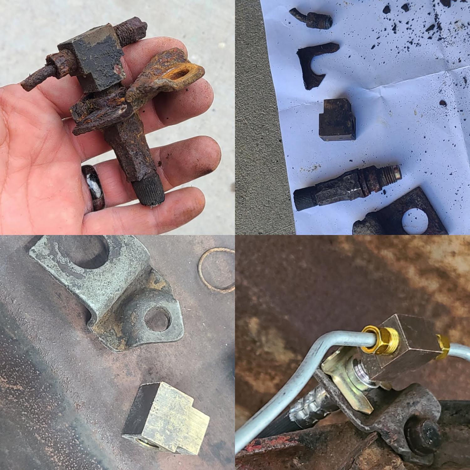

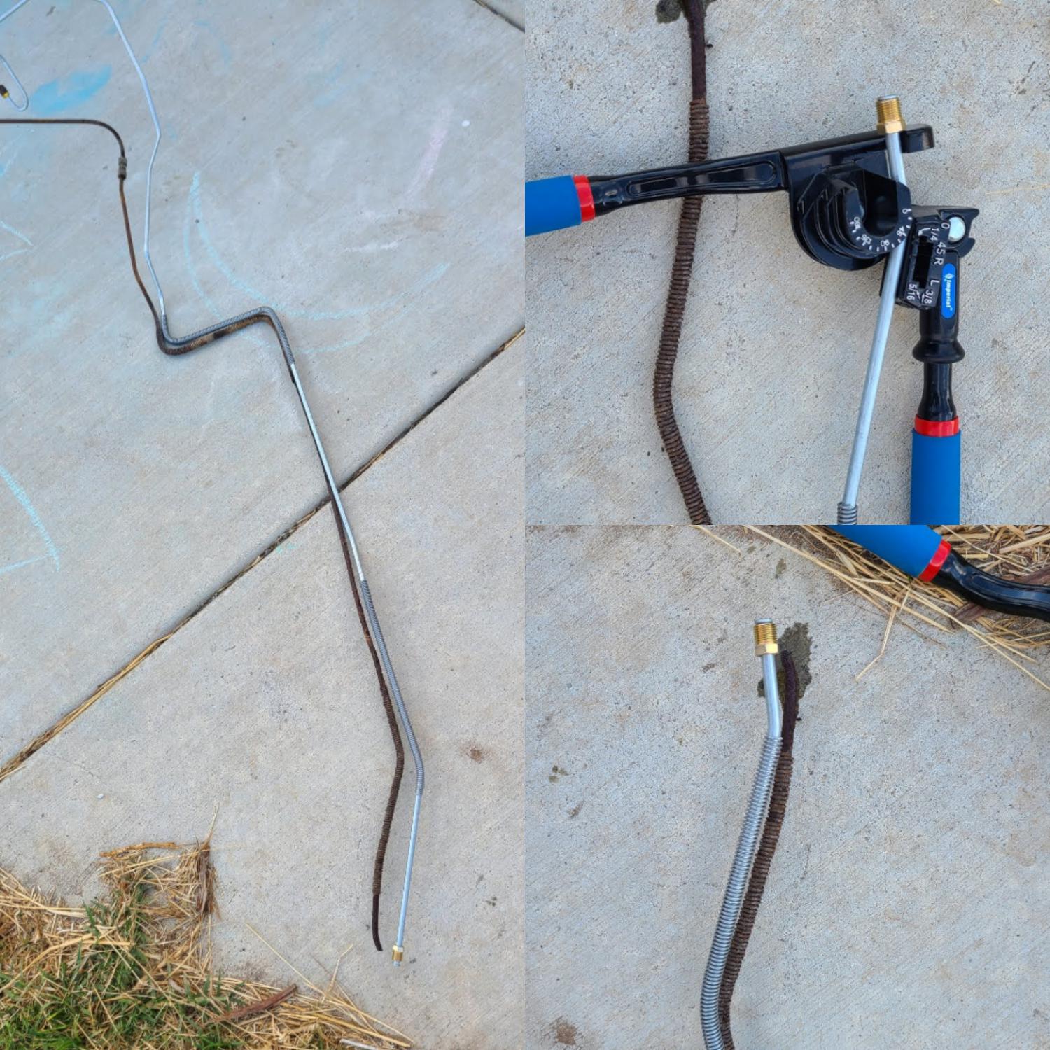

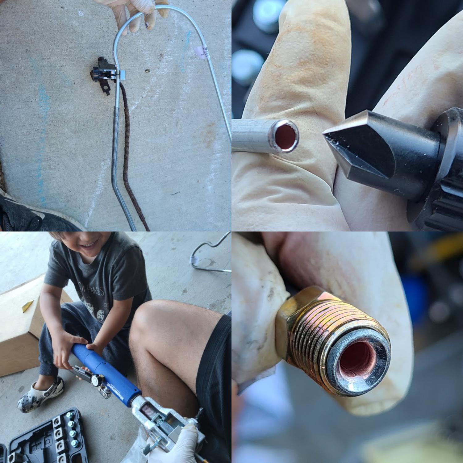

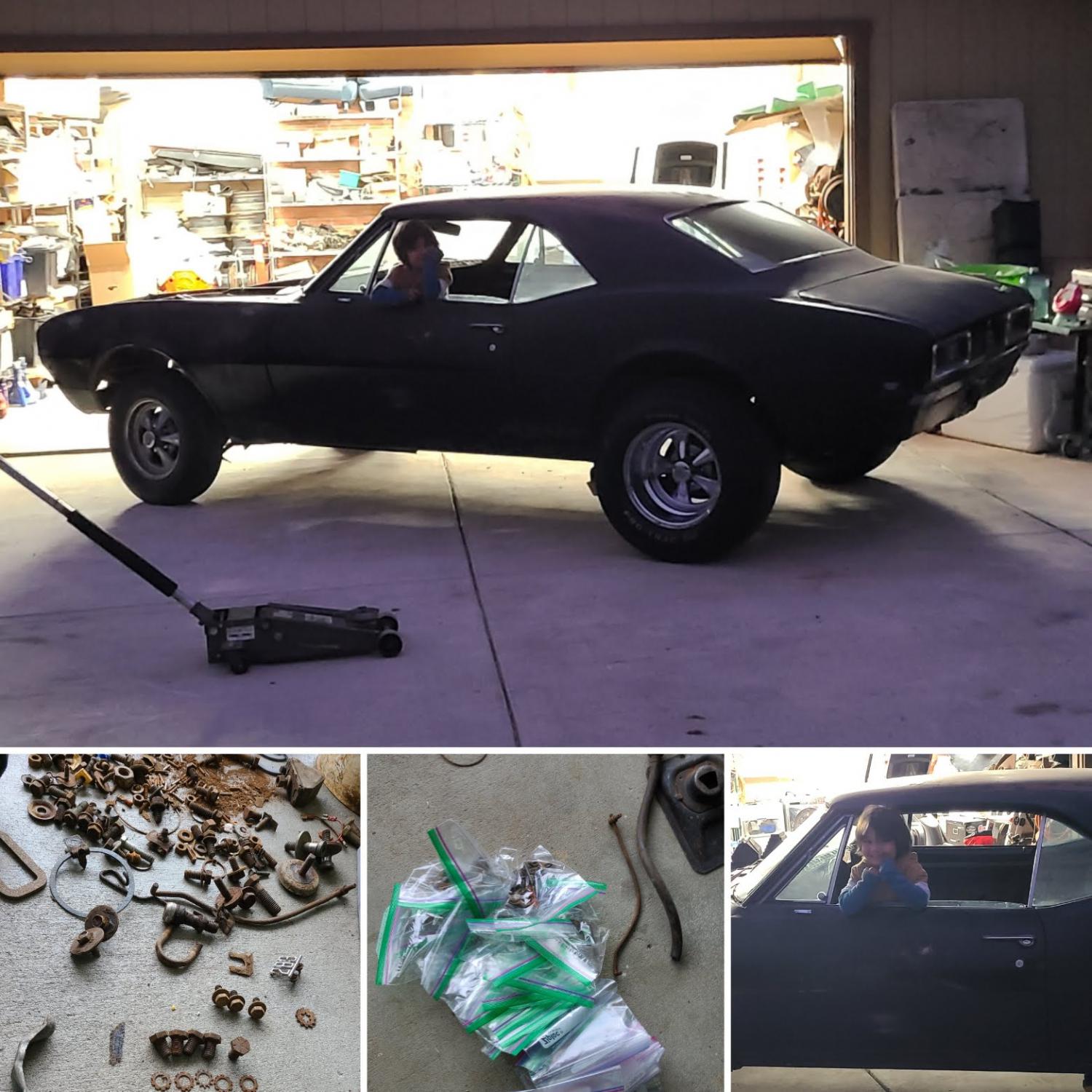

Sorted a bunch of hardware that came with the car. My favorite helper steered while I pushed to turn the car around to continue brake line work. We trimmed the new brake line to match the old and I'm more than satisfied with the fitment.

That 283 emblem is a SUPER rare part on a Camaro..
Aren't those hydraulic flaring tools the BEST ?? Seems a bit spendy at first, but once a person has used it, they are worth it for the ease and quality of the double flare.

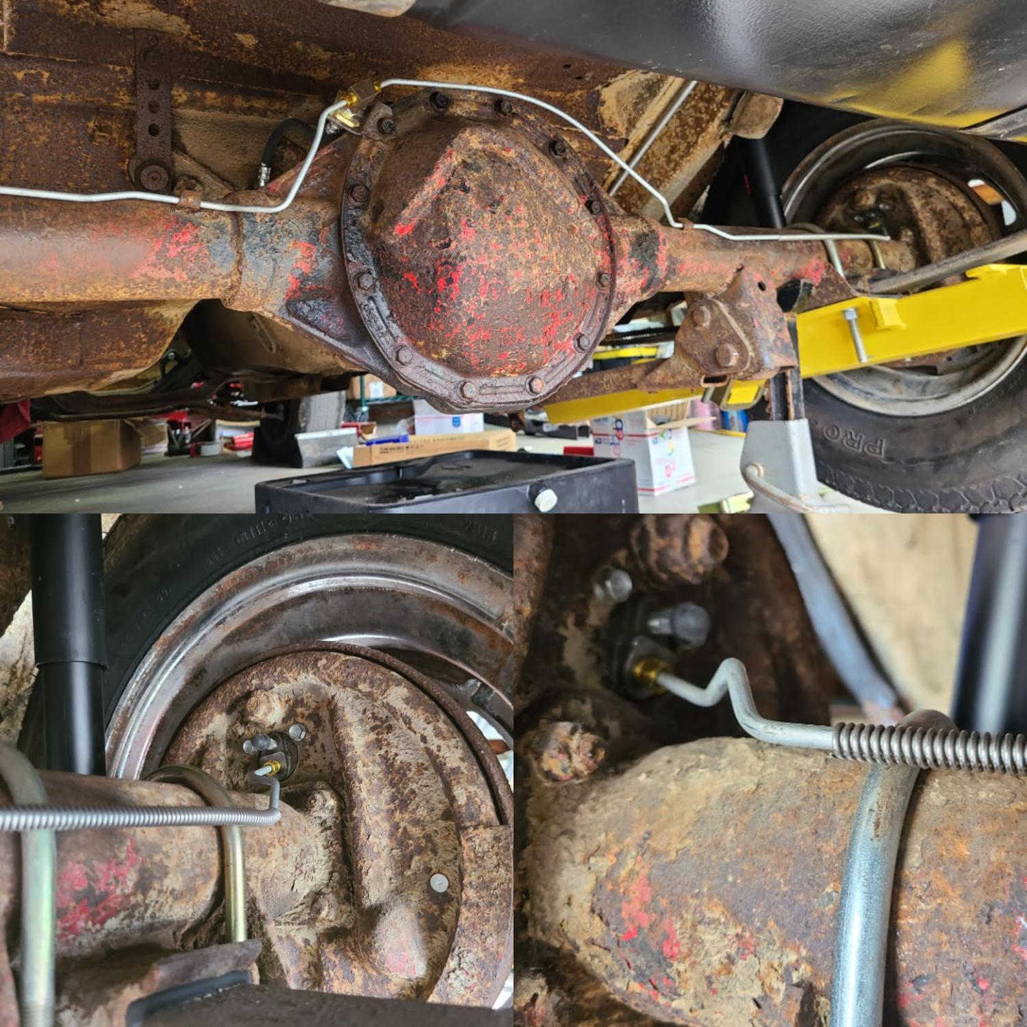

Didn't know that about the 283 emblem thanks =P. Btw the flaring tool is so much better than fighting my old finicky tool! Yes I like having special tools you'll see more of that soon.
Oh and before that I cleaned the original bracket and block and installed axle brake lines/hose.

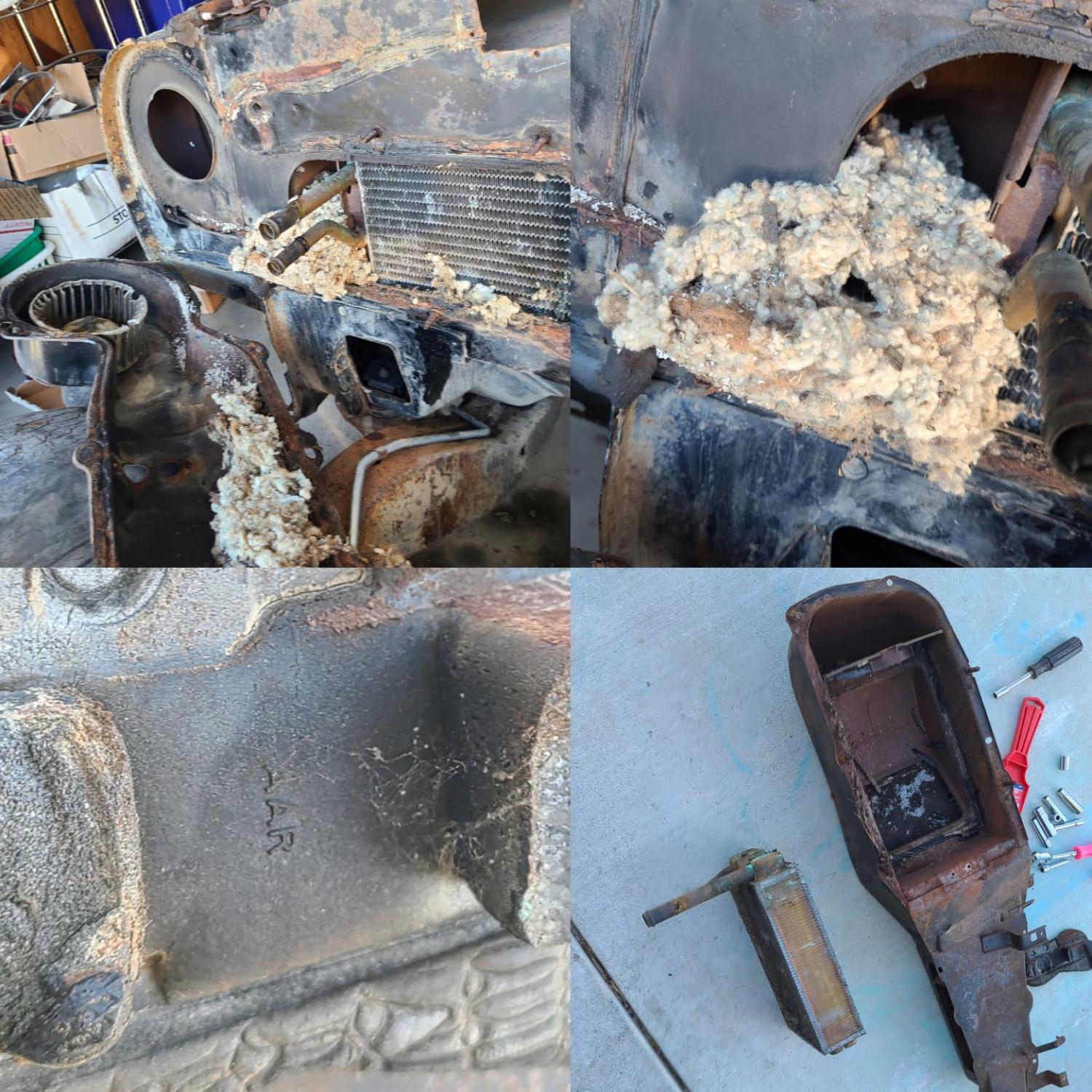

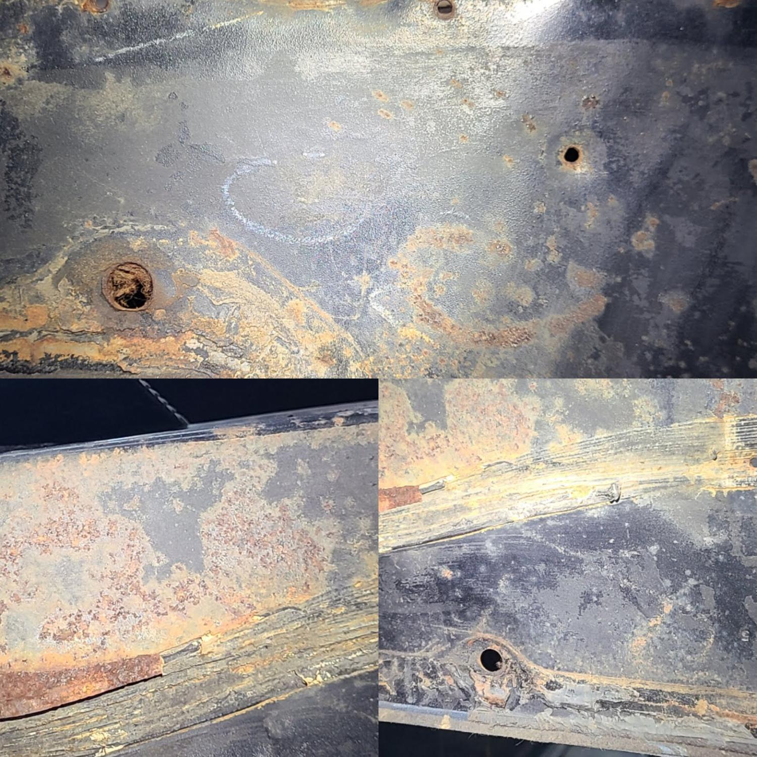

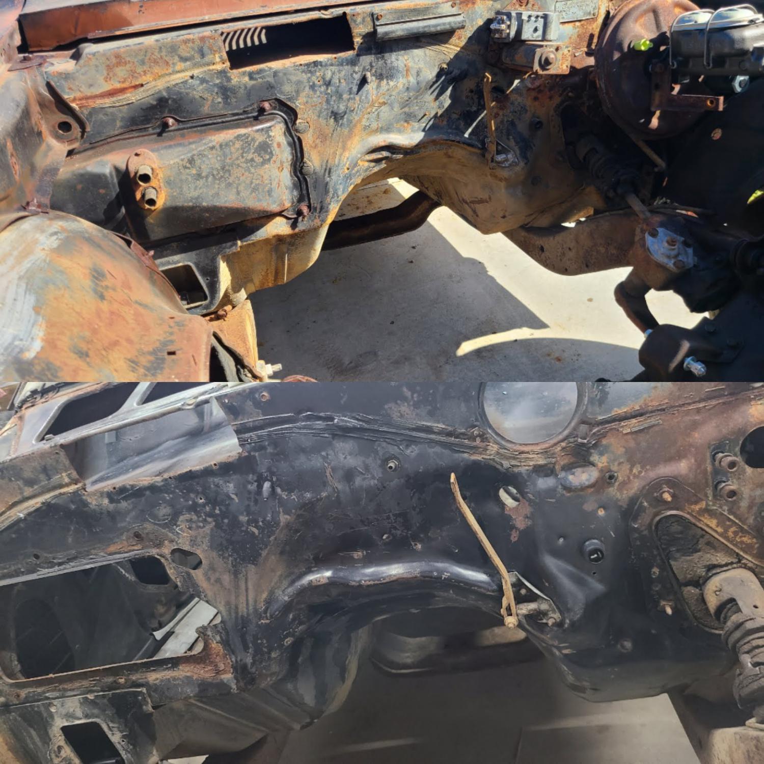

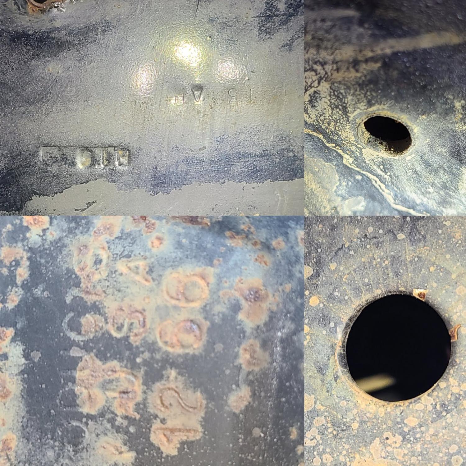

Basic disassembly and cleaning using dish soap and water.
I used a plastic scraper to remove the grime to reveal the ink stamps under the heater box followed by careful use of a razor.
I used a shop vac with a HEPA filter to remove the mouse condo. It looks like they were very cozy in there, complete with a stash of nuts.

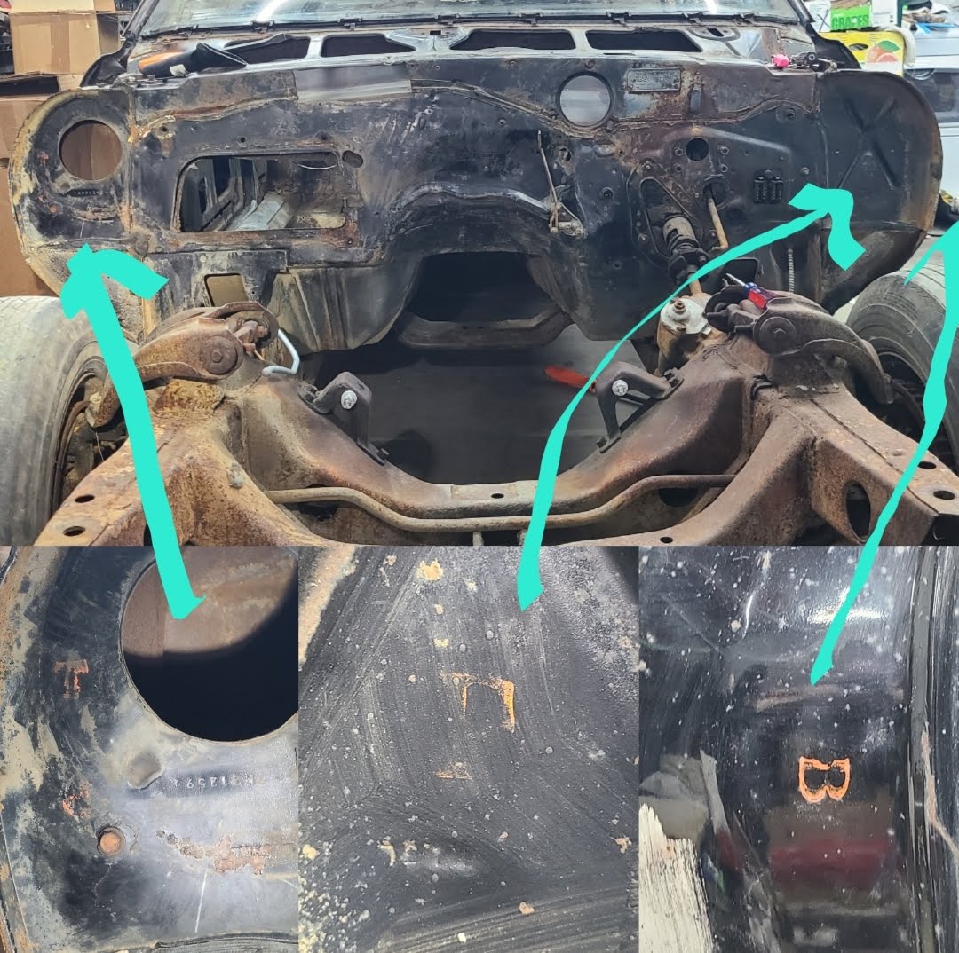

The ground strap hole near the framerail appears drilled but not tapped. I'm assuming this is because the car was ordered without a radio. And outline from where the antenna plug/grommet once was is still visible.
The grease pen markings are difficult to read but I keep seeing 8's
The white crayon appears to be 102? and beside it another 8 grease pen mark to the right.
