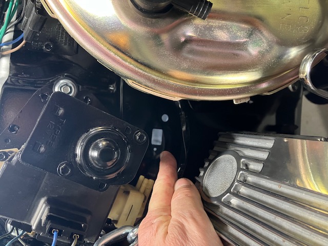

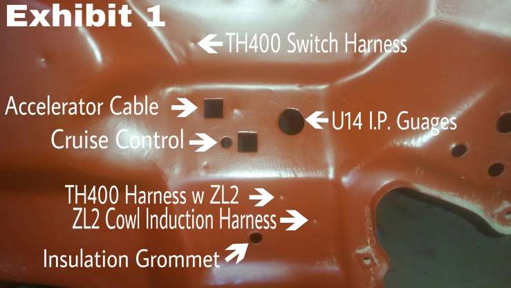

I will post this picture here, still trying to figure out this cut out in the firewall. It is under the wiper motor.

This is a picture of a 1970 Chevelle firewall with a similar hole showing it’s for cruise control….I assume it’s for Camaro too…..?

Thanks Kurt, this is cool but I really want to know what is correct for the 1969 Camaro.
I didn't think it would be this hard to find out what this cut out is for.

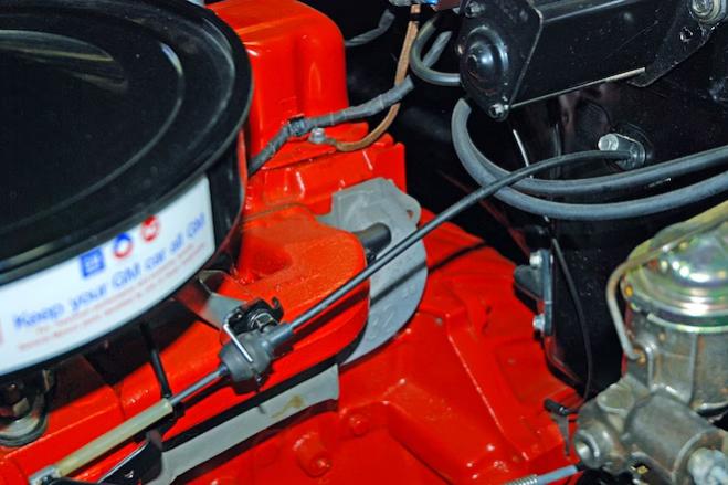

The cut out was used for 6 cylinder throttle cable i belieive, heres a pic off the net.

Marc's picture is correct. I believe Crossram cars used the same pedal assembly and cable assembly between the carbs as well.

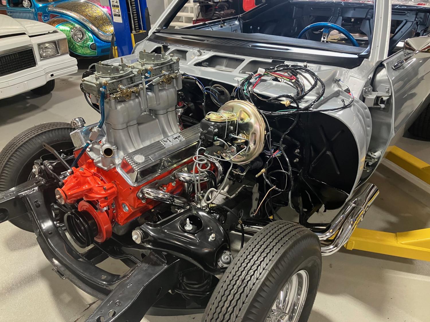

Hopefully into stay now.

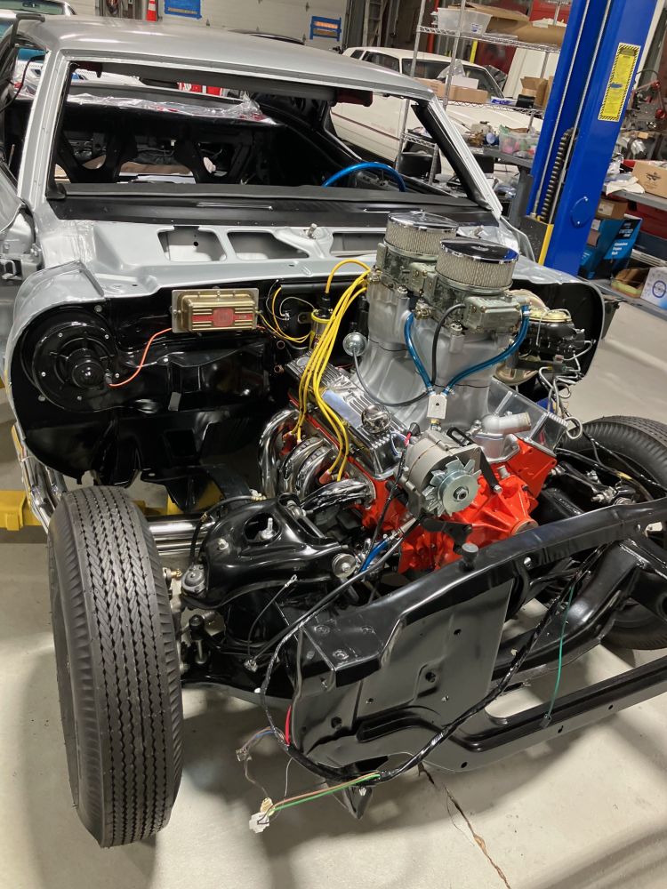

Some updates
