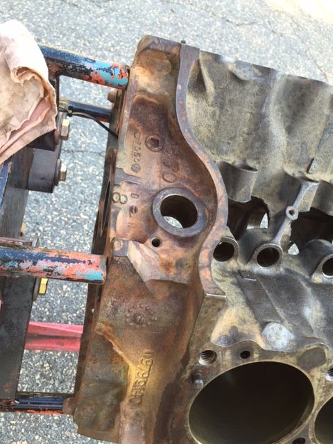

One of the guys over at PY just responded with this chart for selective fit pistons for 1970 and 1971 Pontiacs. Looks like I was right!

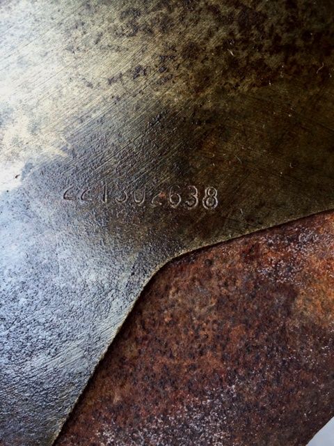

Visited Roger's Automotive again today to drop off a spare flexplate in case they need it for the balancing process. Gotta love that Safest Rust Remover/Evaporust stuff. Two hours of soaking cleaned up the rusty flywheel nicely. (I degreased it completely first).
