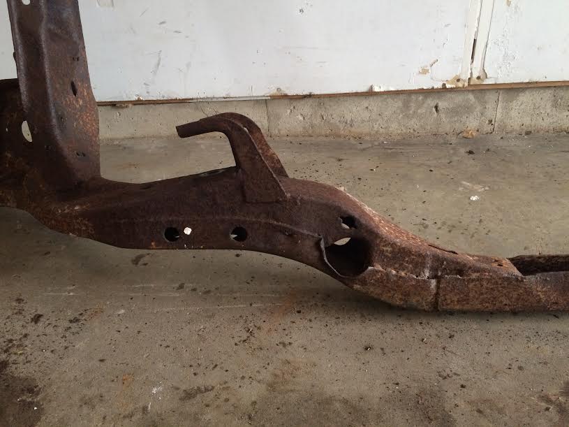

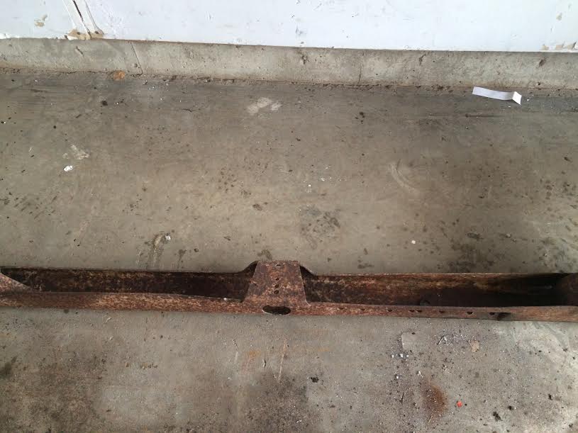

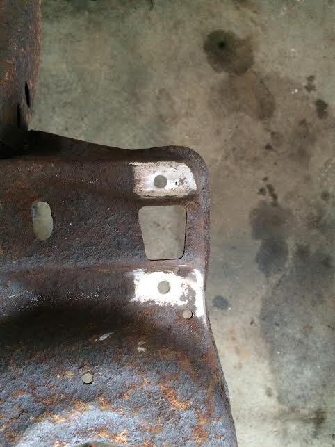

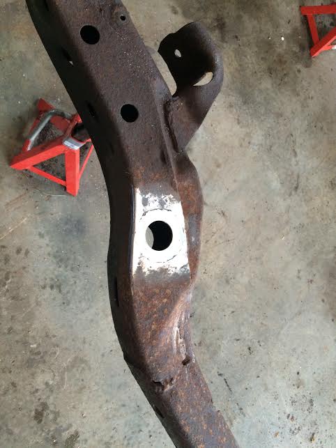

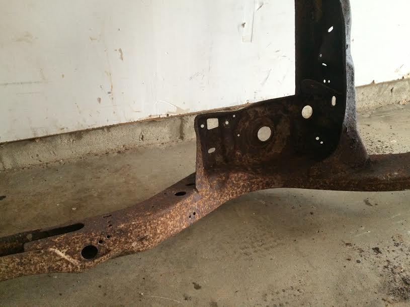

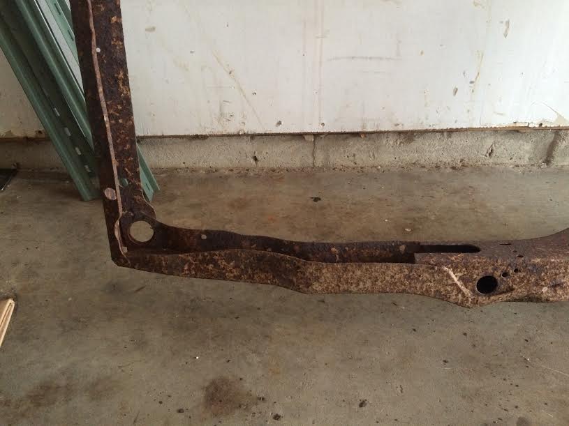

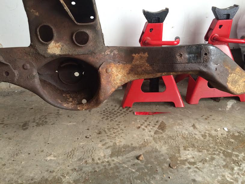

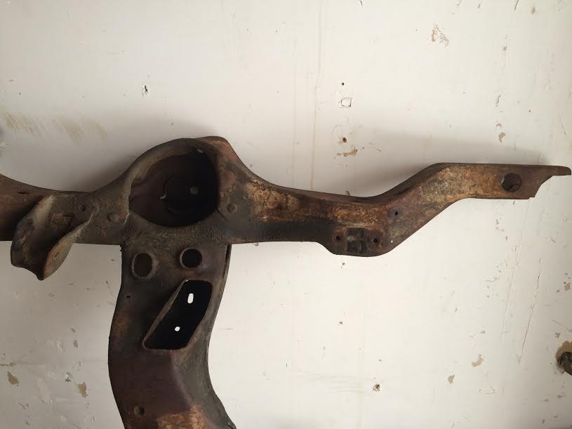

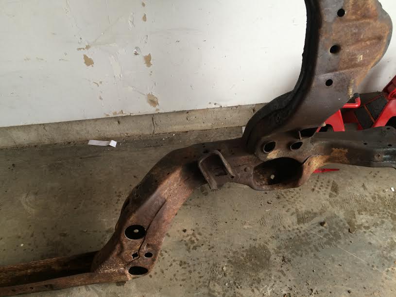

Spent some time preparing today so everything is ready to go to media blast after work Monday.
Had the girl out to pull out the jack stands so i could get the frame on the ground, amazed how light they are:-)
I used a flapper wheel to smooth the welded mounts, and finished the shock bolt hole repairs.
